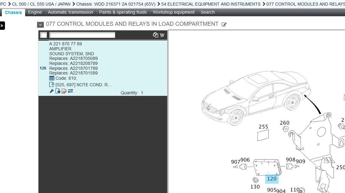

Are you searching for replacement by specific part # or simply model year/model ($1000) if the latter, provide VIN and I will pull compatible part #s to expand search. To answer your question, IMHO choose HK replacement.
Thanks, I will pull out the VIN next time I'm with the car, will be interesting to see what is considered compatible.
Thanks for the offer, I sent you a PM with my VIN, but feel free to post the results in the forum. Thanks

Here are compatible part #s.
File Type: pdf
Old Feb 21, 2020 | 12:19 PM
funkstar's Avatar
Joined: Feb 2020
Posts: 20
W216
Very kind of you, thank you.
