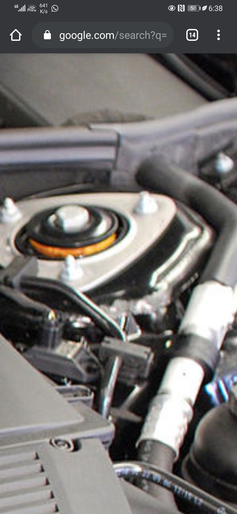

2007 S-65. The orange rubber busing on the top of my front struts is broken and crumbling. There are no ABC problems and the front struts are fine other than the deteriorated rubber.
I found some replacements online: https://www.aliexpress.com/item/32449087692.html
Anyone tried using these? I would rather not open the hydraulics up and replace the entire strut when for the most part it is working

The bushings I ordered got here. I only wanted to use the top part to replace the small crumbling top piece shown in the top video. I did not want to tear apart the whole strut and replace both the upper and lower donut.
The replacement is not exactly like the original. The original is one piece, not two pieces, like the replacement. I only wanted to replace the top so I actually used a hot knife and cut the top small donut off the one-piece bushing that was on there after I removed the black cover
The top bolt came off easily with an impact wrench. I only did one side. I have 1000 miles on it since and it is doing fine. I will probably do the other side later this summer

I only removed the one center top screw with an impact gun.
The original bushings are one piece and the replacements are two piece. I cut the top crumbling part of the original bushing and replaced it with the top piece that came with the new ones.
I did not replace the part underneath the mounting flange.

I had bad knocking sound on my front struts, so I purchased a new rubber hats and new lower joints from ali express they arrived within 7 days, you can find them on ebay as well.
Old Dec 20, 2020 | 05:16 PM
Salman s600's Avatar
Joined: Dec 2020
Posts: 10
2007 w221 s600
its two piece rubber the small one will fit on top of the hat and join under the hat with the secound piece rubber, just make sure to have a marker and put a mark before you remove to put it back as it was, and pay attention if you have abc lines you want the to line up the lines as it was before, easy DIY job guys dont hasetate to do it. took me about 30 min for each side. the hard part was making the small rubber to fit inside the top hat. other than that it was easy job.
