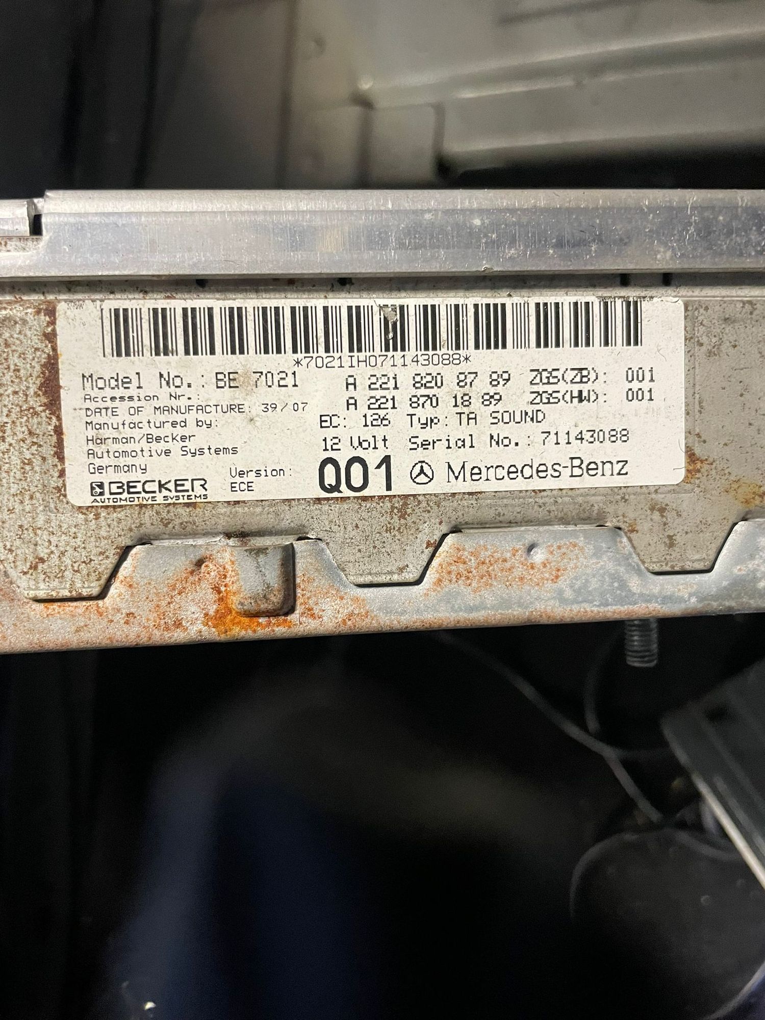

2 questions:
1) I did check to see that the amplifier fan does not move. Is there any other way to make sure it is the amp that needs replacing and not some other module in the fiber ring?
2) Several dealerships and parts suppliers have this amp in stock. They all seem to have a 20% return charge, which I am fine with, but more importantly, they all seem to have the same language about "Electrical Parts are not returnable." Has anyone ever ordered one of these amps, then found out it wasn't the amp after all, but another module, and tried to return it for a refund -20%?

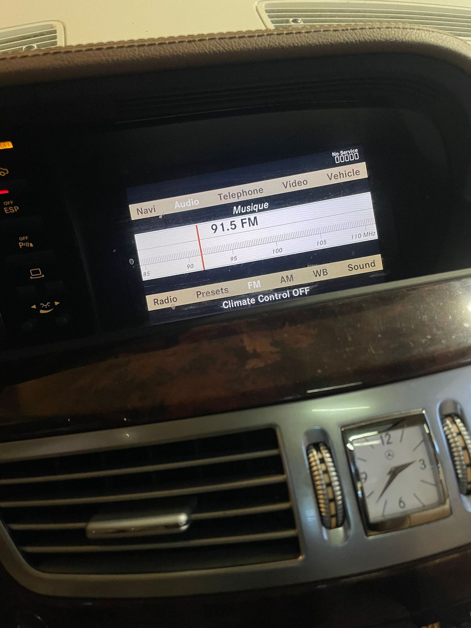

I get no sound from Radio, b/c the comand screen says "device not available"Originally Posted by BOTUS
The sirius module is a stand-alone unit it has NOTHING to do with sound creation from any other audio source - if it dies it takes down the fibre loop and all things stop due to the breakOn FM or AM radio (the Tuner that is also built inside the Amplifier for ALL audio) do you hear anything - if 100% normal the AMP is NOT the issue
The fan is a joke and that will help kill the Amp
I get no sound from Disc b/c though I am able to load a disc, and the comand says it is reading Gracenote information, it stops there and nothing plays... so no sound from disc.
I get no sound from AUX, which is the last input in used (it has a dot next to the word AUX under Sound options) b/c the word AUX is greyed out... and when I plug my iphone into the AUX receptor as usual, there is no recognition, so no sound.
So bottom line, I get no sound from Radio, Disc, or AUX.
OK, I'm stuck and need specific instructions on how to determine my problem is the amp and not the Sirius module again. Reason is that I have found part 221-870-77-89-80. at several online parts retailers, but have verified with at least one that it is considered an electrical part, and electrical parts are not returnable. So I would be out $700 if I receive a remanufactured amp and it turns out my existing amp is just fine.
I used a fiber optic loop a year ago and dtermined that my audio except for FM radio returned to normal with the loop inserted in place of the Sirius module. This time, when I insert the fiber optic loop in place of the Sirius, the Disc player, and the AUX, along with the FM, continue to not work at all.
So that made me conclude the amp is the problem. Or the amp AND the Sirius.
Does any have a step by step set of procedures that I can follow to determine with certainty that the amp is not working? I mean instructions that a 10 year old could follow
