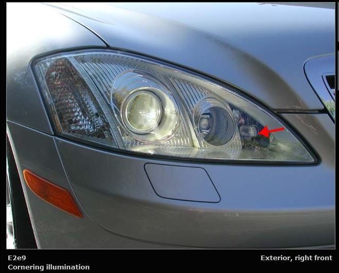

Facelift access to LED is deleted (MB does not offer separately), check all connectors/pins to headlight.

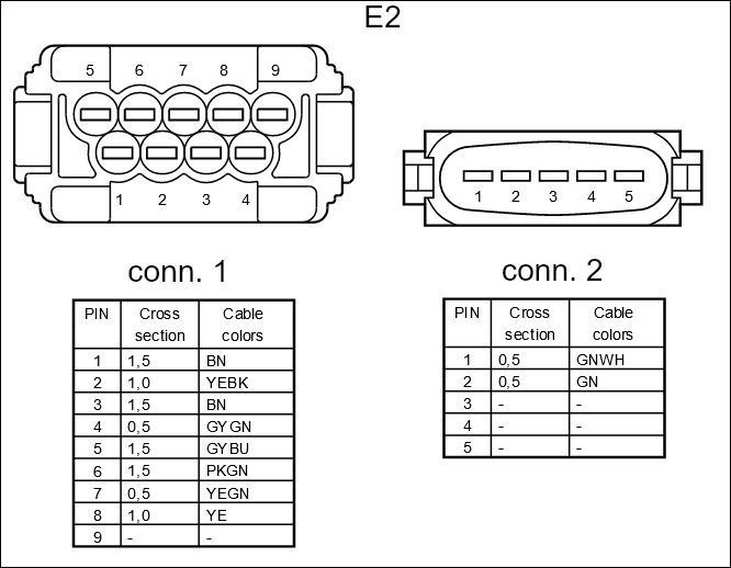

Do you happen to have the pinout diagram? I checked the connectors and none of them is corroded or has anything that makes me think it doesn't hold a contact. Also used contact cleaner and dielectric grease without any luck.
File Type: pdf
File Type: pdf

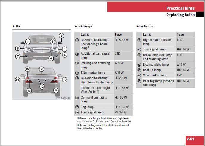

Old Jan 3, 2022 | 04:44 PM

Ah yes the owner's manual. Wow it's an H7.

Awesome ... Thanks a lot. I'll go dig and troubleshoot.
