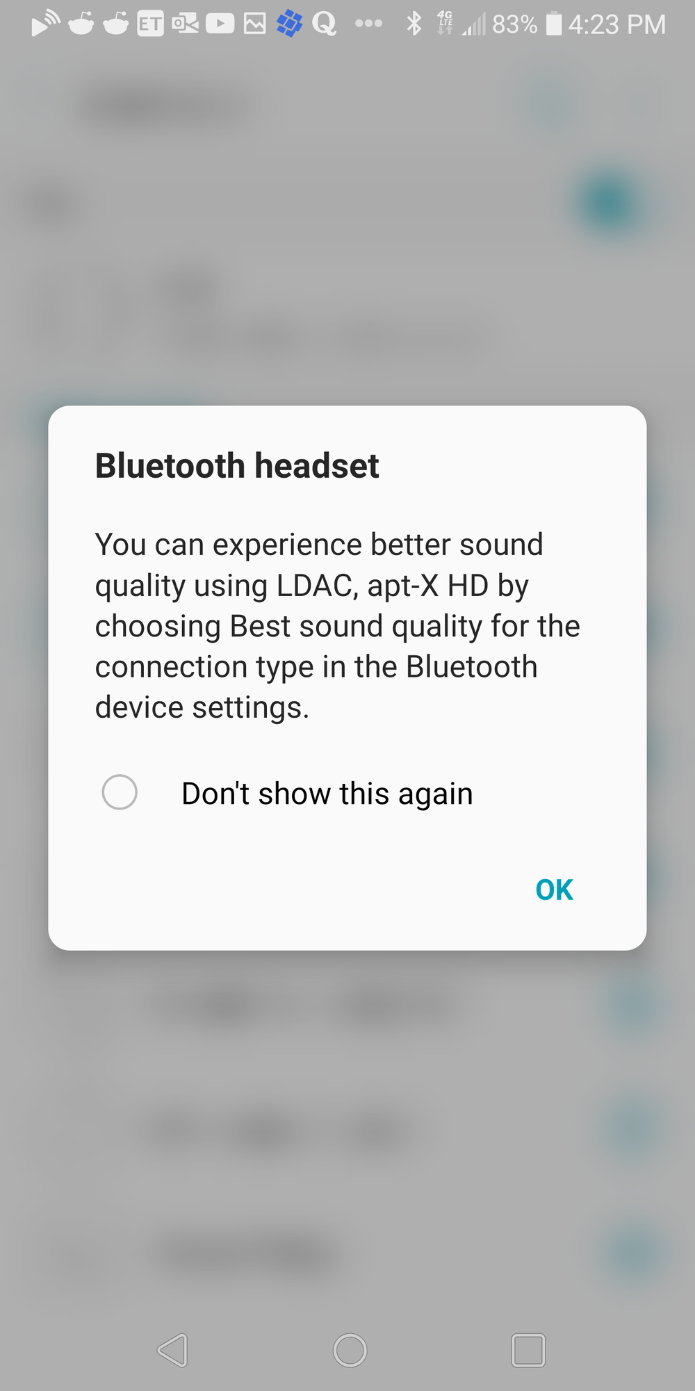

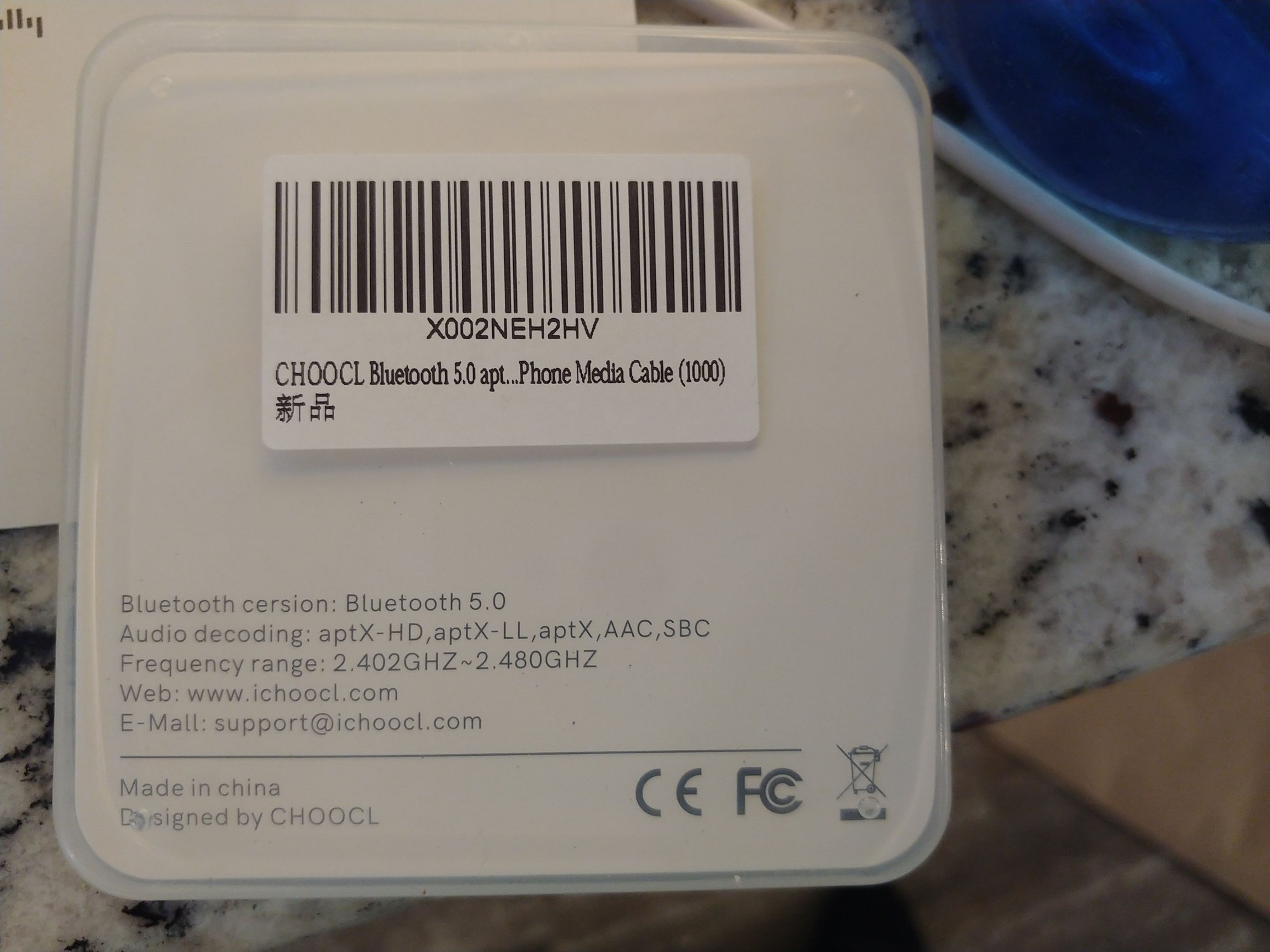

Just got the CHOOCL unit that promises all the high res protocols/streams. Plugged it in, started engine, paired with my Android phone, turned up the BT volume on my phone to max and switched the audio input to aux. Then I opened Pandora and shockingly, the artist and track was displayed in the speedo cluster. Prime music also worked! And this does really seem to support high res audio and may be the only one that does? This is one of those rare times that I got exactly what I wanted. Only downside is it turns off with the ignition which, ironically, I asked for but I of course wanted it to work in accessory (ignition switch position 1). However this gives me faith that it won't drain my battery. Does mean I can't listen to music on my phone unless the engine is running.
Overall this is a win. Surprised no one is running this unit. I'll report back if everything goes sideways.

This one may also insist in auto playing media from my phone as soon as a connection is established. So if I don't want that I would have to press pause on my phone. I was really hoping mute or the OK button on the steering wheel would have paused but I don't want to get too greedy....
It does have a mode switch on the unit that the directions say is iPod mode or general mode. I don't know which is default but I left it. It is possible it is in iPod mode and maybe that's why the track info works. But again I thought this only worked with Apple products, not Android. It could also be handset-specific with Android. I have an LG V30.
