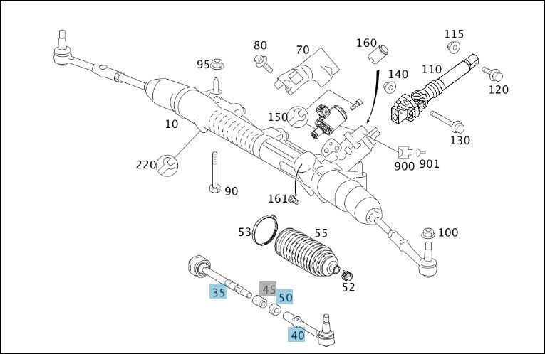

If they have not already done so other things to consider, suggest checking tie rods see attached bulletins and torsion bar linkage & bushings.

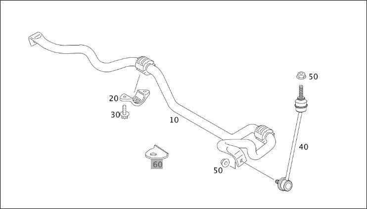

The glue thing was a legit repair, albeit bizarre. I just read about it today. Front anti-roll bar bushing/carrier to subframe.
No, it's not legit. It's BS. I don't care what you read.

why TSB say to glue sway bar bushing, instead of replacing - MBWorld.org Forums
It's legit in the sense that this is the OEM approved way to fix this particular issue. You can talk to me all day long about how you don't agree with it, and that's fine.

Also check sway bar bushing/ brackets. I had one of the bolts break off on a bracket.. Made the same noise.

damage on sway bar or control arm can be visual. Since the car checked by shop already therefore I believed no issue with sway and control arm.
