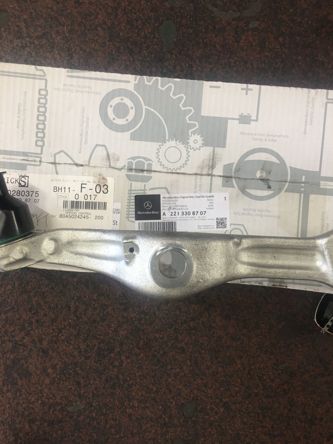

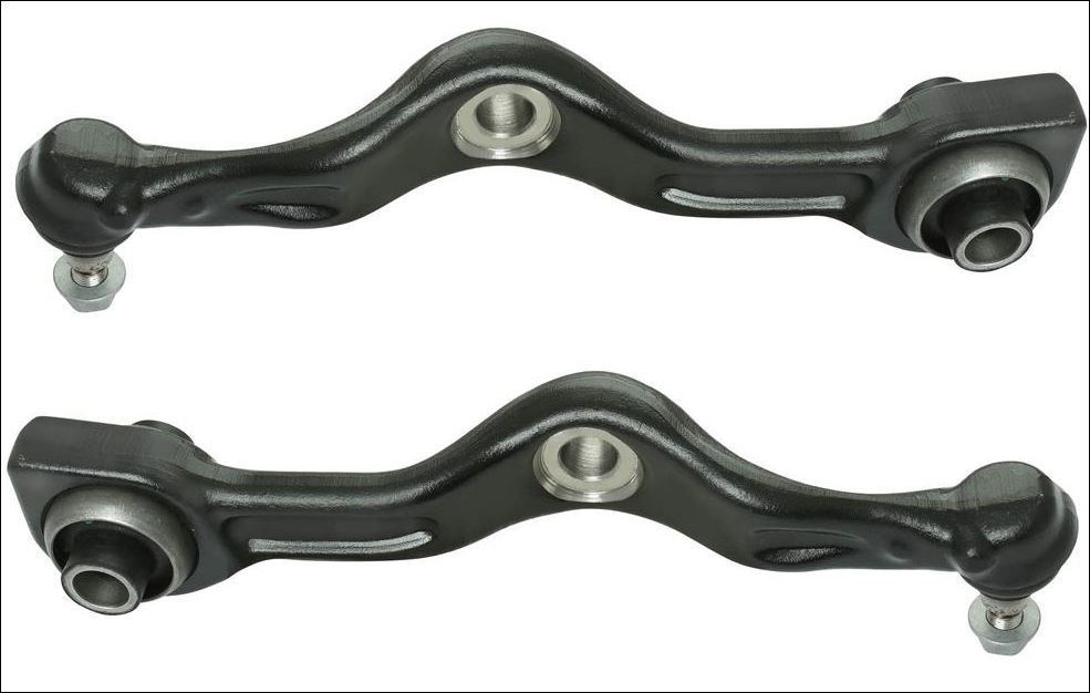

Hey all,
Can anyone confirm the part #s for both front rearward control arms?
Ive been on a rollercoaster ride with sourcing the correct parts. I ordered them from FCPEURO first and I was sent Lemforder OEMs which appeared to fit but were slightly off.
I slapped myself on the hand and said “That’s what you get for trying to save money!”
I then purchased directly from the stealership and again the part doesn’t fit!!! Wtf
part# from FCPEURO and MBParts USA (ordered online and picked up at local dealership):
221-330-8707
221-330-780780
The stealership says it’s the right part🤣🤣🤣 and one of the parts guys claimed that the fitment issue is related to my S600 NOT being 4-Matic??? Wtf😂
Im no expert but does a V12 S600 4 matic exist? Anyway…

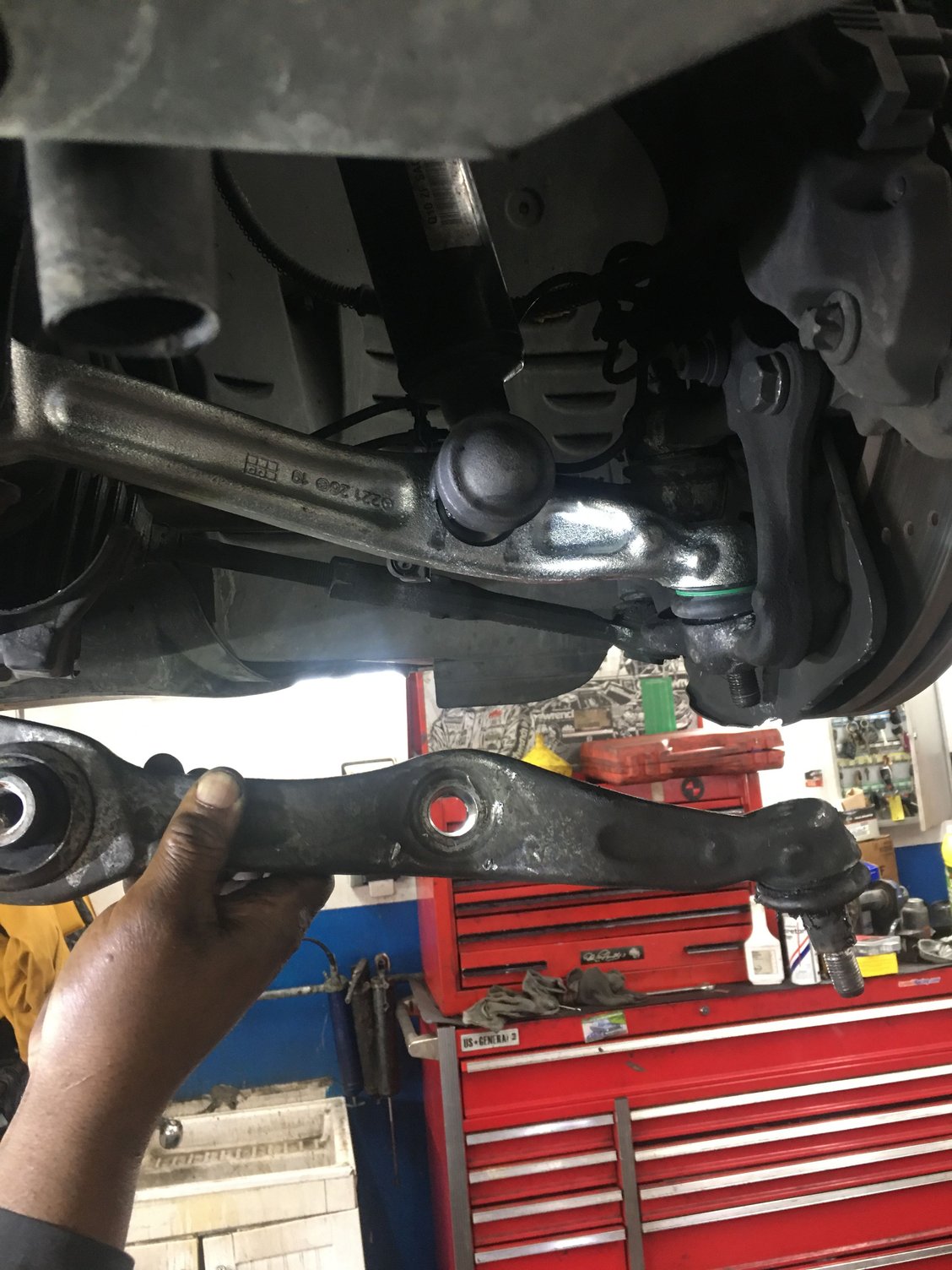

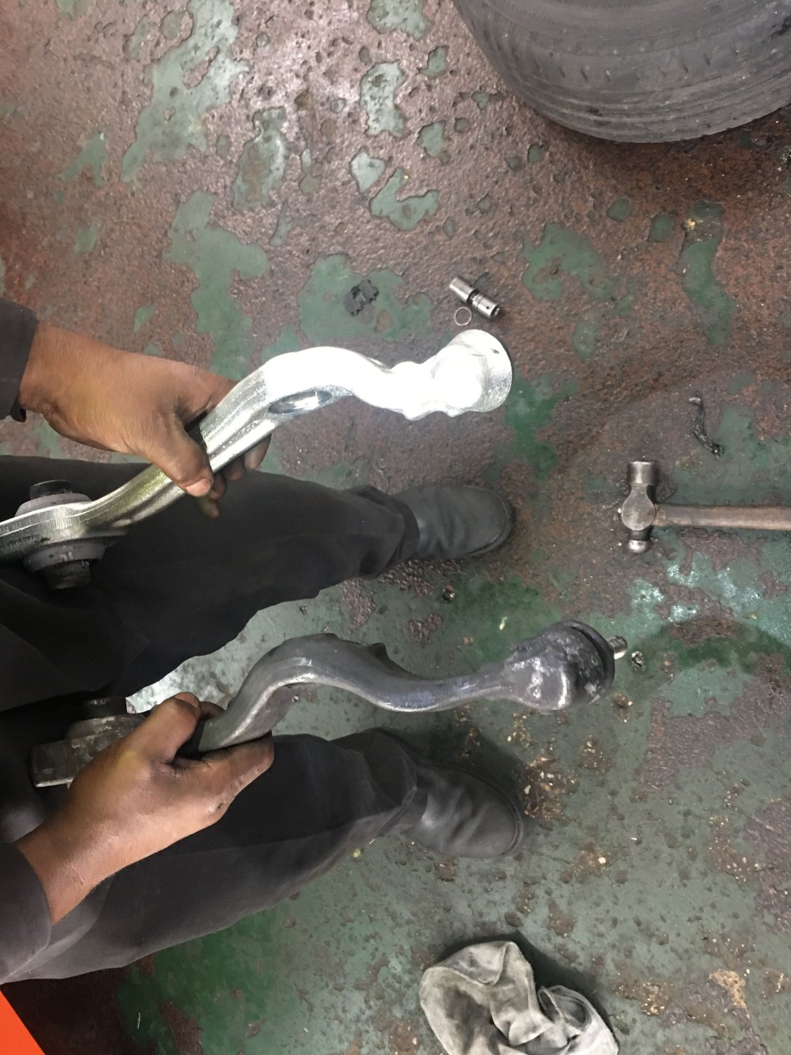

Here’s my indy holding the original next to the new:
Anyone with access to genuine part#s pleas help!!!!
thanks so much in advance!

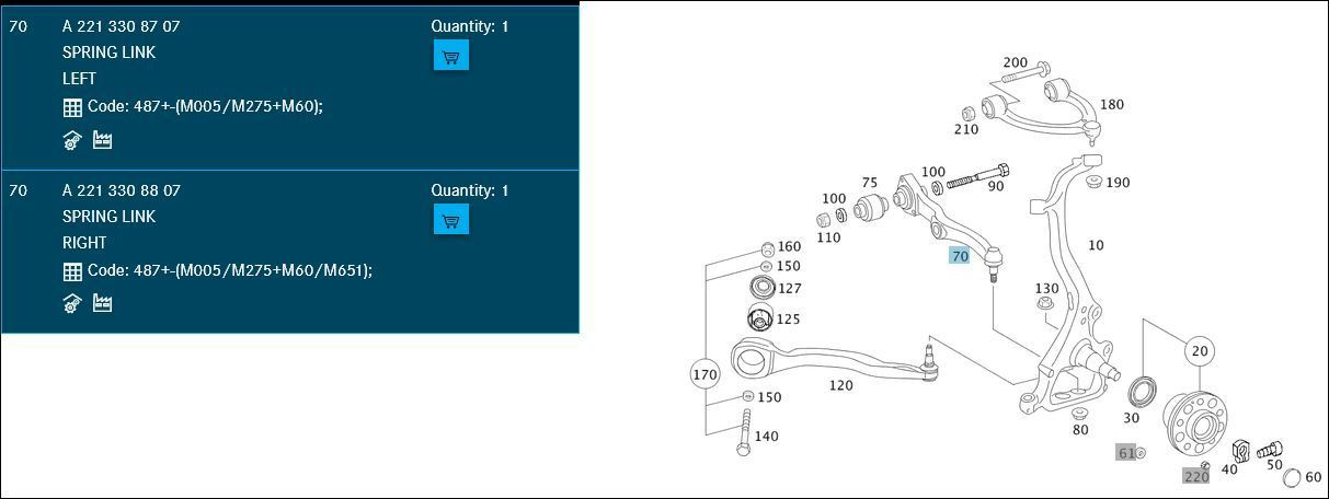

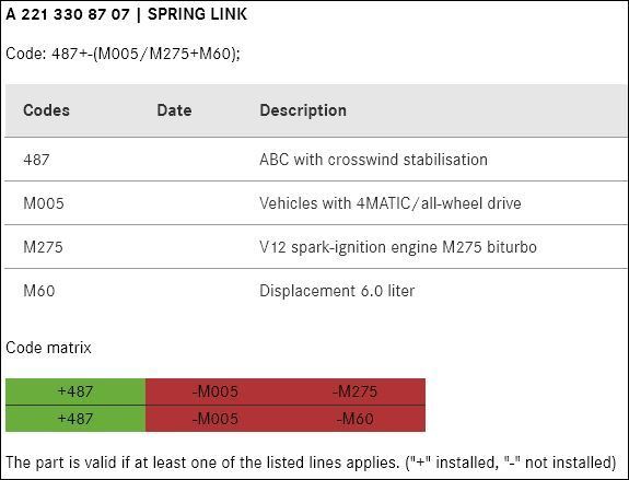

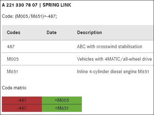

7807 is 4matic correct part #s are left 2213308707, right 2213308807.
First and foremost, thank you so much for the thorough information!!!

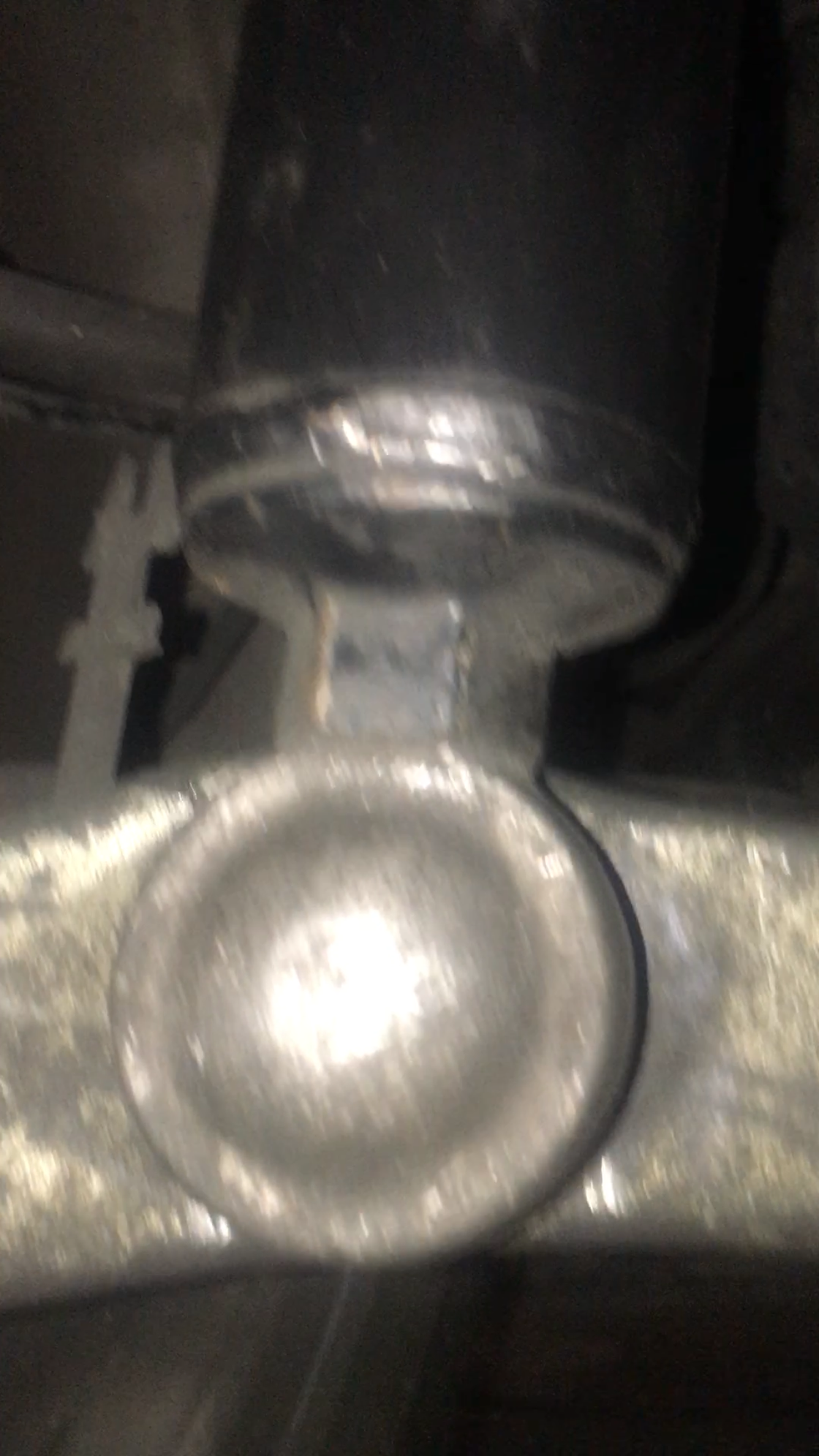

This is a real head scratcher because as you see here:

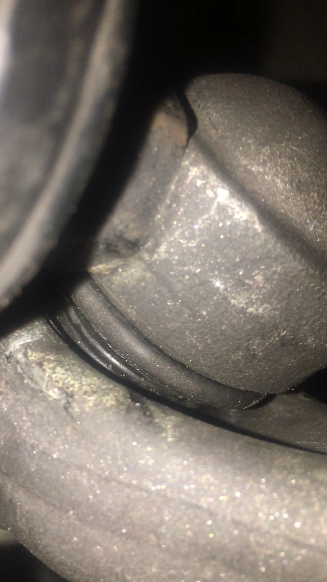

See the part # but did not fit at the center hole where strut connects. The hole diameter was too large.
This is why I’m so confused.
As mentioned, I had the exact same issue with the Lemforder set from FCPEURO (same part # see below):
This is the Lemforder same part # which I sent back to FCPEURO believing they sent me the wrong part. The stealership part fit exactly the same. The center hole where strut connects way too much play for bolt to tighten
This is why I’m at a loss and quite confused!
I figured I was being punished by the V12 gods for going cheaper on suspension parts on this beast hence the FCPEuro failure, but when the purchase directly from MB had me in the same spot I was thinking I may owe FCPEURO an apology.
On both the Lemforder and MB arms the issue is there seems to be a missing rubber bushing for that center connecting point allowing the strut screw to sit securely.
Being that no such bushing is on the original arm, again I’m completely baffled by this!

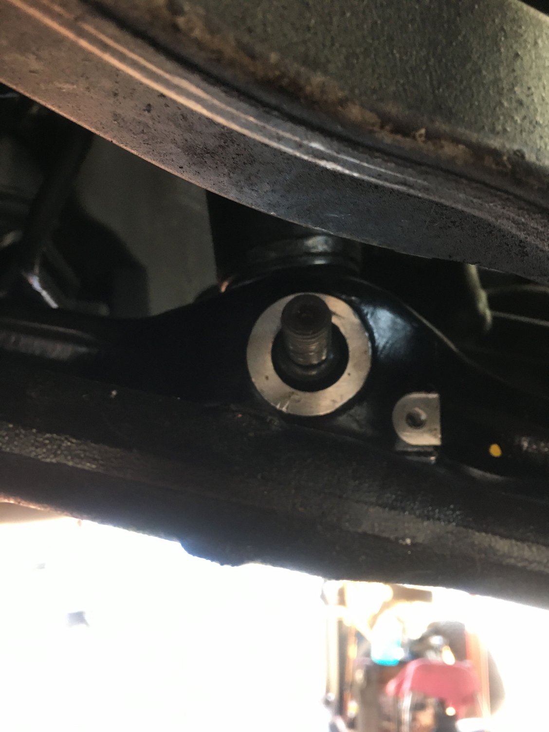

Is there a missing bushing or something on the bottom of your strut? I don't think the V12 uses different arms. It's just RWD vs 4Matic.
Old Dec 17, 2021 | 12:17 PM
V12mrinc's Avatar
Joined: Jul 2021
Posts: 119
Likes: 33
S600
That’s the million dollar question…”Is there something missing from the original strut?”
The only reason I’d venture to think there’s no “bushing or something on the bottom of the strut” missing is:
1) It’s unlikely that both sides would be missing
2) They definitely appear to be original equipment
3) The connecting hole on the new part is clearly much larger in diameter than the original.
Im definitely open to all suggestions though and looking at all possible explanations for this!

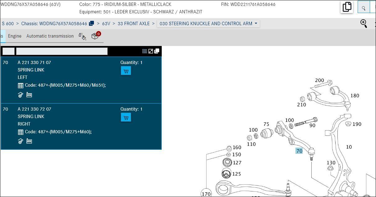

Interesting used 07 s600 VIN to pull previous part #s but #s for your vehicle are different:
File Type: pdf
Oh WOW!!!!!
This is absolutely incredible! What was your rationale for checking the other vin to cross-reference?
truly some brilliant forensic work!

I share your confusion in regards to the subtle differences in description yet both part #s show fitment compatibility with an 2007 S600 but as I’ve shown above part # ending in 8707 definitely does NOT fit.
I do see the #…7107 part and I’m not sure if it’s a visual placebo effect but it actually appears more like the original arm at the bend at the strut connecting point.
I did notice in the above attachment with my VIN the vehicle type was noted as “S600, S 600 Guard L” I was wondering if this had anything to do with the difference in part# (i.e. S600 uses part 8707 vs S600 Guard L uses 7107)

Interesting. Doesn't that mean it's armored or something? I could see a beefier arm but they don't look that different to me...
I wonder if this also means you have different struts or other parts in the suspension.

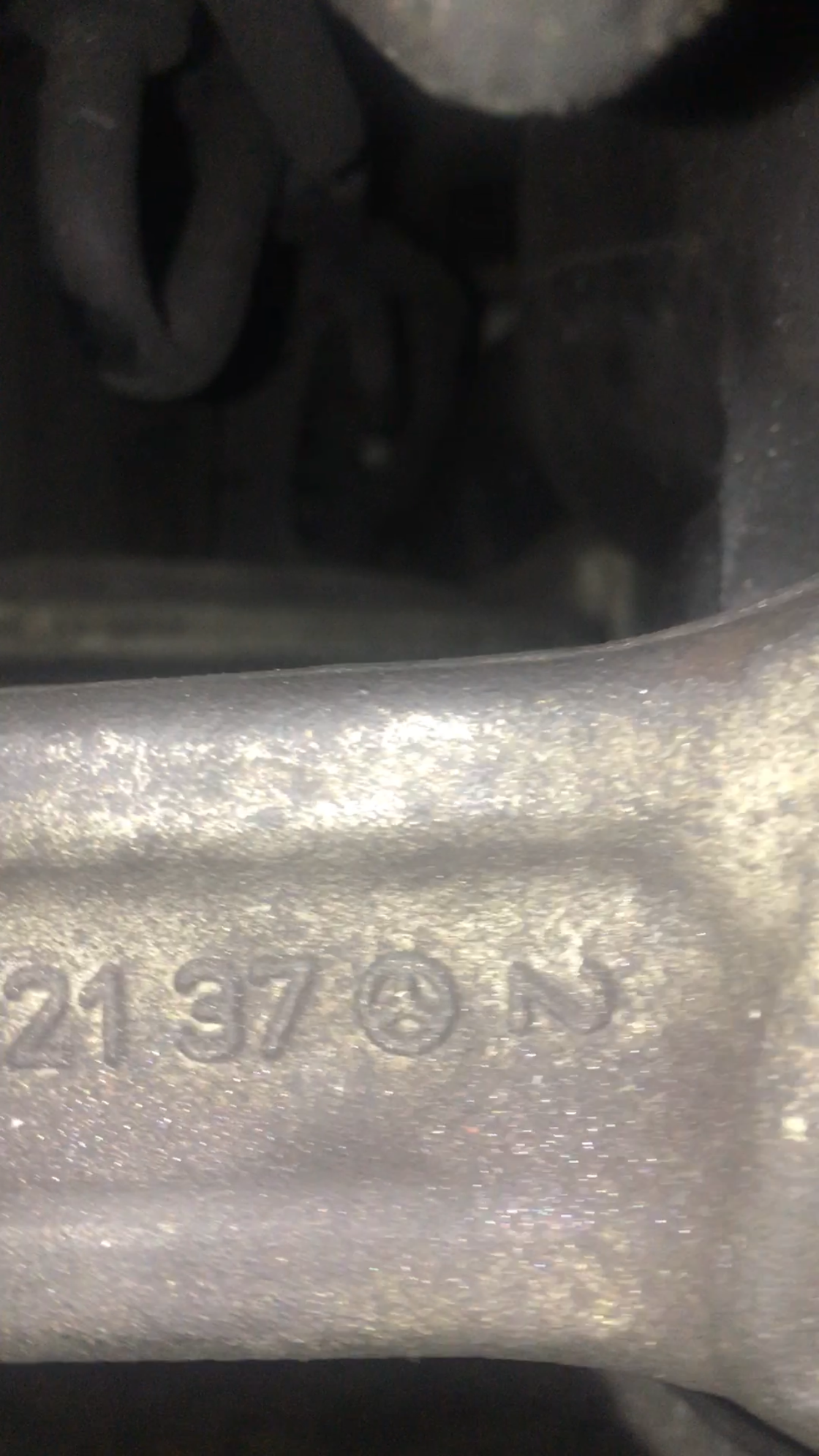

Doesn’t the part in the car have the part number on it? I changed my S560 arms and they had the number cast on them.

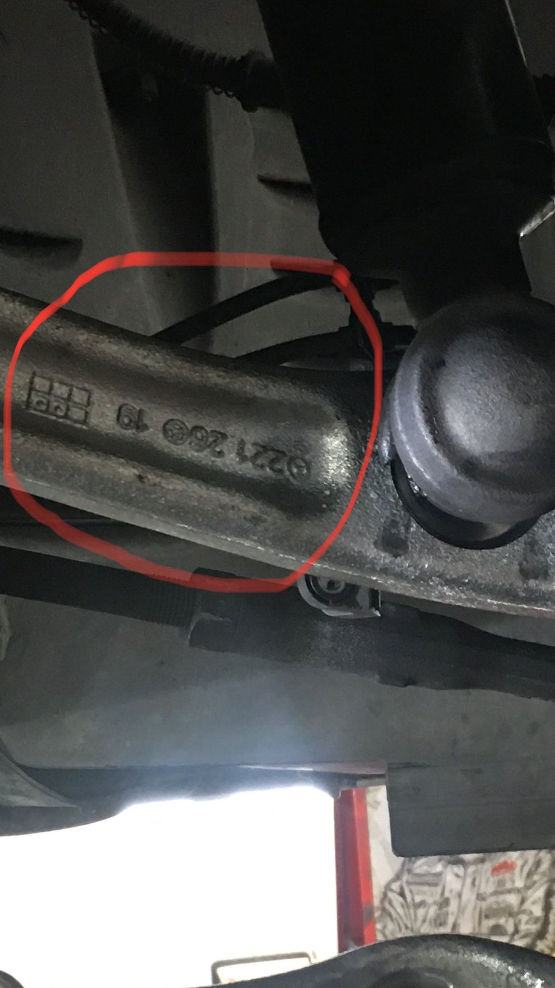

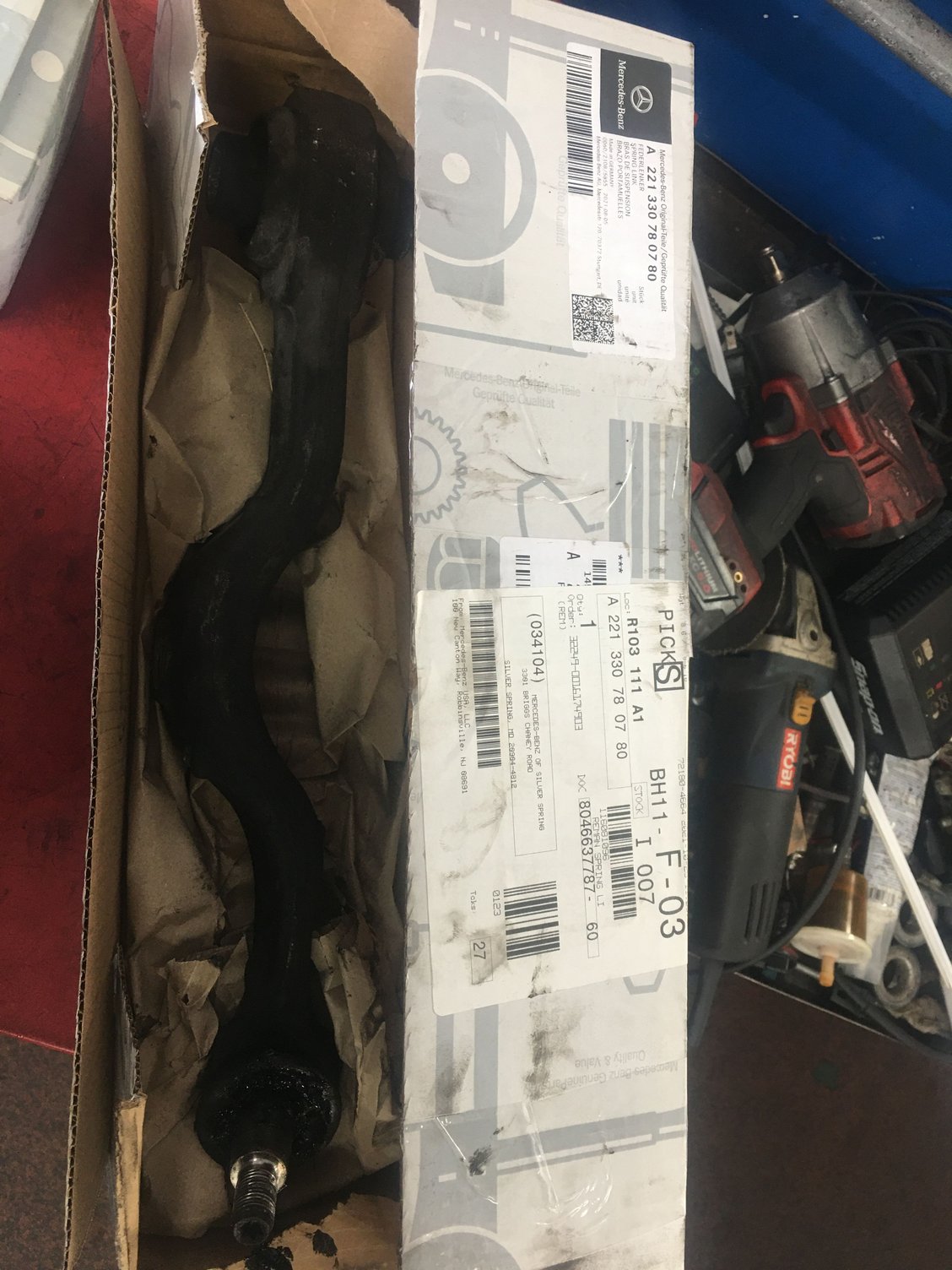

Here’s the weird thing about the part # casted on the control arm (see here):
on the new part the #s 221 26 19 are clearly visible however that part # if searched seems to be a different arm altogether.
Also, as you see here:
This right side arm part # is 221-330-78-07-80 based on the MB box.
So just trying to solve this mystery.

This is so weird as the part from MB does not fit either. This brings the next question: if you were to replace the struts, what would the bottom mount of those look like?
The horror scenario here is that MB changed the design and made the parts that your car was built with obsolete meaning that if you change either the arm or the strut you need to replace both.

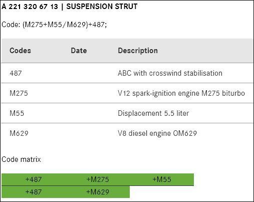

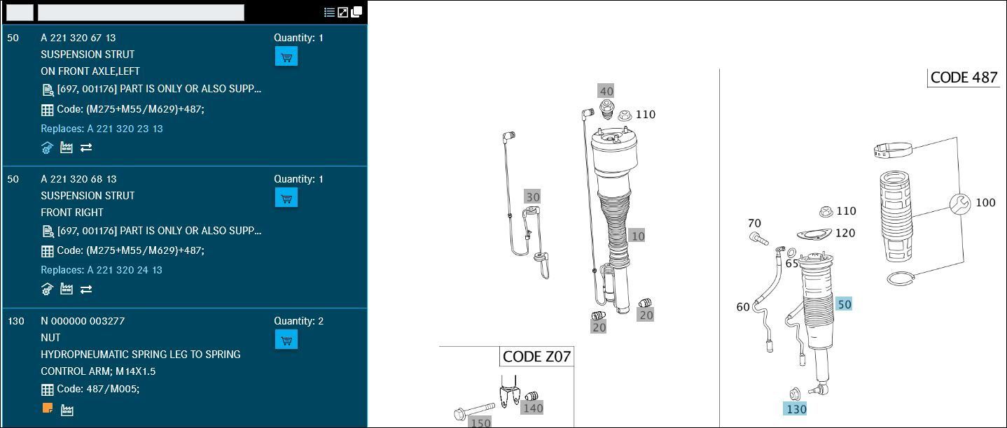

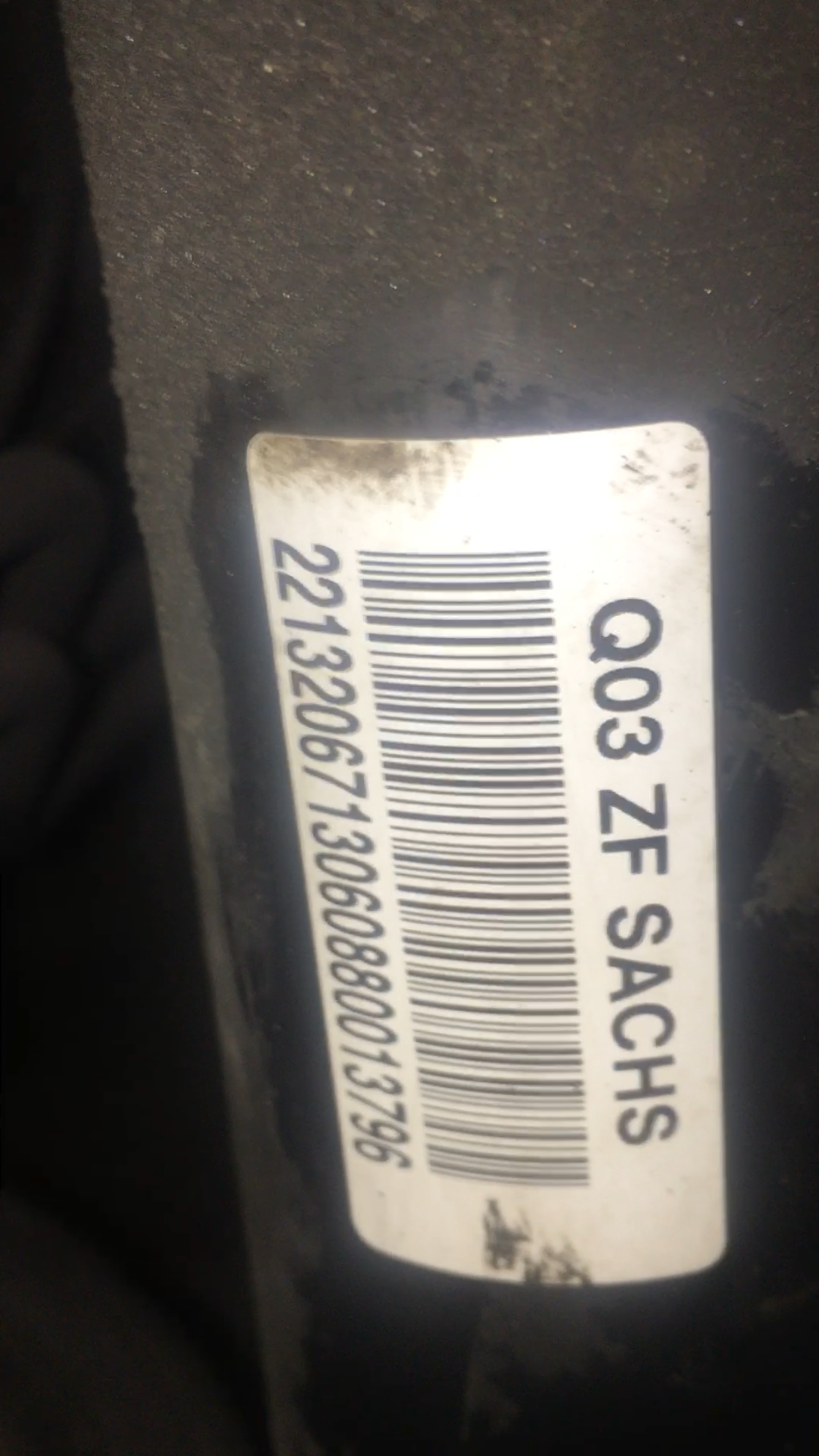

The bottom of your strut looks very interesting. Not like the "normal" ABC struts I've seen.
Do you mind sharing the part number of your strut?
I am yet to understand the difference between the struts I've seen. (WIS makes mention of different torques depending on the size of the nut to the strut which is why I know there are at least two different types of bottom joint in these ABC struts)
No problem at all! So I’m not certain of the part # but I just went and took some photos of the strut from various angles, perhaps that will help!
see photos here:
Barcode on strut
Backside where strut connects to thrust arm
Another angle of connecting point where strut meet arm
“5. L5” in yellow on strut
hey Arrie,
I was just taking some photos of the strut and wanted to show you the #s casted on the original arm- see here:
221-37-2
Old Dec 19, 2021 | 03:33 PM
konigstiger's Avatar
Posts: 15,901
Likes: 4,630
From: North Scottsdale, AZ
'71 Pinto
Strut is MB, arm that ain't no MB part # format.
Old Dec 19, 2021 | 04:01 PM
V12mrinc's Avatar
Joined: Jul 2021
Posts: 119
Likes: 33
S600
The new arm which ended up being the wrong fitment had a similar # format casted on it that is totally different from the “part #” see here:
221-26-19
What’s even more interesting is if you search this 7-digit number the arm that populates in general internet search findings appears to be slightly different than this one!
Saga continues…
