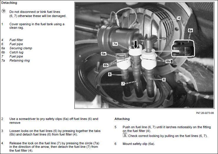

Having said that, I'm wondering if I'm missing a securing clamp (like 6a in the attached photo) of some sort. I looked in the gas tank and didn't see anything below and I don't believe I broke the built in clamp on the hose. But the built-in hose clamp by itself isn't strong enough to secure the hose under pressure so if anyone has photos or experience with similar issue, would appreciate any input. While my zip tie solution is working I'd still like to know why just reattaching the line and engaging the built-in hose clamp (two small black latches that push down) doesn't provide a secure connection. I decided to change the pump and filter as I kept getting low fuel pressure codes (those are gone now). Perhaps the hose clamp itself was beginning to fail and I broke it during the filter change (but there are no stray or broken pieces anywhere that I can see).
I didn't take a photo of the replacement fuel filter itself outside the tank to show the hoses (I'll do that tomorrow most likely). But one thing I noticed is that most of the DIY videos show a filter with three hoses at the bottom of the filter and a securing clamp on the end of each hose and a clamp that holds all three hoses together. I didn't have any of those sorts of clamps on the my fuel filter hoses. The filter and pump were factory as I had to break a coating/sealant that was sprayed over the retaining nuts holding the filter and pump in place. So I don't believe there was any chance a previous replacement occurred.
I have attached a photo of the old filter and the fitting that keeps losing connection with the hose. And also from WIS the photo of what pre-2013 filters/clamps look like.

Perhap a securing clamp 6a is mising, if it in place then it's impossible for hose disconnecting.

Given my fuel filter and lines look much different from the WIS diagram, what I'm really hoping is someone else with a 2011-2013 S-Class that has the newer fuel filter like I have can post some photos or at least confirm that I am missing a securing clamp or not. This weekend I will post a photo of exactly how my filter configuration/hoses look like. I looked all the way down the fuel line and at the bottom of the fuel tank and I don't see a securing clamp anywhere and I don't recall having to remove one when I switched out the filter (I should have taken before and after photos of everything). I have a feeling that maybe the tabs built into the hose have weakened such that they won't secure the hose anymore and I will just need to roll with my zip tie solution. The low fuel pressure code has cleared and the car runs normally if slightly smoother idle now. If other vehicles with the same filter don't have a securing clamp then at least that would satisfy my curiosity as I don't plan on buying a new tank just for a new hose/clamp if I can avoid that.

If you notice in Konigstiger's post, the diagram shows a different fuel filter with three parallel connections on the bottom. It also has a "securing clamp" for one of the lines (and in a couple YouTube videos there's also a clamp that holds together all three lines). Anyhow, that appears to be a pre-facelift filter. Not sure when/why they changed the fuel filter, but the 2013 filter is different. I even searched the bottom of the fuel tank thinking maybe I had a securing clamp that somehow fell off but didn't find anything. I even tried using the original filter and the line would no longer stay on so I must have broken or bent the plastic clip somehow even though there were no pieces/parts in the tank and the connector looked like it had all the clips and they appeared to work (or maybe just disturbing the connector after nine years submerged in fuel, it weakened just enough to no longer work?). Anyhow, I went to the dealer asking if I could buy fuel line components (there's hoses/wiring harness inside the tank), but they weren't able to identify any part numbers for components inside the tank. They also took a look at my solution and said it looks like it will hold but obviously isn't an approved Mercedes solution.
