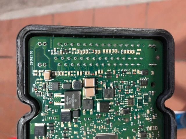

Parking break fault because motor is bad and motor replacement usually resolve problem. In your case ESP/ABS mudule could be a root cause of the issue. I feeling that most car over ten years also will have problem with ESP and W221 is not exceptional case (I see many W221 had problems with ESP). The issue due to vibration on the engine and it make ESP harness poor contact (such problems happened to all car manufacturers such as Mercedes, BMW or Audi...). What did I do is just open ESP and soldering all harness pins.
below is the ESP pins when opening for your info. Hope it help.
Reply 0
