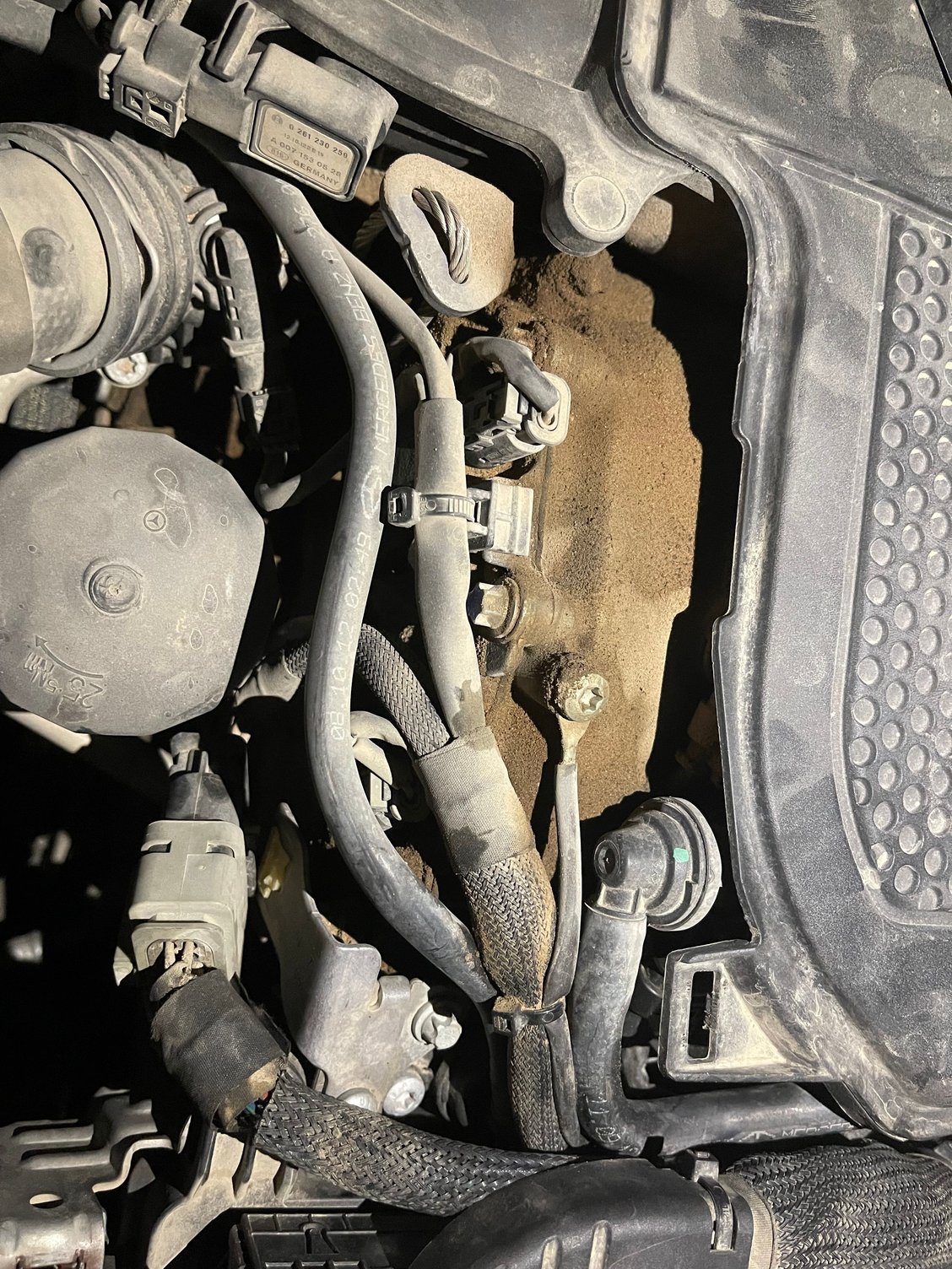

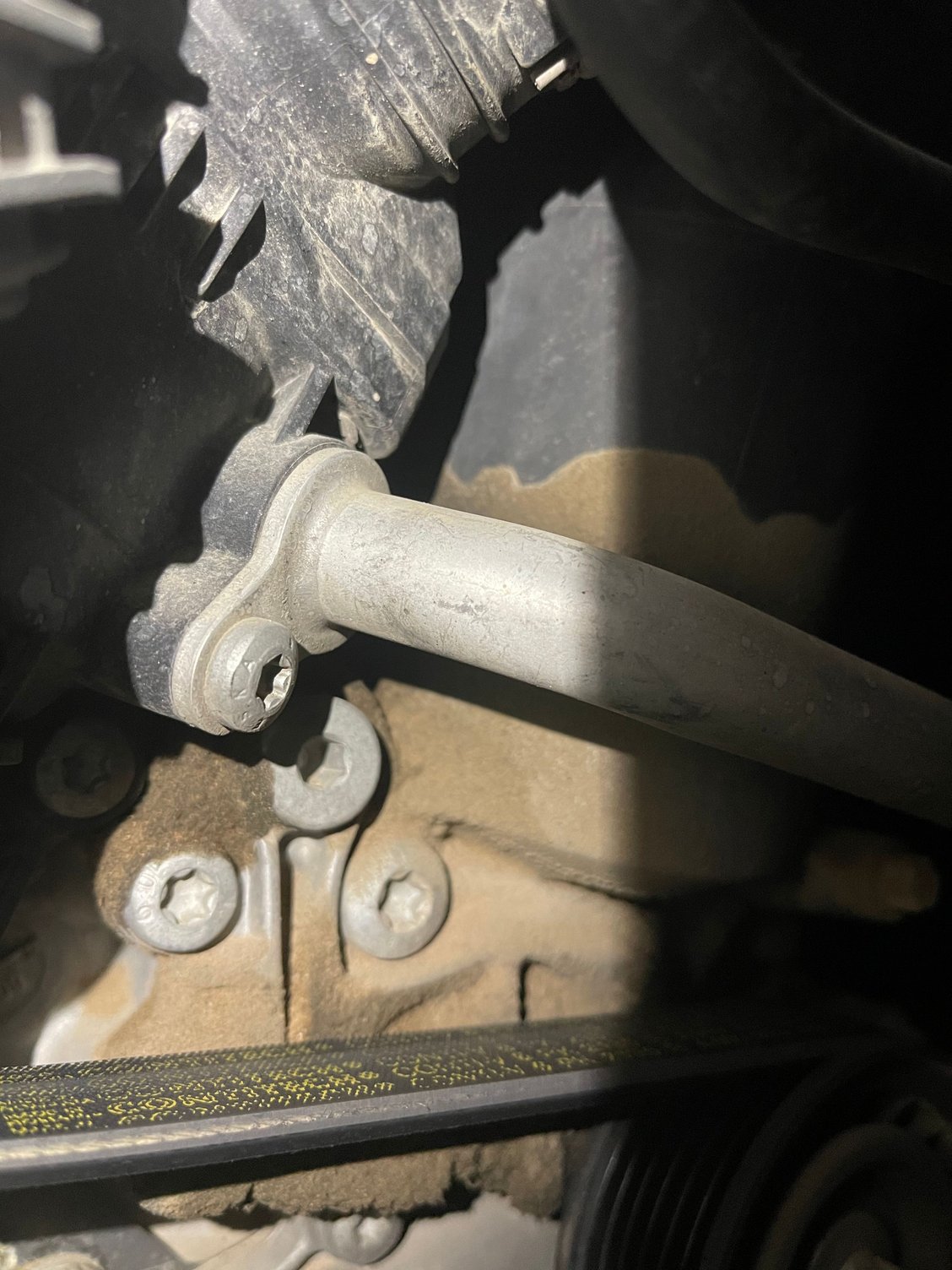

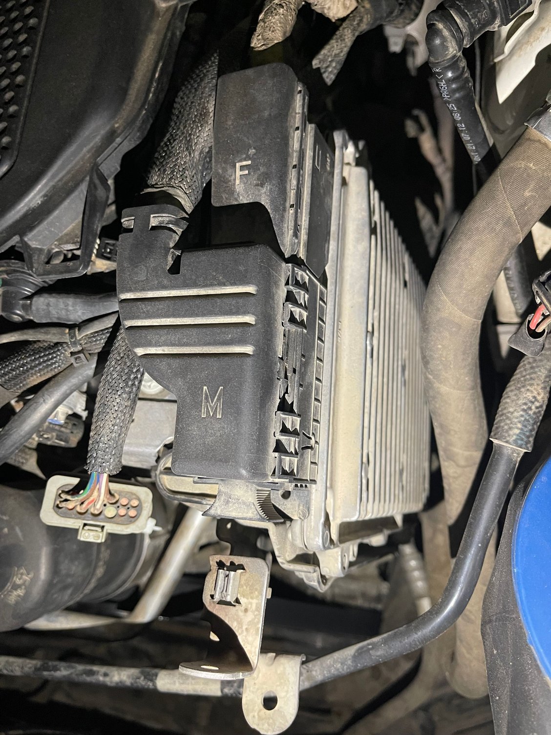

I had a bad camshaft sensor (exhaust side) leading to a stable yellow check engine light with a slightly rough engine and a temporary vibration after each cold start. Bought a new one and took my car to an MB mechanic. He took off the engine cover to replace the sensor. I noticed what looked like old oil with dust stuck to it on the driver's side. I also noticed the same around the oil fill cap. He said it's probably the head cover needs fresh silicone. He said MB cars don't have a head gasket. Instead, they're sealed using silicone. The oil dipstick showed a normal oil level after around 8k miles since the last change, and the car runs great after swapping the bad sensor. No more rough engine, and there's no burning smell or funny noises. No exhaust smoke either.
Oh one more thing: I had bad fuel pump and relays a few months ago that an indy replaced. He initially replaced the fuel pump but the car kept shutting off when it gets hot until he figured out it needed new fuel relays. I don't know if that has anything to do with the oil/fluid traces on the top area of my engine. But I thought I'd add it for clarity. My car now has 125k miles on the odo.

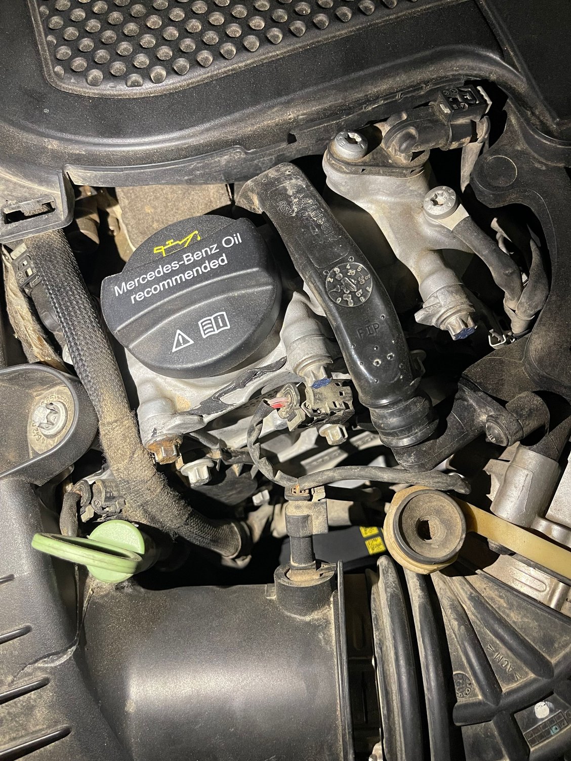

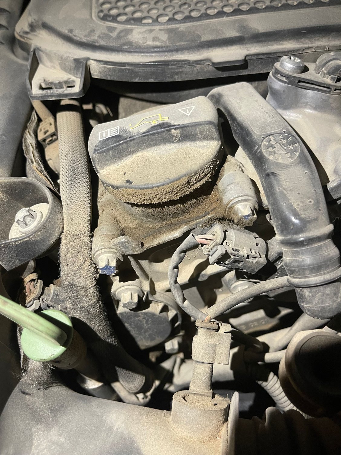

I attached a few photos. What do you think? Is this an oil leak? What's the suggested fix? Also, what do you make of the oil residue around the oil fill cap?

no sign of a leak, just a very mild weep once upon a time...
there is at least 3 litres of spare oil in there - if you never drive above 100mph for extended periods
in Germany they do 4k rpm and 130mph for hour upon hour - the 8 litres are to help out under those circumstances

Right side photo shows common leakage from poor front cover sealant process during manufacture. Solvable by DIY or dealer/Indy.
The left side photo shows spilled oil from oil change/oil fill. Not a leak.
Clean it all up and watch carefully.

I just wanted to post an update for future readers:

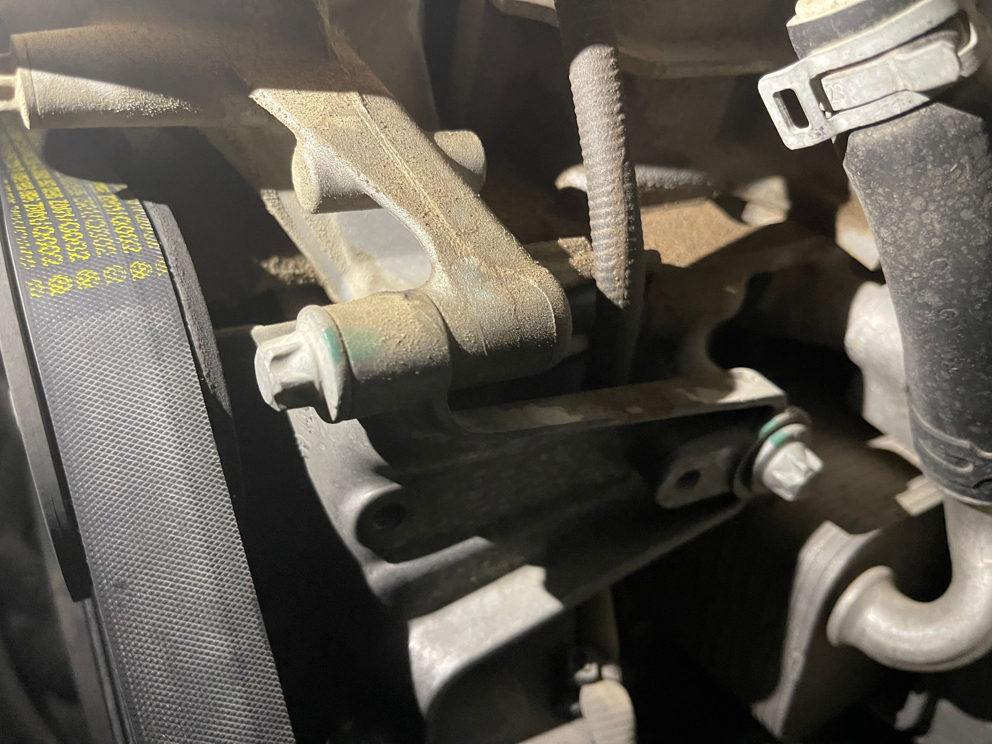

My man found the source of the leaks. The big mess on the driver's side was caused by a bad camshaft position sensor that failed on me three months ago causing a CEL to go off. I replaced that one a couple weeks ago and the CEL went away. He found two other camshaft position sensors on the passenger's side that are failing but not quite there yet to throw a CEL code. I told him to replace all three sensors as I figured they're bound to fail so I might as well take care of it now. He also applied sealant on the front cover as he said it's likely to cause a leak in the near future.
Unrelated to this issue: I've been having a recurring issue with the coolant level. A message on the dash indicating I should top off the coolant that would appear every two/three months when I'm taking curves on highways. I'd add about 300ml (10oz) of coolant to top it up every time until the message would reappear two/three months later. He found the coolant water pump failing, two pulleys that are also failing, and a top and a bottom coolant hose that are dripping from the joint rings. He replaced the water pump, all the hoses plus the thermostat housing and a bunch of gaskets and sealing rings.

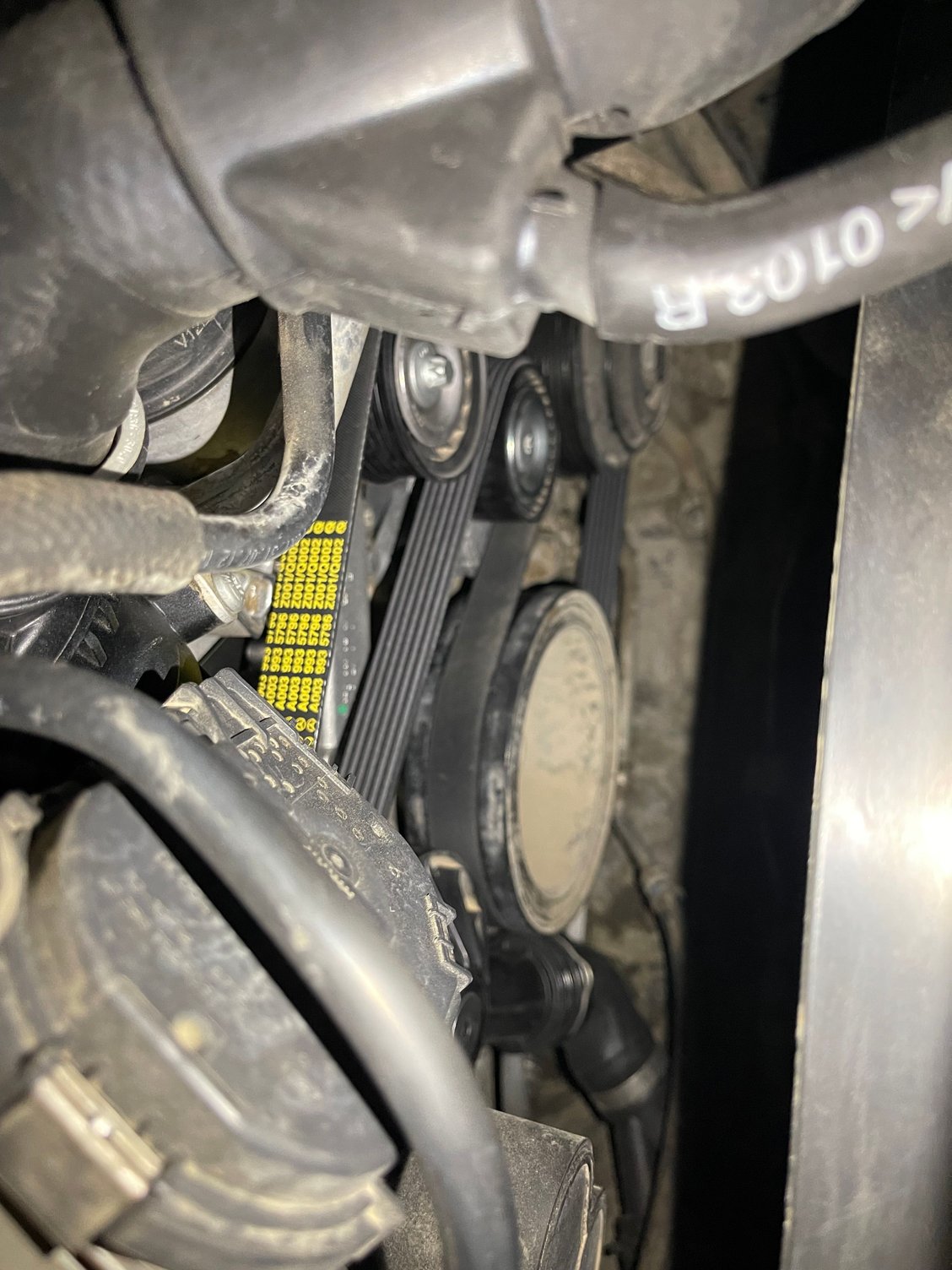

He said he was very worried when he saw the pulleys' condition as if they had seized on me while driving, they would have caused the belt to snap and cause a lot of damage that would have certainly taken out the radiator plus a bunch of stuff. I'm kind of glad I was concerned about the oil leaks to find out about the failing cooling system before it destroyed my engine.

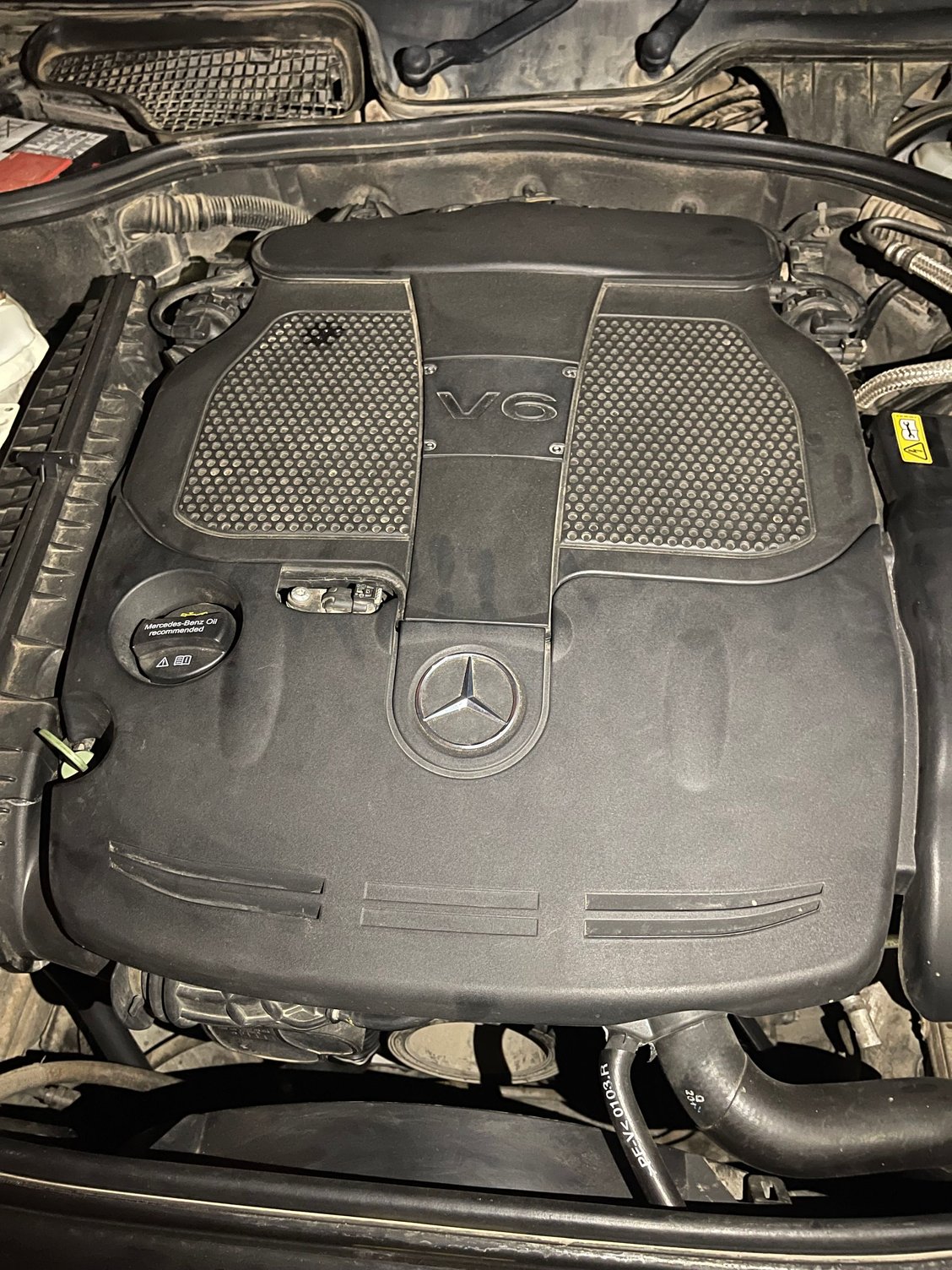

This is what she looks like after the surgery:

The engine looks much better. If maintained in that condition or better any problems, such as leaks, can be found and addressed before they become serious.

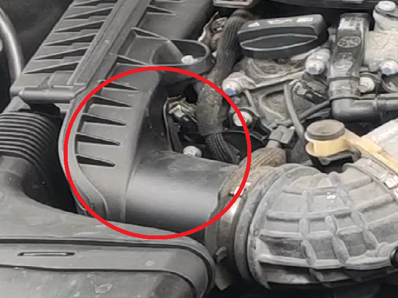

Looks good. Also looks like your airbox is cracked right at the elbow.
I've checked the engine compartment a couple of times since the fixes as the technician told me to make sure there are no more leaks. Found none, and the oil and coolant levels are per spec. Your comment made me go back and check again. Apparently it's not a crack. I don't know what it is but it looks like a line of hardened glue.

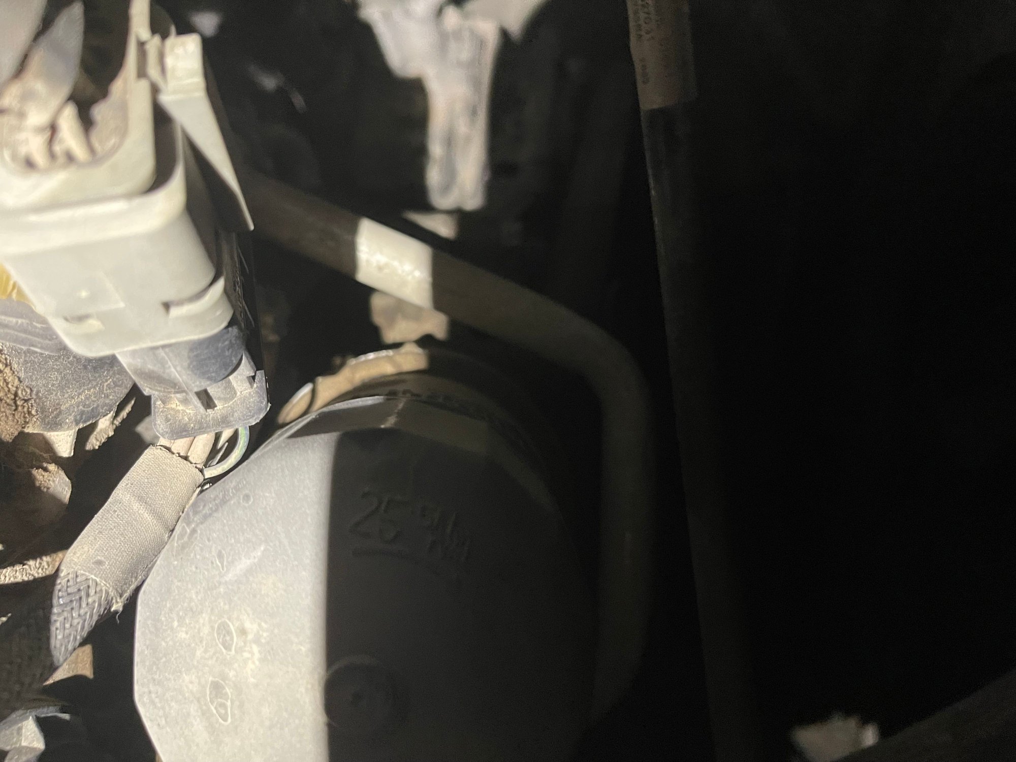

Nah, it's definitely a crack.
Sucks about the coffee. Stop breaking your car!
Enlarged image of mine;

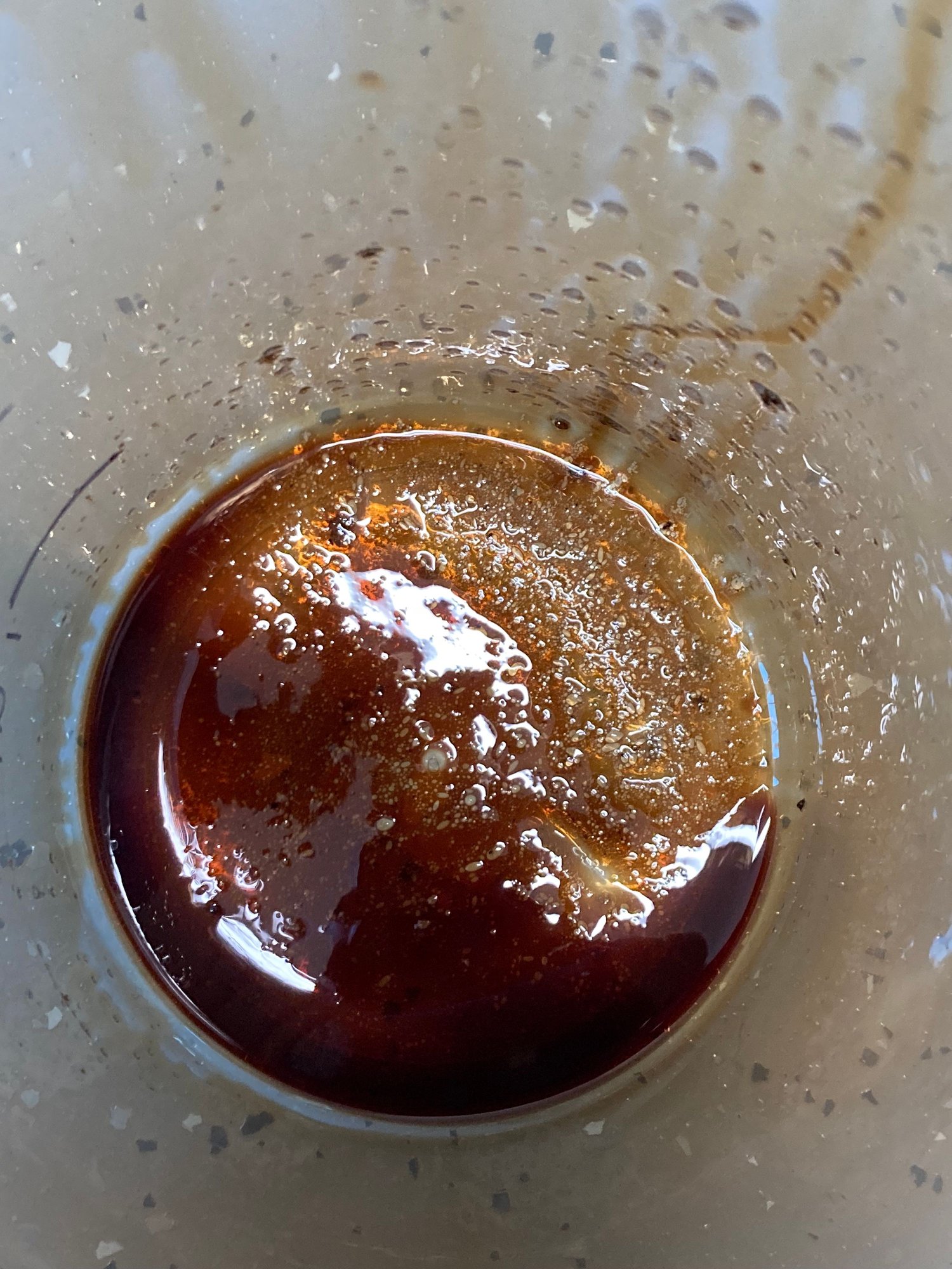

This is an adjacent issue to the original post, but thought I'd add here rather than a new string. I changed the oil yesterday--a few days short of 1 year, and about 7000 miles. I don't recall used engine oil looking so bubbly and orange in color rather than black. Anyone have a guess what, if anything, is up? Coolant tank looks clean. Used oil was Mobil 1 0w-40.

oil isn't meant to come out black - whilst it is designed to keep the gunk trapped in the oil - if the emission control and the vehicle use is correct, then these days on petrol cars the oil may well come out looking clean - in the old days overly rich fueling and cheap oils often gave it a harder time
the bubbles are probably just that it was very hot and as its such thin junk it takes little to make it aerate - when pumped around to bits that matter it shouldn't have the bubbles that you created as it hit the catch tray as a thin drip doing a 10" drop
