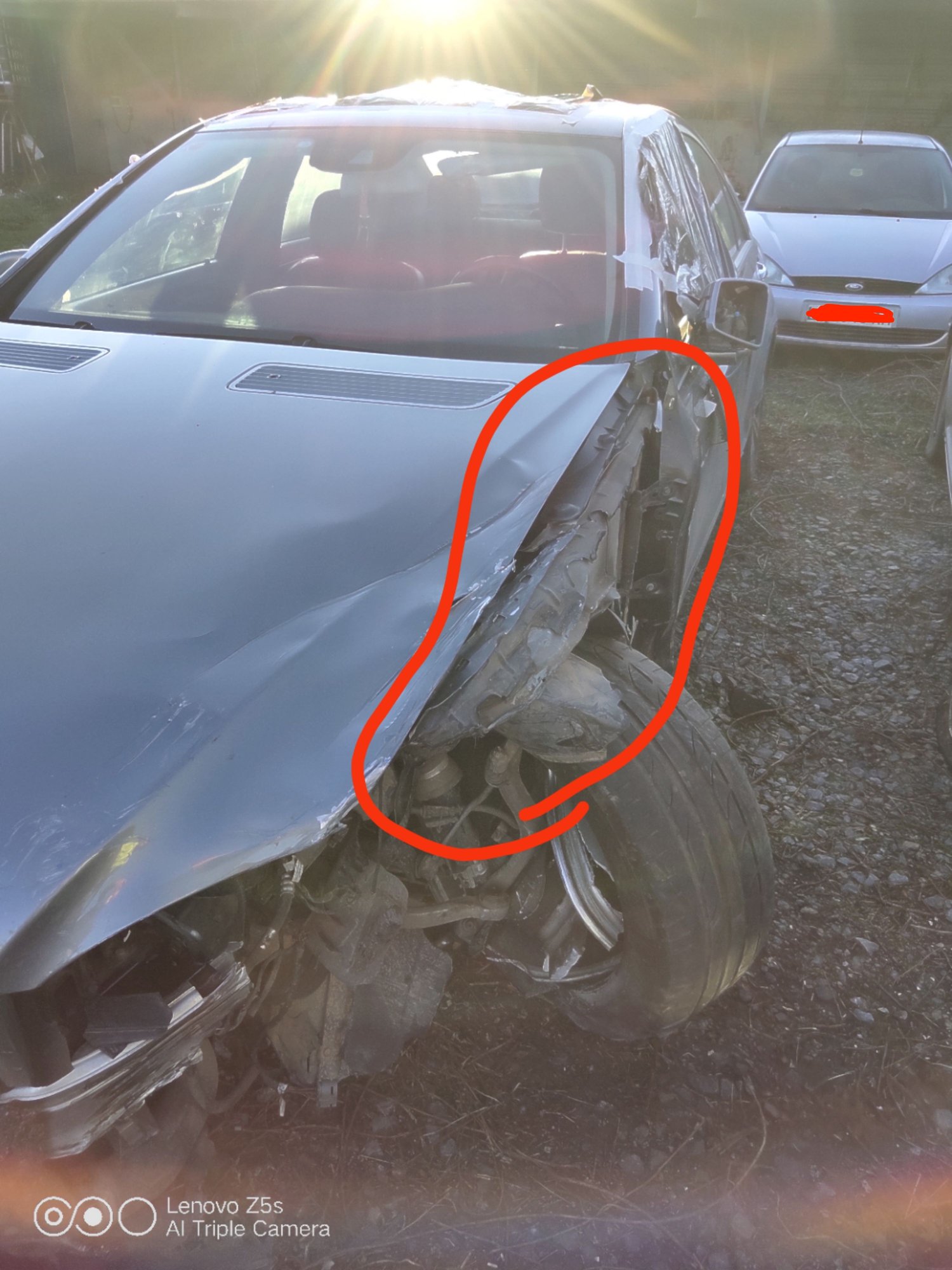

So recently a friend gifted away his 2012 W221 to me, after his son crashed it "relatively bad", although it is not totaled.
Here is a pic of when I picked the car up from police's impound, (yes my friend's son made a run for it on foot after crashing against 3 parked cars and left the S-Class behind - he was drunk).
The reason why I decided to fix this car, is because the front of the car is relatively intact. The wheelhouse obviously needs to be cut and soldered in a new one. But I knew that the chassis, specially the chassis leg wasn't bent, or if it was, it wasn't too bad.

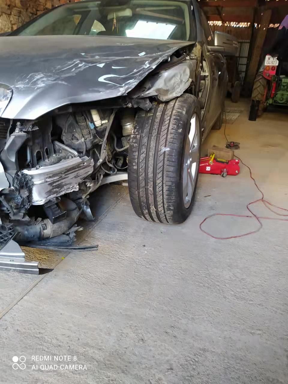

So I took the car home, and replaced the whole suspension (only the Airmatic Strut survived, the rest all was damaged, even the brake caliper and the steering knuckled and all of it had to be replaced). This is how the car is looking like now:

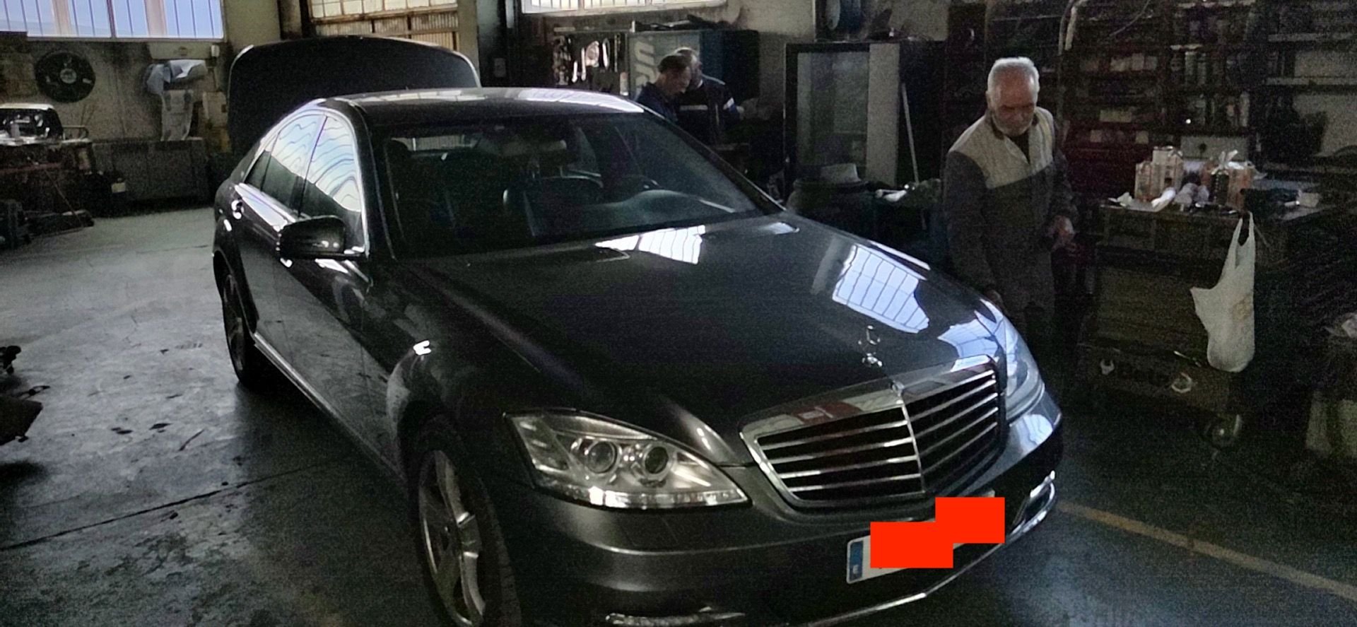

I drove the car to the body work shop (3km away from my home garage) and the car "drives", albeit with obvious symptoms of a slight bent frame (such as the ESP triggering under hard braking conditions). The body shop confirmed, upon performing measurements, that the chassis leg is slightly bent (pushed inwards), around 1.5cm. Which has caused the driver's side wheel to be pushed towards the door around 1.5cm, probably causing those issues I felt while driving specially while braking.
The subframe is intact, though.
The body work shop, has assured me that they will pull the chassis leg up to spec and it will be perfectly and safe because the bend is extremely small. Now, I am sure that they can pull it back to measures and probably get the car to drive as good as it did before. But in case of a second accident, will it be as safe?
This is my main concern, I understand that the bend is minimal, but will it affect the safety of the car?
Looking for your opinions and that of experts on frame pulling. Thanks in advanced!
PS: I see many of you are misunderstanding, the repair won't be a backyard repair where some random fella will be beating on the rail and pulling til it looks okay. It is being done at a reputable and licensed body shop in my country, and they have assured me everything will be done in accordance to Mercedes body repair manuals.
Nevertheless I am still slightly worried about the safety.

do Mercedes support straightening a bent chassis leg ? in today's world I doubt it - if they don't its very much totalled
that said plenty of eastern Europeans would consider that better than new - buy a bumper wing and bonnet from ebay and crab down the road at too fast a speed for the next 10 years
you will easily find animals r us - that will pull the leg out till is under 5mm wrong and claim they've been doing it for last 45 years and never had an issue - it helps when you just steal a car for spares and another 3 or 4 to get some extra wheels and tyres as they'll wear quickly

at 30mm bent it could be nothing if it doesn't have any creases - they are just going to flex in a half hour bit of bodging - if you then get second-hand, wing, bumper bonnet and light unit - especially if they can get the same colour - then 6k is more than enough
in Europe you get those bits for 1800 - the way animals do straightening that's just 100 - he could do it in 5 hours and put 2k in his pocket

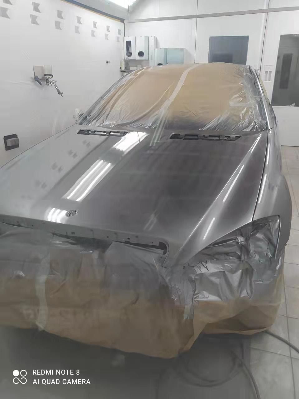

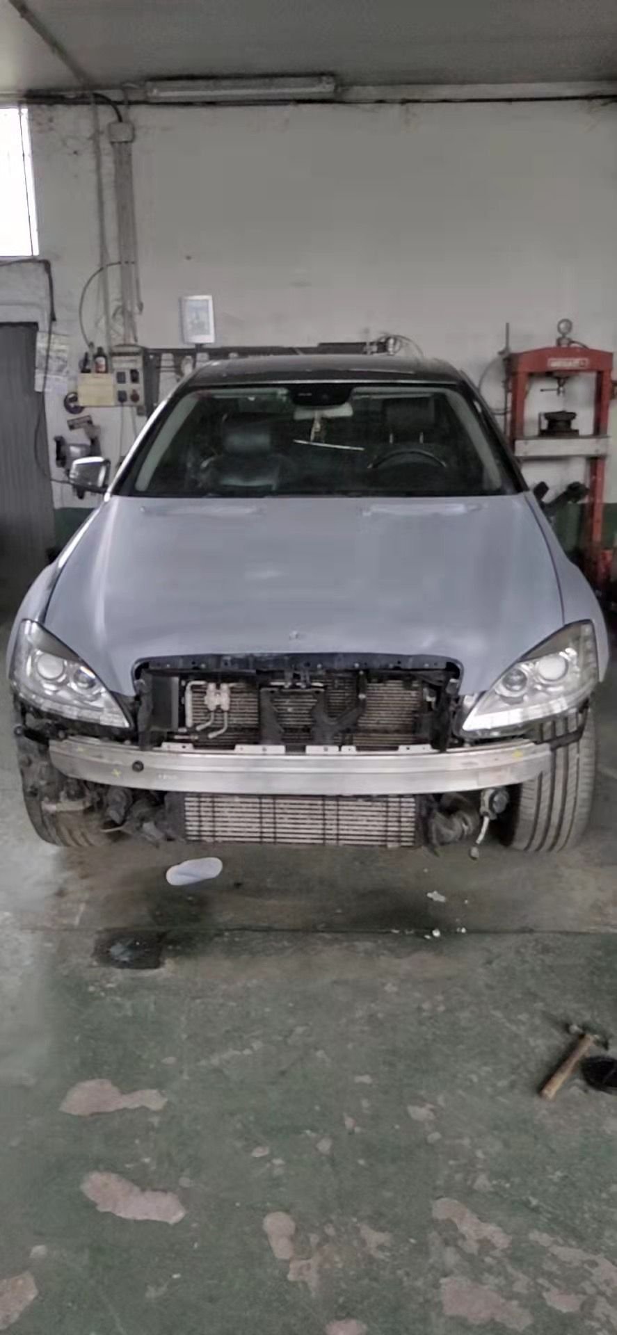

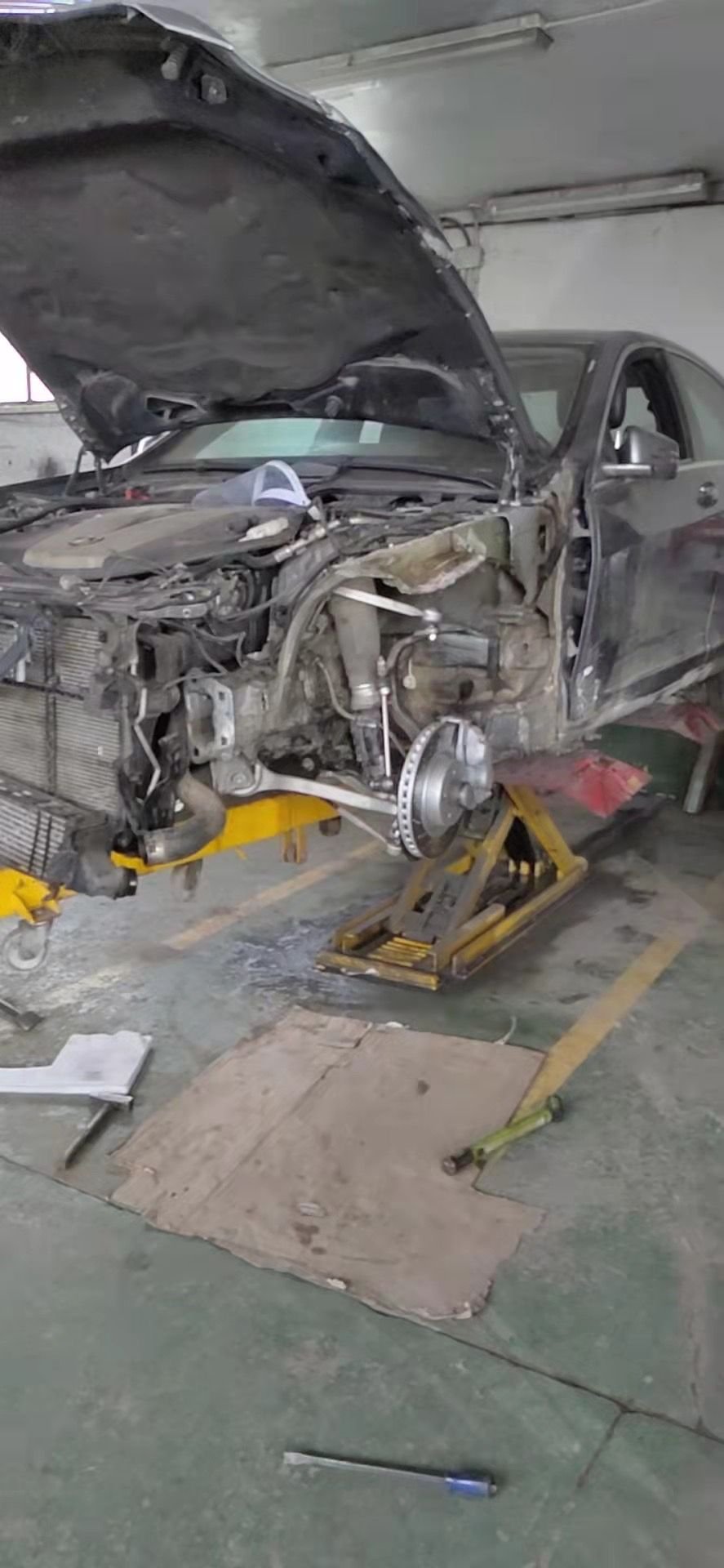

Photos of the repair process:
PS: In the last picture you can see the front bumper is not properly attached, because I lack one AC line which goes from the evaporator all the way to the drier unit, the one that is bolted to the frame leg, and it hasn't arrived yet. So I just put the bumper on to take it for wheel alignment in the mean time that AC line arrives and I will have to remove the bumper again.
