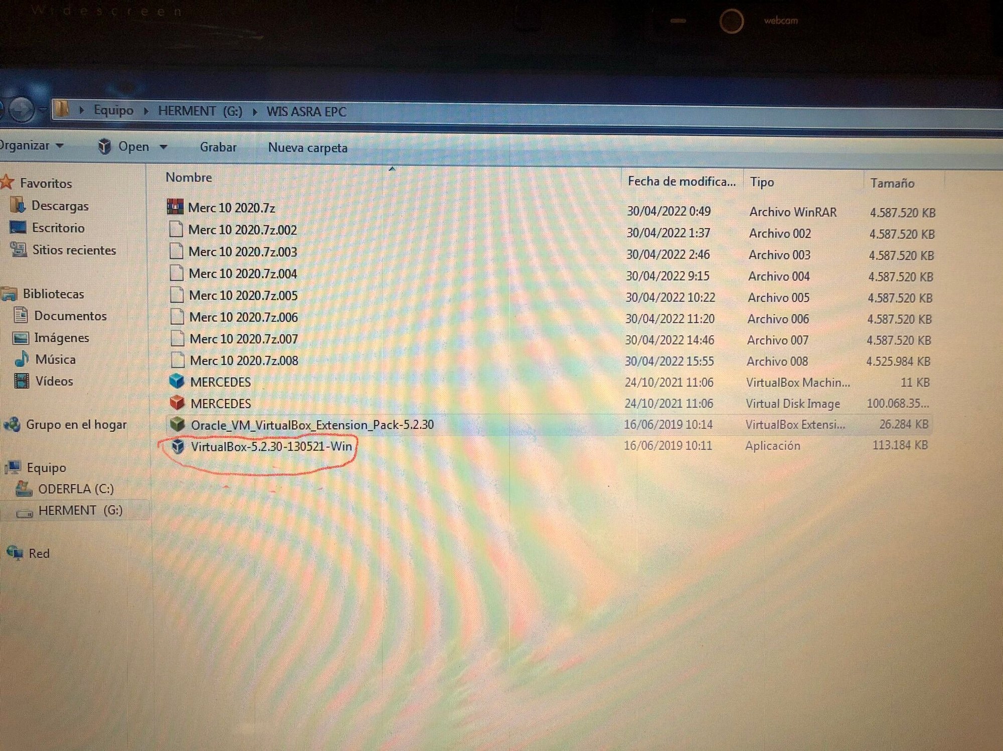

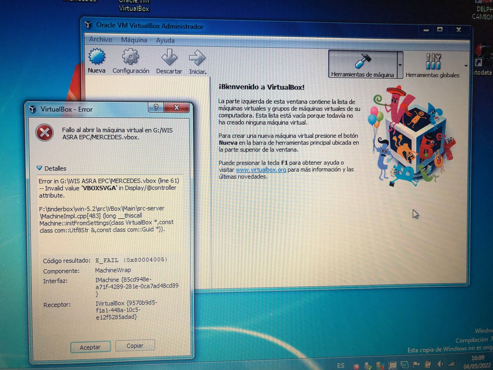

Hi everyone, I hope you are well. I wanted to ask for help on the installation of WIS EPC AND ASRA. A few days ago one of our colleagues called. SENETAT. He kindly gave me an EBAY link to a seller called GARIVE _5 who sold the programs. In the end, I get in touch with this seller and I tell him that I am going to do the installation on an external hard drive and he tells me that it is no problem that he sends me a link with the programs and instructions and I ask him if he can help me through of TEAMVIEWER in case I can't install it. he tells me yes. So I make the payment via paypal. and it sends me the programs, I do the installation, I install the virtual box and now when I go to open the program I get an error. I have already written many times to the seller and I have asked him to please help me to solve this error so that I can use the programs but I do not receive any answer. Anyway, now I have 130 GB of WIS EPC ASRA programs that I can't use. in short I do not want to think that this seller has kept my money. then it strikes me that in the negative comments on his eBay profile there are many users with the same problem as me. . I have already written to him several times but he does not respond. I think these things happen to me for trusting people. Well, I wanted to know if a fellow member of this great forum, which has helped me a lot, can install these programs for me. and if you have to pay for his service, tell me how much. Thanks, greetings to all. Take good care of yourselves, greetings from Spain.Attached photo of the error and the files that I have installed. thank you

Something recently happened to my program...I'm no longer able to access it. I get an error something about a kernel and Virtual Box. My seller (different seller than yours) sent me a fresh link, but I ended up with the same problem. I don't know what is going on...perhaps there were updates to Virtual Box that are not compatible with the programs we all bought? Are others still finding their versions working?

I got mine working again, and now know what the problem is, at least for me. The VM software was updated, and that caused my software to no longer work on any of my computers. I know it would make sense that if you deleted everything, and reinstalled it should work, right? But, no, it didn't and I tried on 3 different computers. Maybe it was a combination of new IOS software and VM software. What finally worked was pulling an old computer off the shelf, and reinstalling everything from the vendor, on to this old, unupdated unit. It works fine. I'm careful to not update this old machine. So, that was my key.
