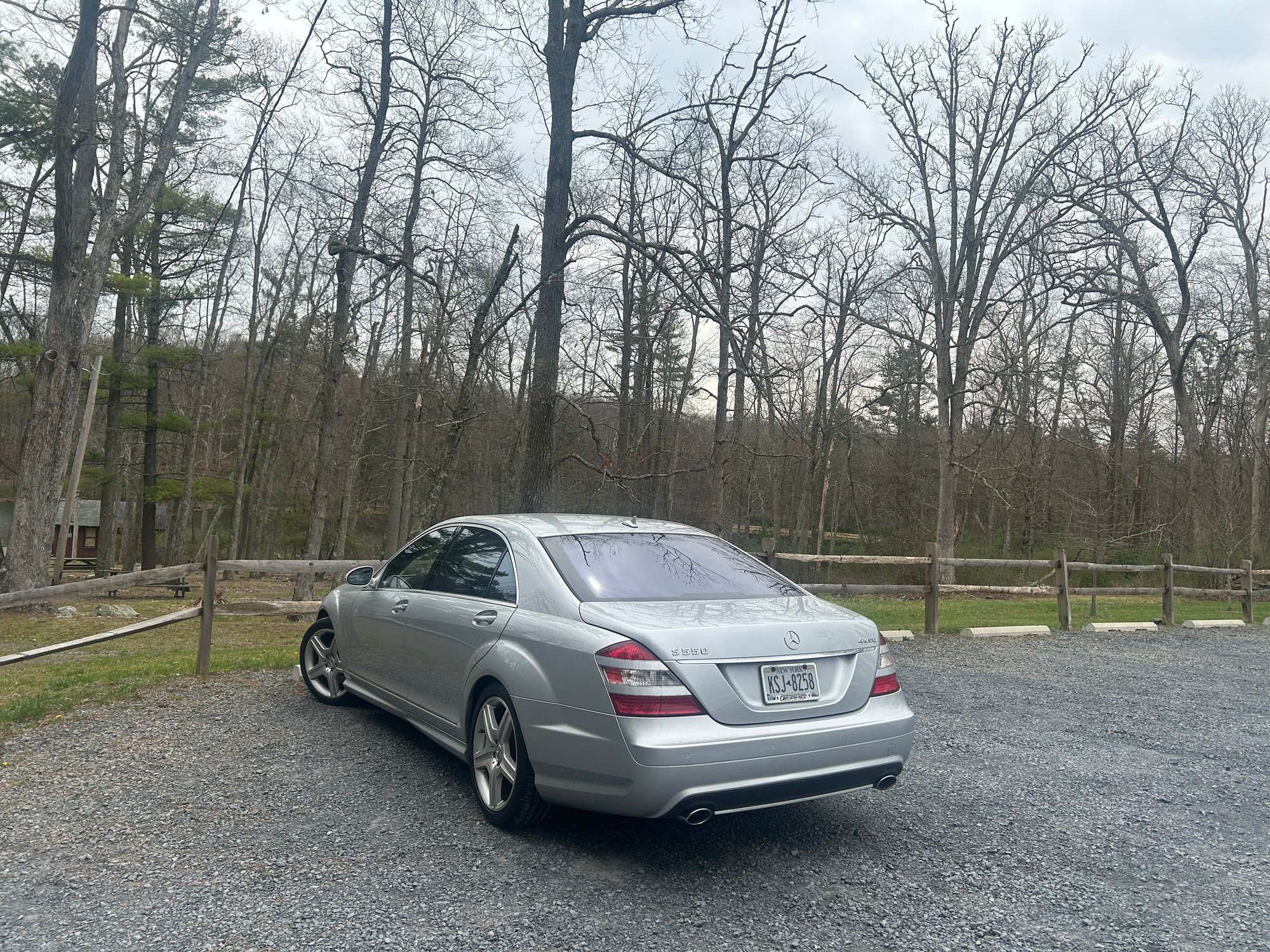

Just wanted to share some highlights that took place last weekend. It funny in a way.
We planned to go on a road trip for a 3 day weekend. NYC to Vermont and the Cape Cod. All this time we thought we would take my wifes Lexus RX. Its a more rational car, more economical, more reliable and more spacious for kids.
I've had the S550 for almost a year and really wanted to take it at least once take it on a multi day road trip. so at the last second I decided that my car we will take. Filled up the tank to a tune of $130 and off we went. I took a few tools with me. A hammer, 3 ton Jack, various sockets, FLOWER socket for the wheel lug nuts and the breaker bar for that socket, in case the tire blows up and I have to change it.
All was well, was getting 26 mpg, weather was perfect 75. Stopped in the middle of nowhere to use the restroom, gas station. Put some more gas and the car does not start. I start checking fuses, try to find the starter to bang on, nothing. I look for shops and by God there is one on the other side of the road. I neutral roll into his parking lot and we start seeing what the problem is. The short of it was, his son, is a MB master tech and he will come in an hour to look at it. 5 Hours later they fitted a new starter, $500 all in all. WE try to salvage the trip, kids wanted to be in a pool at this point. I was glad we didnt have to tow the car at which point the weekend would be ruined. Tow fees in 600-700 range plus Uber 200.
With renewed enthusiasm we hit the road and 3 hours later arrived at out hotel. Equinox Golf Resort & Spa by the way. Historical, beautiful. overpriced with horrible restaurant, but I wanted to check it out and kids wanted a pool.
Next morning it was gloomy and soon after the rain started. We had breakfast and went to Mount Equinox Skyline Drive. I was hoping for clear skies and great views but it was not to be. Dense fog with low visibility. At least the road on the mountain was brand new.
Once we were done with that, not wanting to go home, we decided to got to Cape cod, Martha's Vineyard. Long 4 hour drive trough back roads, my favorite type of driving. S550 was perfect and drove well, I had pelnty of fun on twisty roads, reminding how different todays S class is compared to w126 and w140 I owned.. Had amazing BBQ in Miller Falls MA and continued the drive. Last 1.5 hours of the drive the rain picked up again and was heavy. I was going 70 in the middle lane when I hit a pot hole and the front tire gave out. I was lucky to stop right under a bridge. At this point I was glad I got the right socket for the lug nuts and the breaker bar, so I got to it, hoping to heavens that every lug nut comes off. I put in a spare and resumed the drive. It was Saturday eve and a long weekend so everything was closed, I couldnt get a new tire. With a 250 mile drive back home I was worried driving back home on a spare wheel, with kids. Alone I would not give a damn.
I got lucky again. Nest day I found a tire shop who had the exact Michelin Pilot s3 tires in like new condition. 2 for $300. I begged him to re open on Sunday and help me out, which he did. So we went to Marthas, had a good day, hit the tire shop on way back home and continued our final 4 hour drive back home. Not only was the rim not bent, but the tire he sold me was like new and perfectly balanced. And I have one more in a trunk.
Overall, rather than be sour about it, kids were great and supportive, we looked at it as an adventure. 800 miles,. 25.5 MPG, $1000 in needless repairs. Fun all around.
Now the sad part. I cant trust this car. I cant take it far 300+ miles. Any of the air struts can go, air compressor, alternator and whole bunch of other parts. I always had used cars. Always took long trips. Never had a car let me down so much.
Now I get it, its old, thigs happen and if I am alone or with wife its ok, but with kids, I wont risk it.
Still love the car, love the looks, but not sure what car to get after this.
The end.
