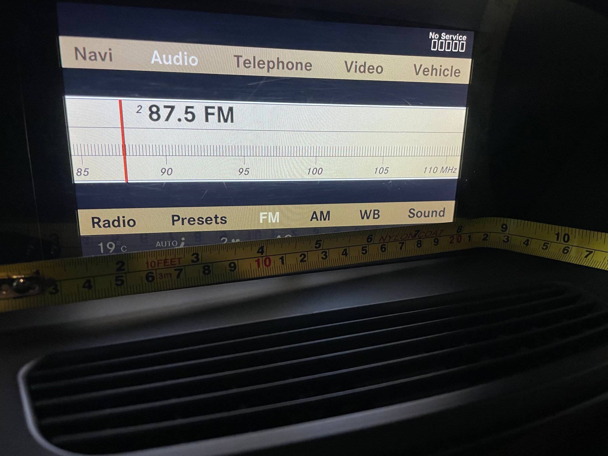

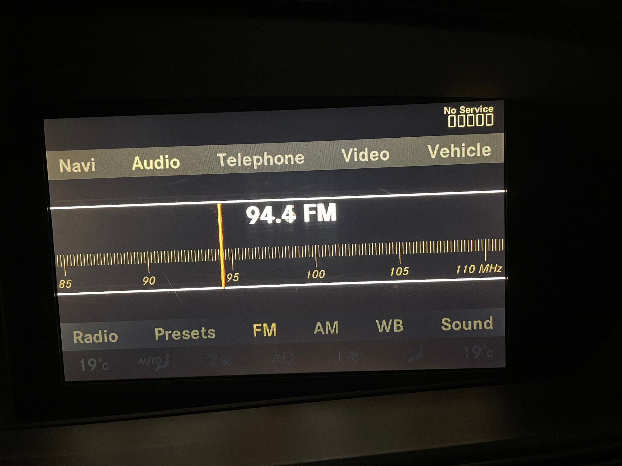

I have added a couple of pictures of my FM radio screen, so you can see the differences.
The FM radios in the Japanese units are also set to receive on different FM frequencies to this that we use in the Emirates, so
the FM radio is not able to receive any of the local radio stations and is of no use. This is why I added a third party ‘black box’

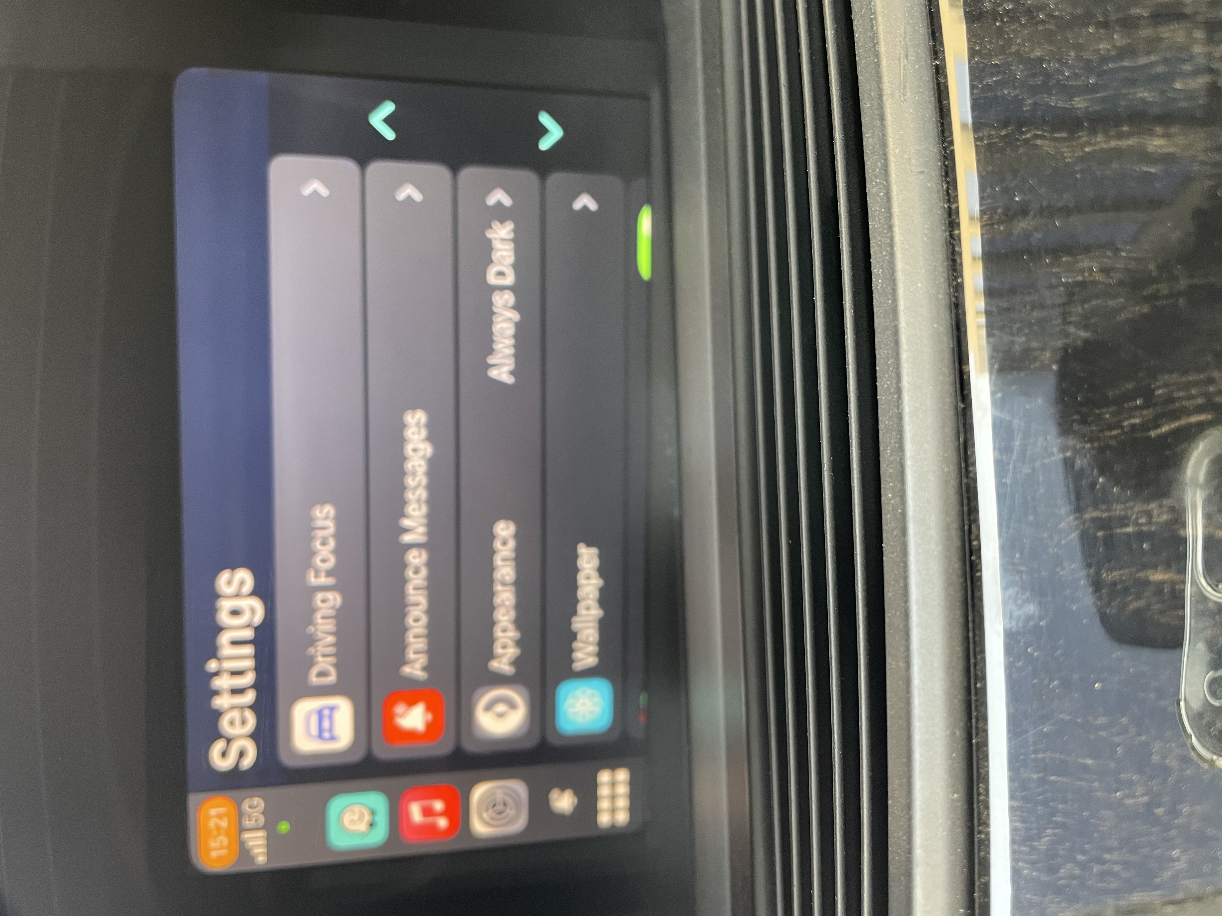

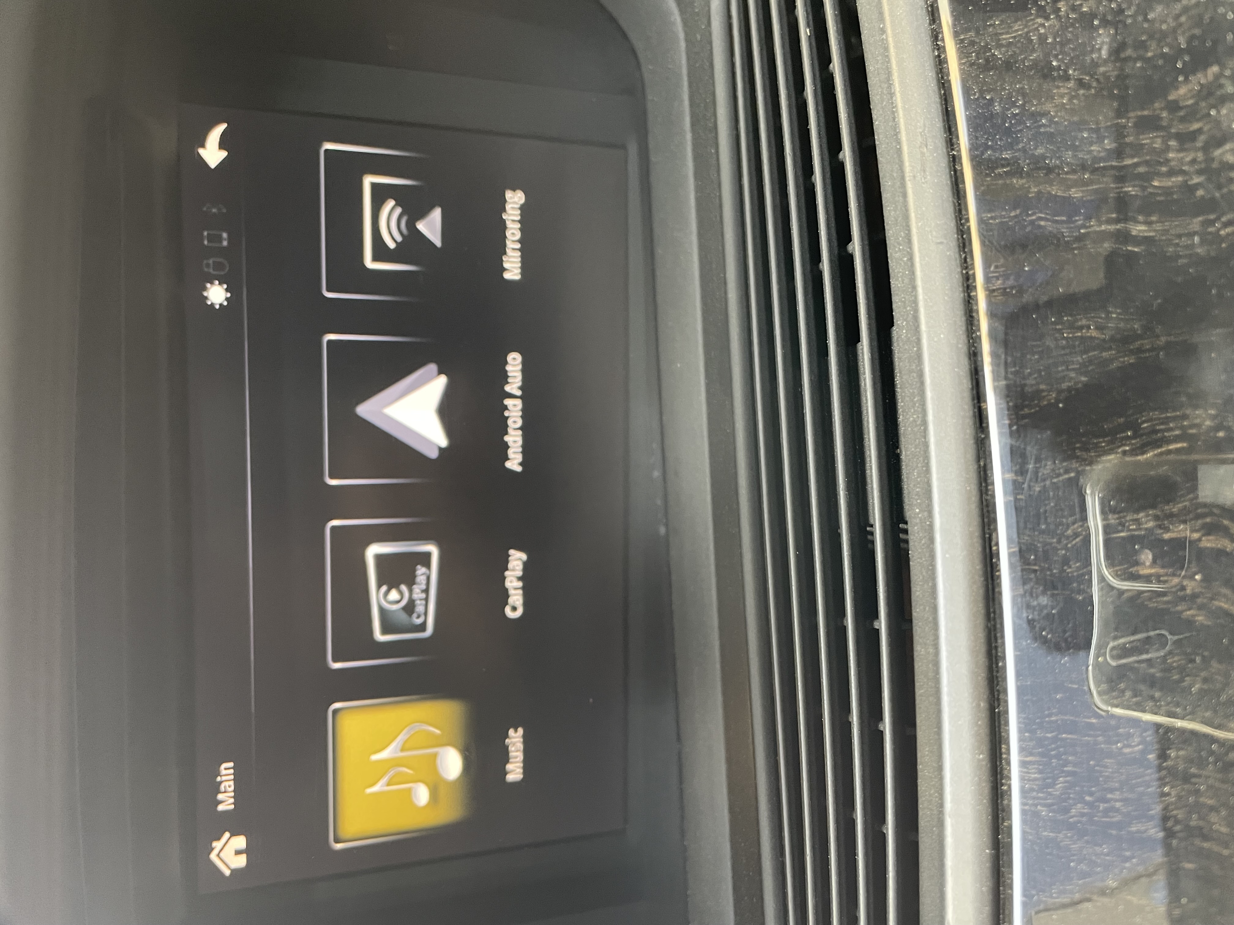

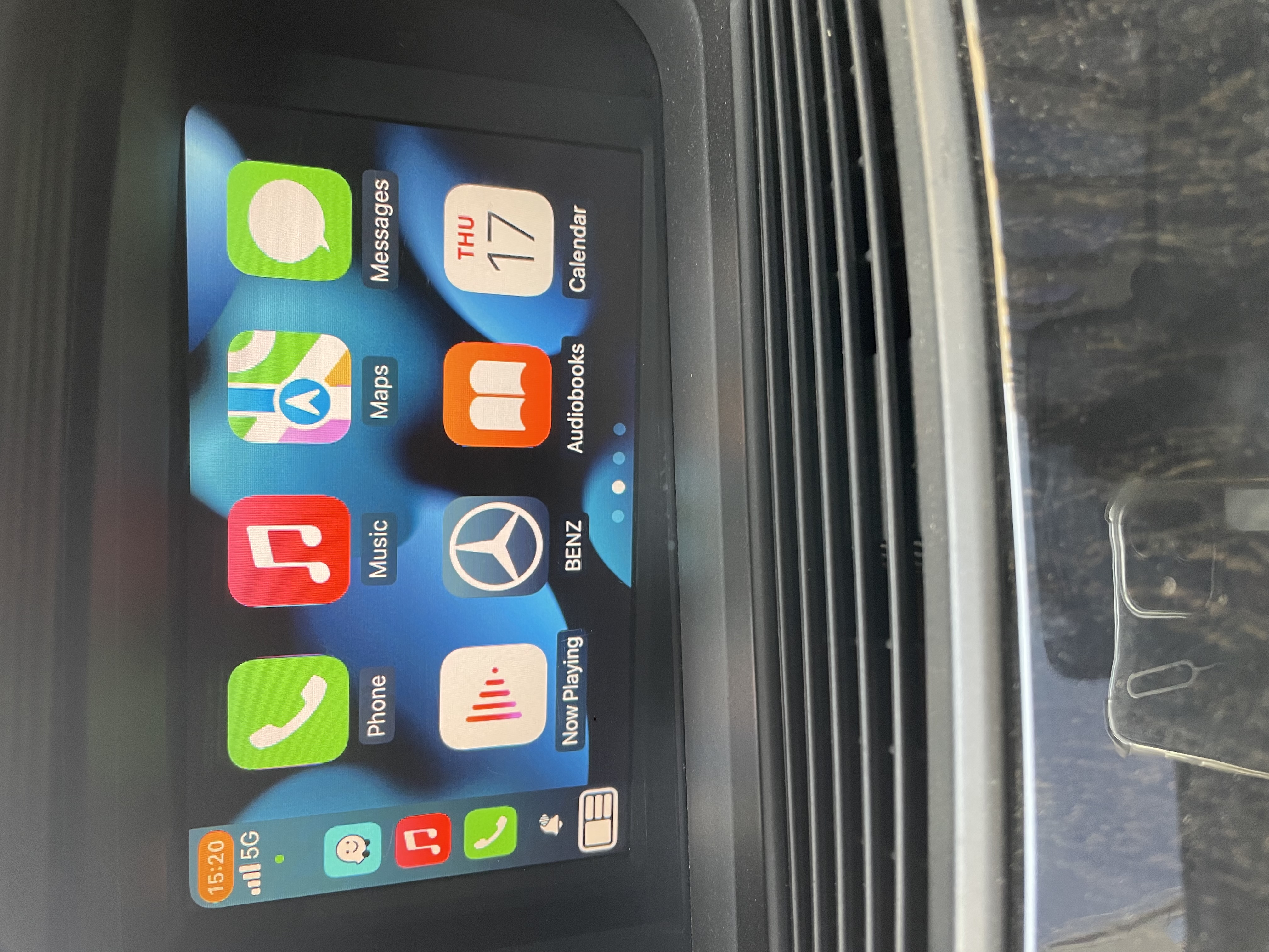

In terms of Apple / Car Play / Android Auto”
I had a LIMCET box installed behind the command unit by an audio store.
The whole thing, including installation took about 45 min while I waited and cost me about $400.
I now do a long press on the Tele/Navi button to toggle between the Command and CarPlay systems.
When I want to listen to Apple Play product, I select “Video” from the Command menu, BEFORE, I toggle into the Car Play mode. This routes my audio via my unused VIDEO channel to my Command / Car Speakers. If I want to use my Command system audio options, I choose whichever option I want via Command and then go back to Apple for navigation and maps.
Most days I select MP3 on command and listen to my own DJ free list of music via the Flash Card slot with an SD card inserted.
Simultaneously, I have Apple Play and Waze running so I can navigate to where I am going. It is a hybrid effect and both systems work well next to each other.
Attached Thumbnails Engineering mode-img_2526.jpeg   Engineering mode-img_2529.jpeg   Engineering mode-img_2521.jpeg
