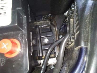

And, IT FITS (hence, I can say "Verified")…. The next bolt hole at the bottom bracket is "just right" for the AGM group 47:
That's the "hold down" anchoring the batt at the bottom in the batt compartment...

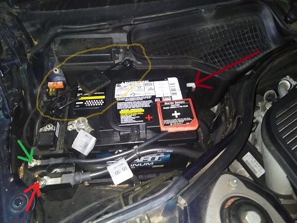

And the stock cables, although close to the limit for the (+) cable, work too… Verified!
Only, the top bracket (circled in yellow) won’t work-- BTW, it wouldn't fit my V4 batt (both Oreilly’s and MB) either, and had to be zip-tied at the rear… At 2 inches taller for the group 47, I forwent the top bracket altogether this time... The bottom bracket should suffice, even in a rollover…. The outside venting tube (right of pic) fits as well…
And for completeness, the red arrow terminal in the pic charges the boot batt; and the green arrow charges the starter batt, so you have to charge both... Took me over 7 years to figure that one out... LOL... maybe I wouldn't have been through 3 starter batt's if I had known that!!! I religiously had charged the boot batt-- which Could be the one that came from the factory!!!
