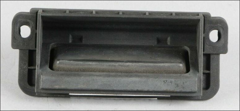

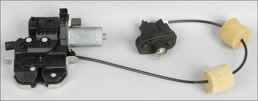

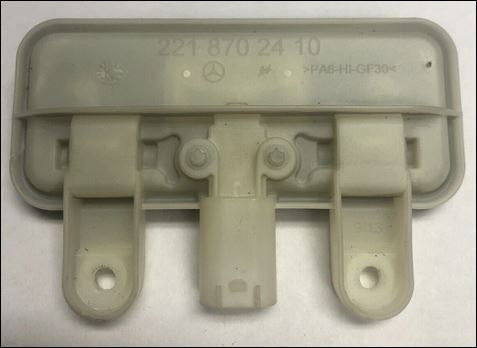

Anything’s possible but future reference try detaching/reattaching lock connection, CU, handle switch process of elimination in an attempt to reset. Trunk lock components:
