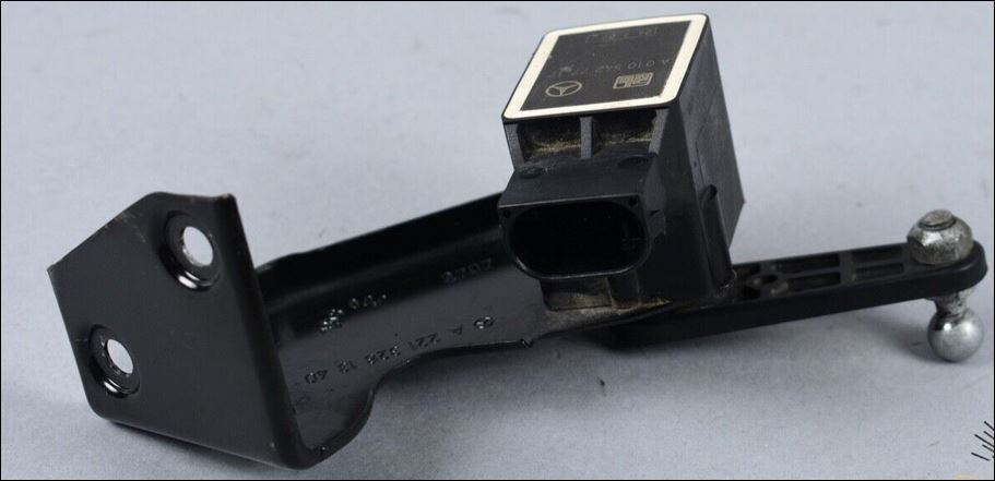

found a photo from professional diagnostics. but it is in polish, i translated it into english using google

Looks like a bad front sensor. I would still do the fluid flush and filter but it may be as simple as a bad sensor. If you provide the VIN, one of the more senior members can give you a sensor part number.
Keep us posted.

Check front left level sensor.
