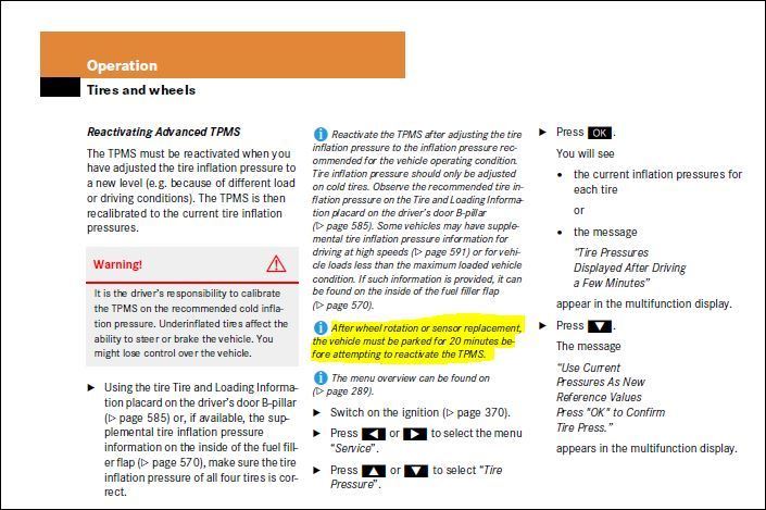

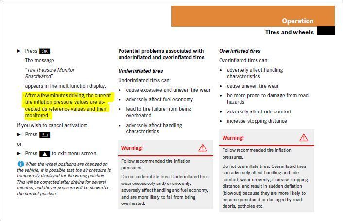

System should recognize sensor after IC reset.

above bit from konigstiger is about the reference threshold
I don't believe they auto learn a different sensor BT code or you could pick up another guy's in traffic
just about any Tyre shop should have kit to write the code - they have been on cars for 18 years - and many you code the sensor to match the car as its a simpler better method
