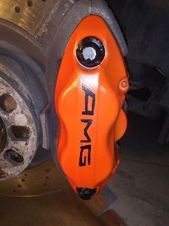

I dressed-up my brake calipers... Before and after:

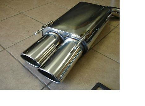

Then, I decided to add some rumble (and perhaps some power) to the V-12 with some Ebay mufflers. My thought was, the car is old enough that a little hot-rodding will not offend purists, and may attract more buyers, if I ever decide to sell...
Old vs New:
New look… Right is old, and left is new...

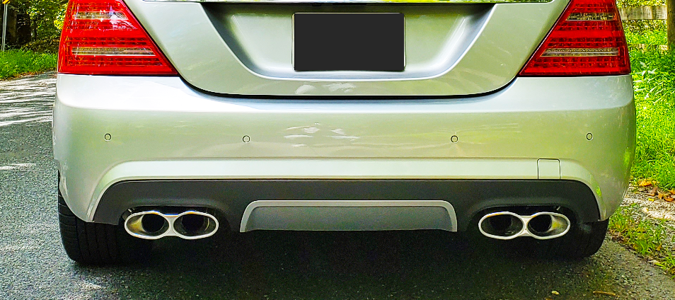

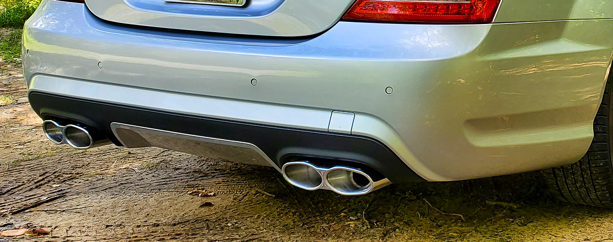

I had to cut out my bumper cover to make room for the twin ovals... The stock S600 outlets have some cut-outs, but this system needed more… I got some U-channel trim from Ebay for the edging…
I'm semi-happy to say, I didn't go overboard:

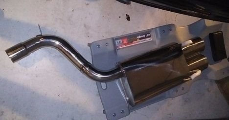

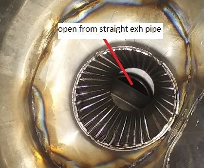

New pipe is basically straight thru... Looking straight down the barrel:
But, even with no pipe at all-- I started the car with the old muffler cut off-- there is not a huge difference. It seems the twin turbos basically act as mufflers! A point BenzNinja made in post # 10 in the AMG link posted above…

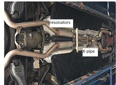

In fact, it’s my opinion, now, that deleting Everything (resonator and muffler) would probably be okay on the V-12!!! Here’s the S600 like mine (mufflers-- what I replaced-- not in photo):
And, here’s a 2008 S65 from Ebay:
Note, no X-pipe, and 1 into 2 muffler, basically straight thru from the cats-- at least that's what it looks like in the Ebay pic for the S65…

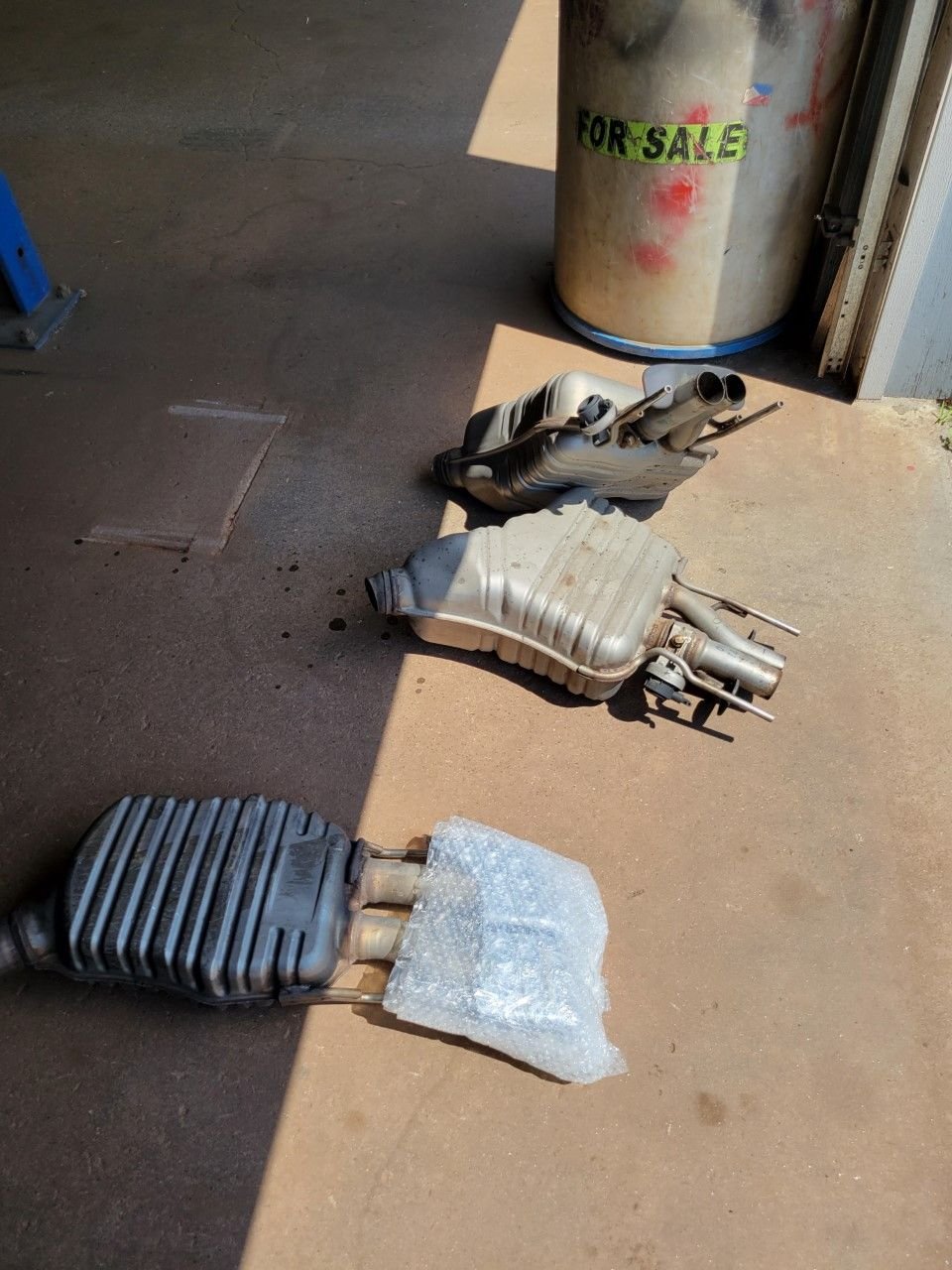

Here’s something for V-8 owners: I have left and right side used V-12 mufflers for sale cheap! (See pic above.) You’ll have to cut out part of your bumper covers for the V-12 ovals, but I have the trim for that as well… Here's the normal S600 tips:
Keep in mind, shipping won’t be cheap, but if you're coming to South Padre Island, Texas any time soon, you’ll get a great buy… And, based on what’s been said in other threads, the V-12 mufflers may perk up the V-8’s sound. The idea being, the TT mufflers are more open than the normally-aspirated V-8... don't know for sure....

This is my black one with just a muffler delete and then I cut the tips and added amg tips.
Now with the full S65 exhaust on my silver one, it's just perfect.
I think the exhaust tips look a little out of place with your bumper, but that's just my opinion.
The oem calipers are so small on the S600, drawing attention to them would make me question why a V12 with such small calipers. I changed to the full front and rear AMG calipers/rotors which was a simple swap with no modifications needed. Bought them on ebay, cleaned and stripped them and painted them. Very inexpensive and gives the car a completely different look.

As mentioned, this started with a flat tire, and while I was waiting on the tire, decided the unpainted calipers were fugly. So, I just did some touch-up with everything installed.
Real 2008 AMG calipers would be the way to go, but I wasn’t into that much work... Also, I don't know what to do about the single piston rears (other than go full AMG). I’ve seen some fake rear covers on Ebay, which may be okay for the cosmetics. Anyone tried those???
I have no complaints about the “small" calipers on the 600. I’ve opined about the single calipers on the rear, but I assume Merc knew what they were doing with the mismatch-- the car stops as quickly as an RX-8, which is no slouch... The 600, as equipped, has uncanny stopping power for such a heavy car… I like “cool" looks, but I'm more into function... (and minimal effort…) AMG calipers are overkill for me, and I’m more than a 1000 miles from any mountains and don’t have a "legal" Autobahn. (Don’t tell my car that…)
