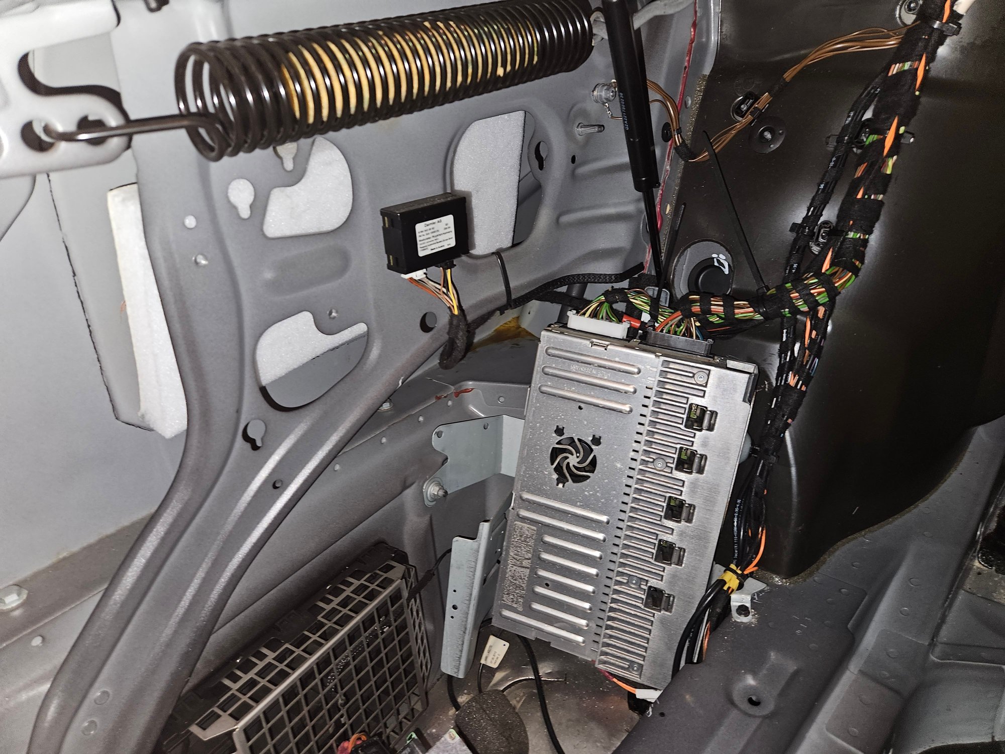

Guys, I purchased this car a few months ago and found it had no audio. I thought it was just the amp. I got a used one from ebay and it didn't fix the problem. I finally went ahead and got a fiber optic loop from amazon and well, when I got into the trunk today to test out the three modules, I realized something was off... there is literally no voice control module in the trunk. I thought it would be easy enough just find the plug for it and loop it to bypass the module and get audio back. Well.... i cant even find a harness for it. Im dead serious.
my question is, where do I begin l? Do I need to buy the whole harness? Im assuming it will connect the head unit and all of the modules.

I thought it was a silver box mounted next to the amp. Thats what I've seen in all of the videos I've watched. Are you talking about the little black box?

In every video I've seen, it's been up high next to that little black box on the other side of that metals "wall"

Seems like in my 2008 it was in the piece of tin to the left of the amp down low. Can’t miss the fiber going into it.

Am I missing it in the photo I posted? My question is if it's not there, where is the harness? I hope they didn't cut it because I'm assuming it's a loop with the other modules and the radio all connected.

behind the rear seat.... I was looking a while back at photos online, seems they used over the years three different modules - but I thought every one is left of the Rear SAM under the seat pump

? So do you see it in my photos?
Old Dec 8, 2023 | 09:28 AM
BOTUS's Avatar
Joined: Aug 2014
Posts: 5,315
Likes: 1,672
S500

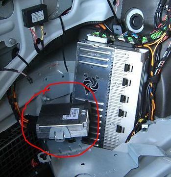

no - its not there and as far as I know never was... the pic u have is the left rear wheel arch.... according to this link, people say it a small bit in front of the Amp - but then he has another pic saying where I suggested in post #8
https://mbworld.org/forums/s-class-w...tion-help.html
two says the bit you want is the red circled module here
So is this part of the SOS rubbish - rather than the Linguatronic module?

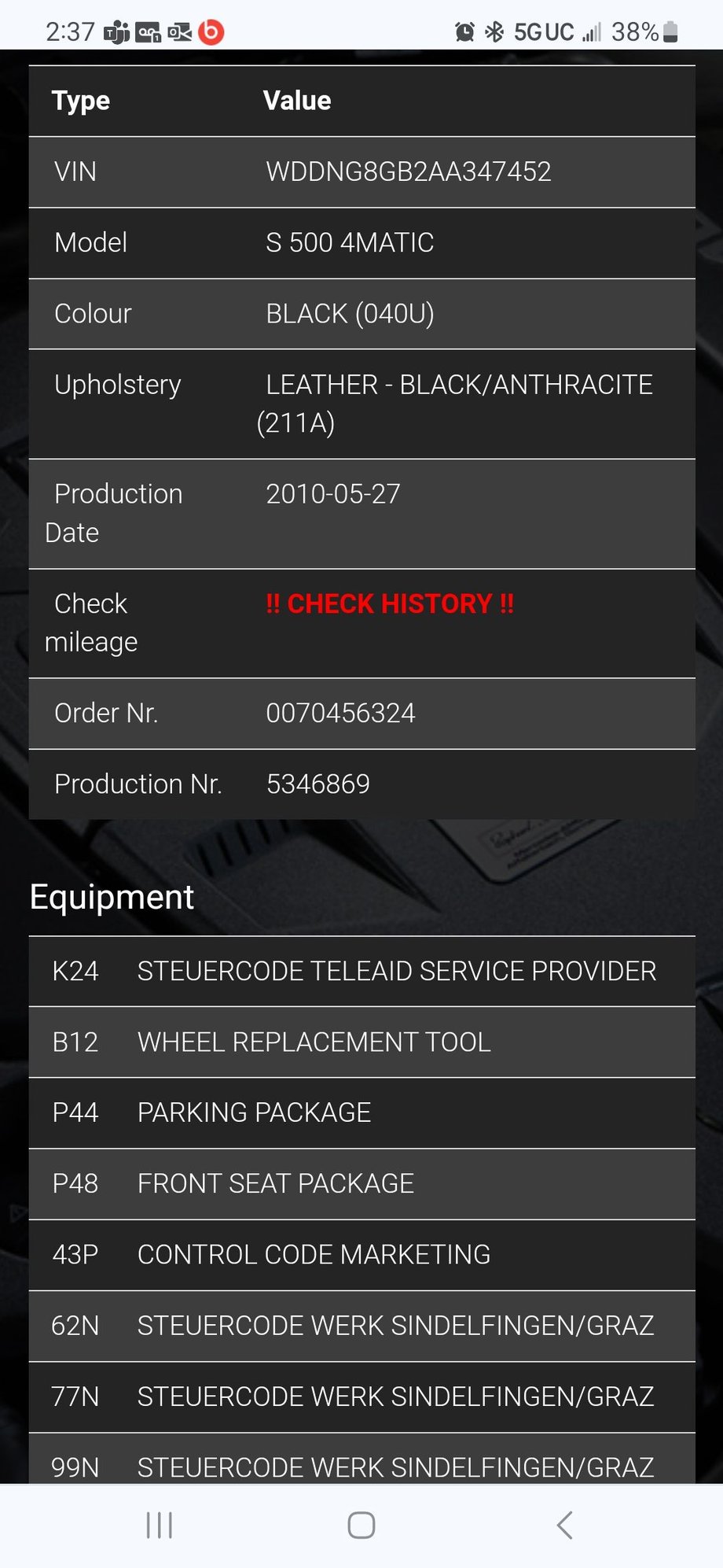

this is why the vehicle data card or a bad chassis decode effort (from link like the one below) really helps the next owner know what they bought
you must remember the people who can buy high end cars brand new, are total idiots with no brains and no clue about anything whatsoever - so the spec you get secondhand, is usually the first bloke wife opting for something no car should ever have, and what the sales guy could con the idiot into buying, or worse still, the bundle of inappropriate rubbish the manu got cheap from the supplier - and thus not what any self respecting car needs
https://www.mbdecoder.com/

Botus, I like you already. I can tell you shoot straight. Here's what I got. I notice it says s500 and not s550 4matic. But that's the badges I have🤷🏿‍♂️. So does this car not have a voice control module and only an amp and satellite radio module?

had it been in order.... could have easily looked for 813 LINGUATRONIC (VOICE OPERATION)
No never had it
