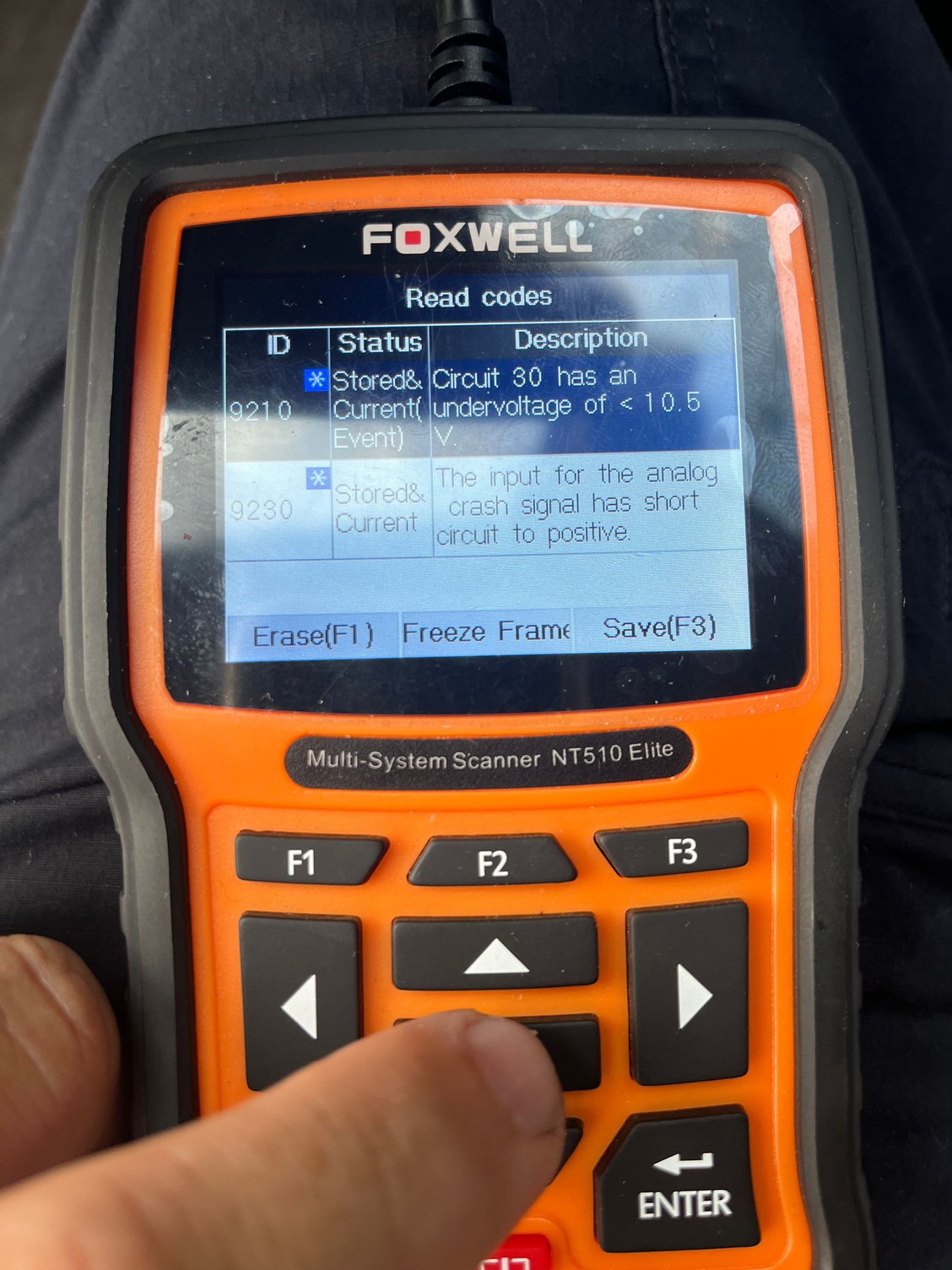

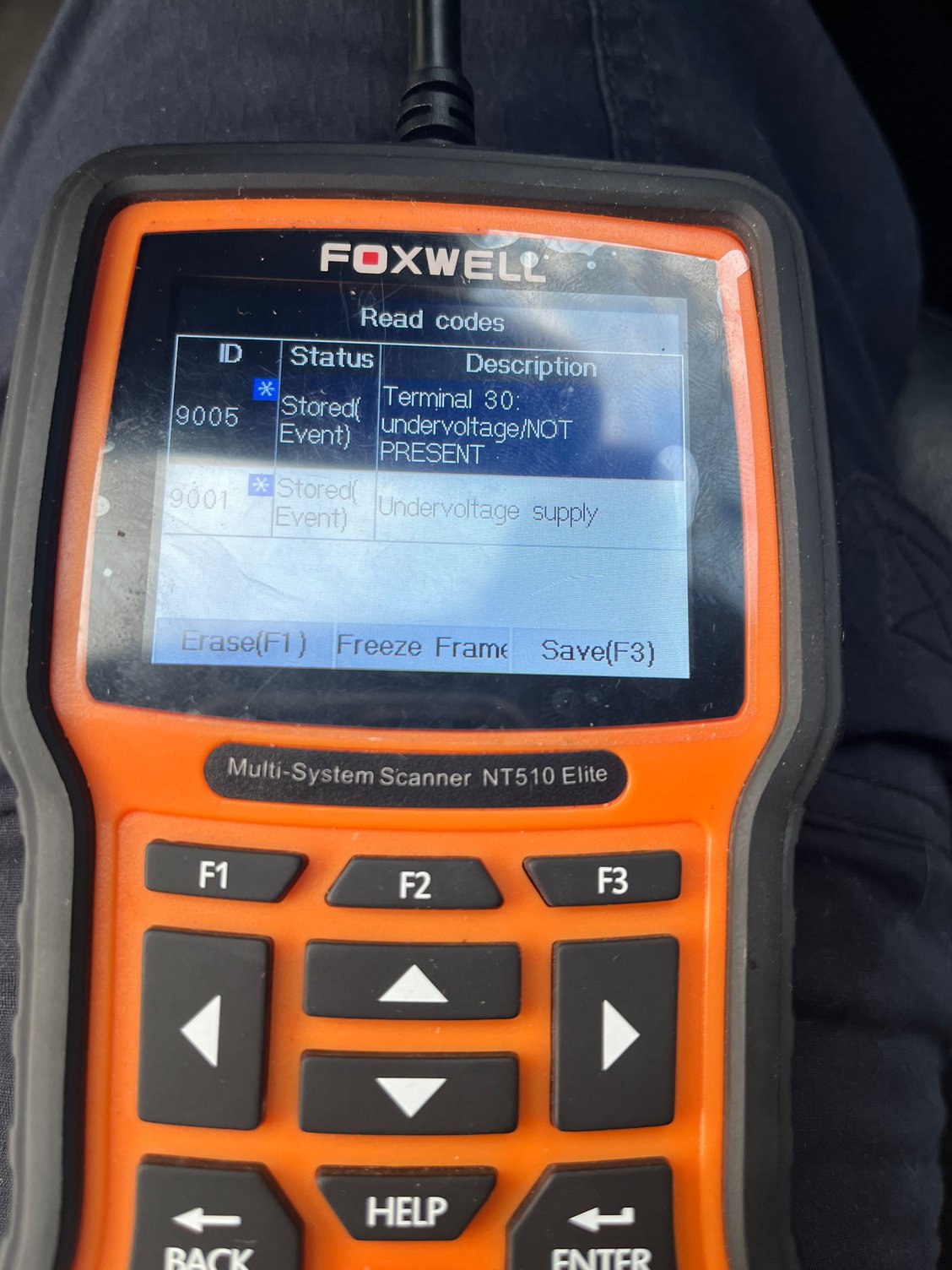

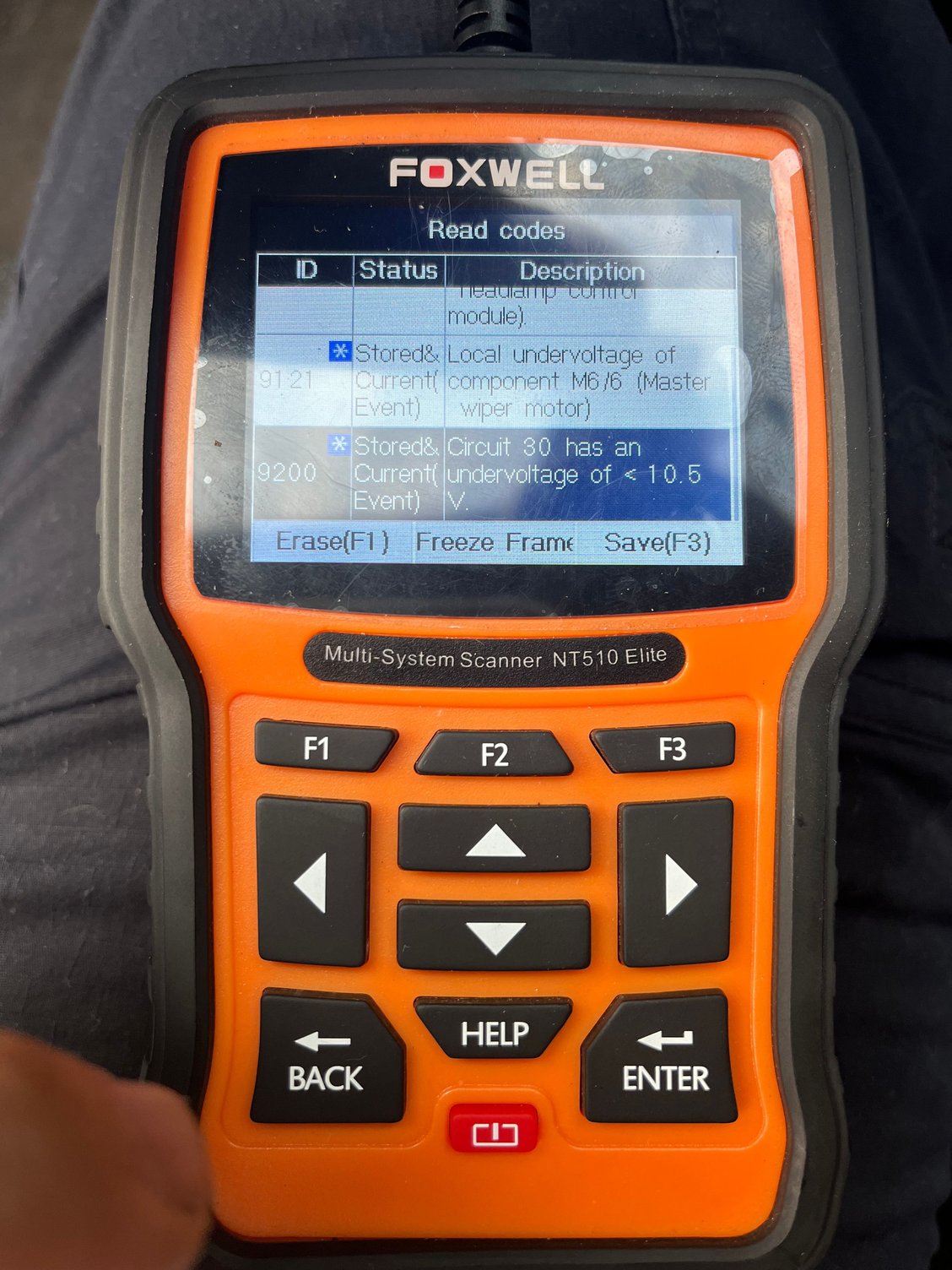

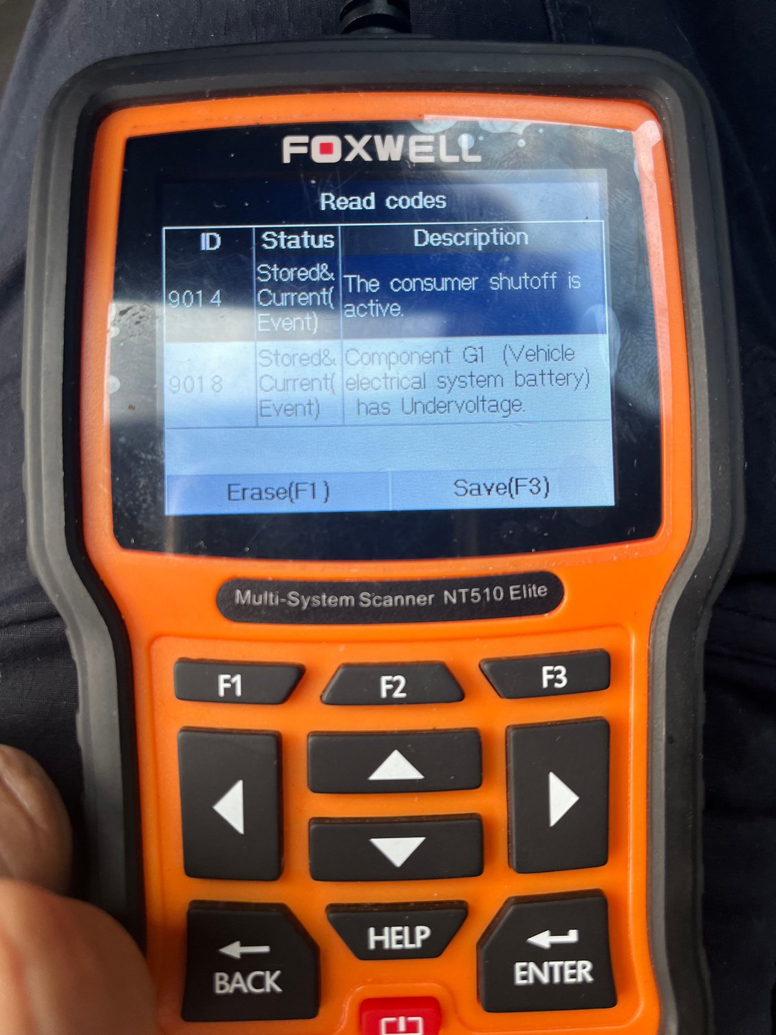

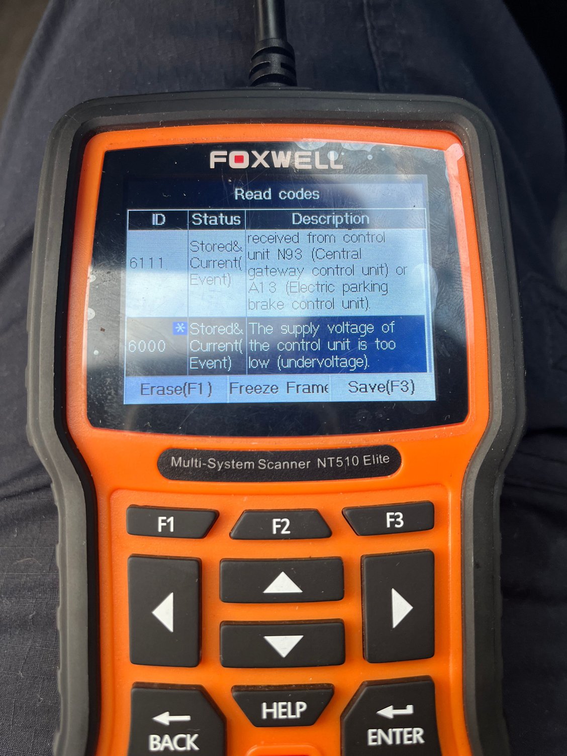

I am getting super frustrated on trying to figure out why my car will start after several attempts and then the next morning I go to try and start and no go. Battery tested front /rear battery and they are good. Alternator and starter under 2 years old. I get codes of under voltage. Any help would be great. Once started I rescan the car and still get codes. The negative terminal cable clamp is loose and I am going to replace it but I am really tired of this car.

replaced the negative terminal cable and thought it fixed the issue. The car started no issues ..This morning tried to start no good. Scanned the car and got codes for low voltage but checked the batters they are fine. I cleared the codes and the car started right up.. I need to figure out which code gets erased for it to allow it to start up
