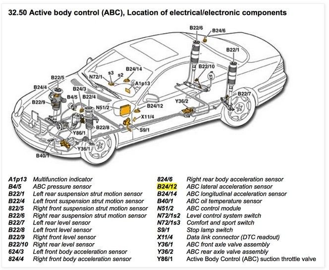

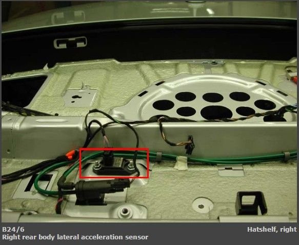

Originally Posted by BOTUS
the speaker grills come out and there the top of the strut
In my 2012 there are no sensors on top of the struts. Just changed rear left strut and checked.
if there are sensors at the top of struts (close to them) they must be on the shelf that needs to be opened for access.
I wonder if this bit is like Air tragic level sensors - ONE rear sensor and TWO front
http://mercedes-abc-drive-carefully.blogspot.com/2014/08/overview-abc-system-isthe-key-part-of.html
