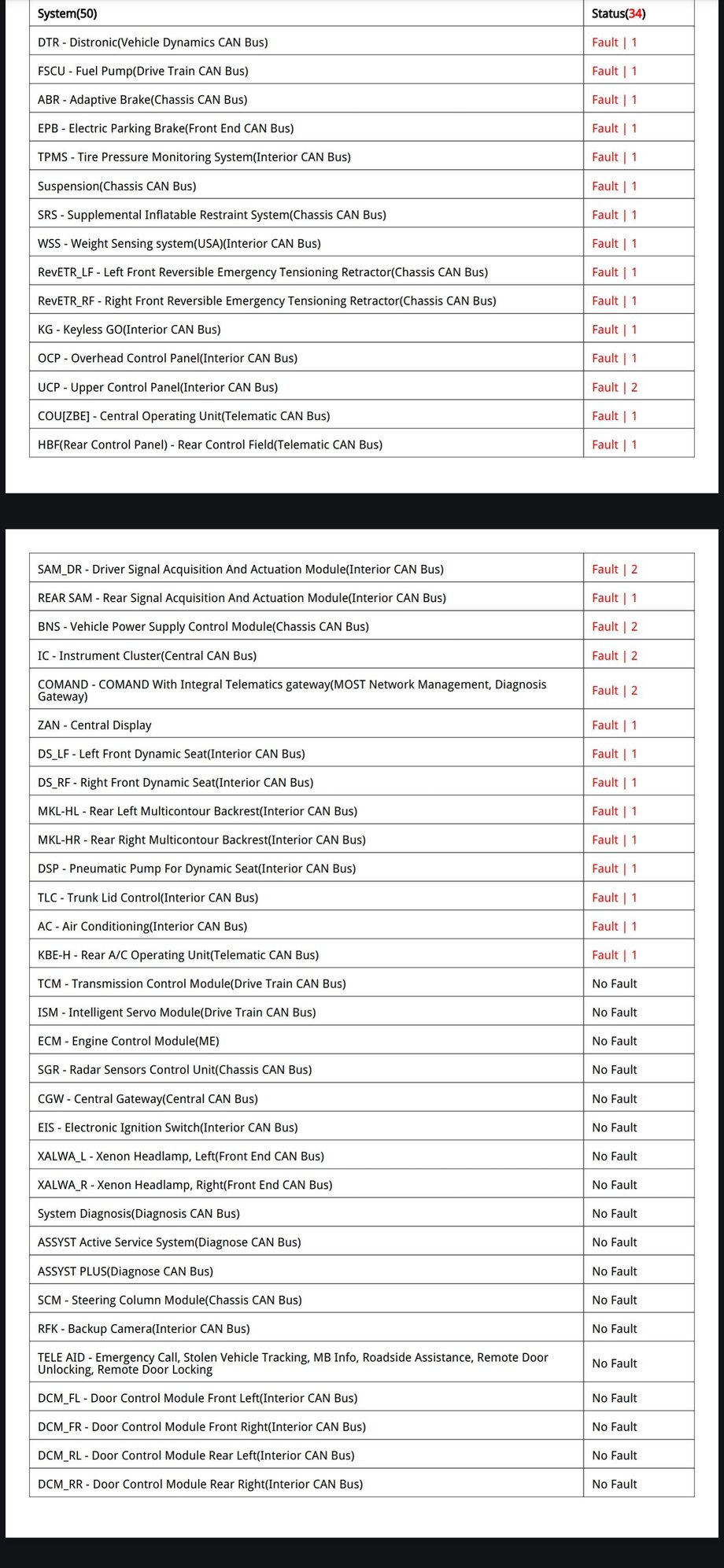

It started showing ABC malfunction on the dash and occasionally while driving the front suspension will move one way or the other. There is also a message that says active headlights see owners manual on the dash. Another error message will come up on the dash but only when you try to activate the cruise control and that message says distronic see owners manual. Here are the codes it's throwing.Any suggestions based off the codes is appreciated. Thank you.

I apologize. I meant to mention that I replaced the 12v battery a couple months ago. Would the four sensors not put out some codes? I did not check the battery in the trunk. I looked for the small auxiliary battery in the side of the dash but do not see it.

You have multiple errors at the same time. All these modules/sensors do not fail at the same time.
Check/replace the AUX battery. When it fails you get several modules fail.
I don’t have ABC but when my AUX battery goes out/low I get DISTRONIC, ABS, LANE KEEP and EMERGENCY BREAK systems errors.
When it first happened with my 2010 E550 it was when the first cold days came.

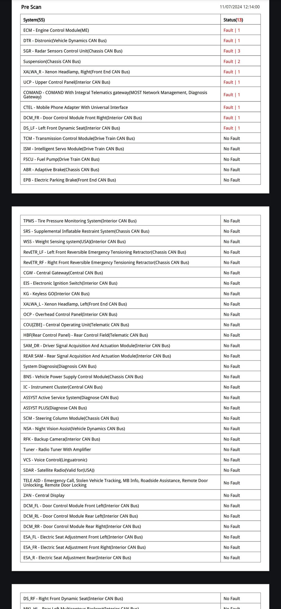

Thank you all for the help. I replaced the battery in the trunk and that cleared multiple dtc. I am left with these codes now. I don't care about the mirror, distronic, or headlight codes. I am mainly concerned with the ABC Malfunction and the front of the car moving around while driving. I see that the front passenger acceleration sensor has a problem. Could this sensor be causing the ABC issue?

Yes, quite probably. Replace that sensor but also do a filter and green Pentocin fluid replacement for your ABC. Examine the old fluid for dirt. I would also visually inspect all the ABC hoses for any wetness or seepage. They are under huge pressure and need to be monitored and replaced periodically. Good luck and keep us posted.

So I called Mercedes and asked them to look up the part number for the right front body acceleration sensor. They gave me this part number 000-905-65-02. I looked under the hood and found two sensor looking parts above the the two struts that have a coupler plugged into them like you said. Next, I called a shop that works on Mercedes and the guy told me that the acceleration sensor is like a $4000 part and that the one I was told about is probably not what I need. He asked what scan tool I was using and said even though the Topdon I am using is good, I really need the Xentry system because the Topdon could be misleading me. Does this sound right?

I appreciate you looking that up. It looks like the part number you found is the same thing as the part number they gave me just an older part number.
TO answer you, no it's not all four as far as I can tell. Plus the Topdon only reported the passenger right side I think.
I guess it would be worth trying to replace it for $106.60 and see if the ABC malfunction goes away?
