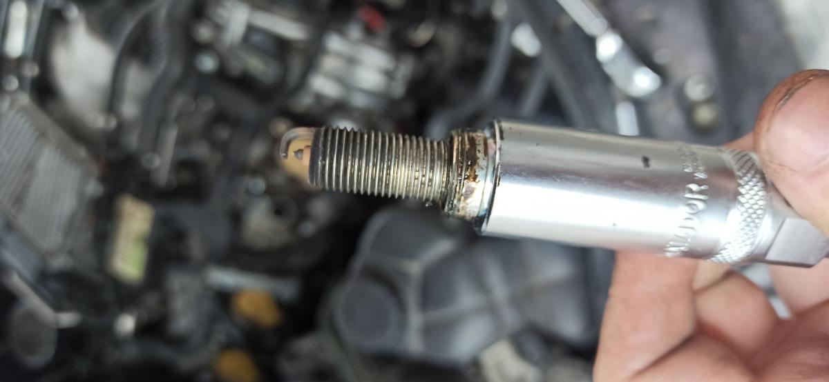

sparkplug cyl 2 (before swapping)

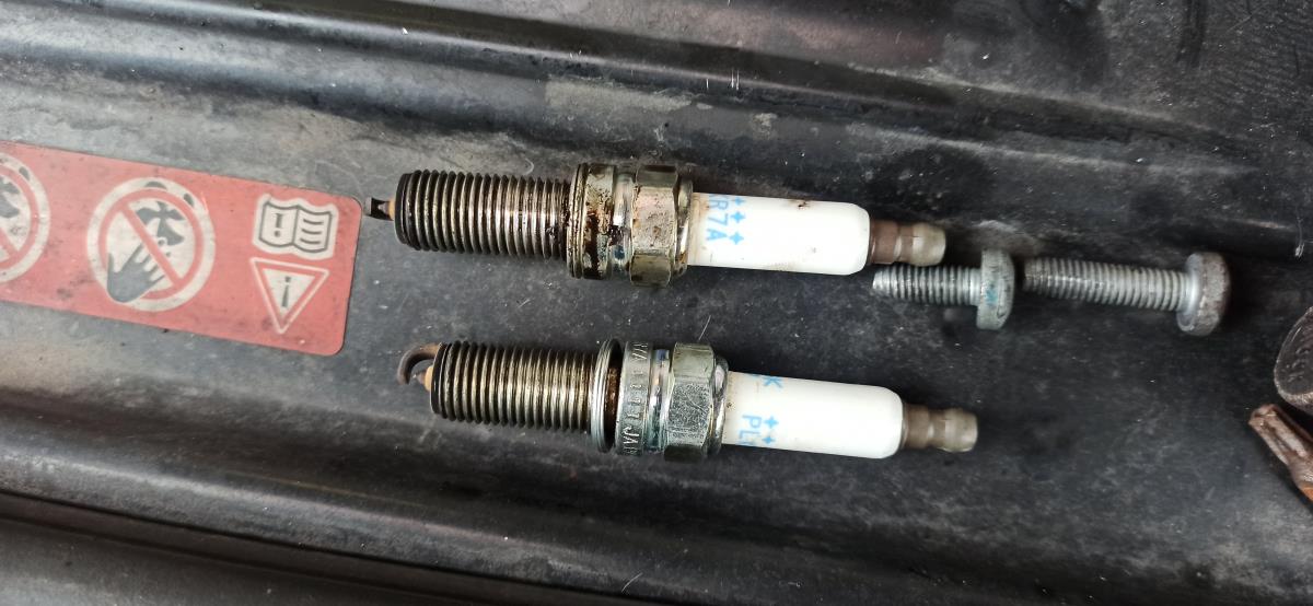

sparkplug cyl 1 (bottom) cyl 2 (top) (before swapping)
https://i.gyazo.com/f145bb232f35c186...ff60ef54f6.jpg
Cyl 2 spark plug was oily, the seal between the valve cover and the spark plug appears to be leaking a little, but this is unlikely to cause misfiring (even after swapping the spark plug and coil), is it?

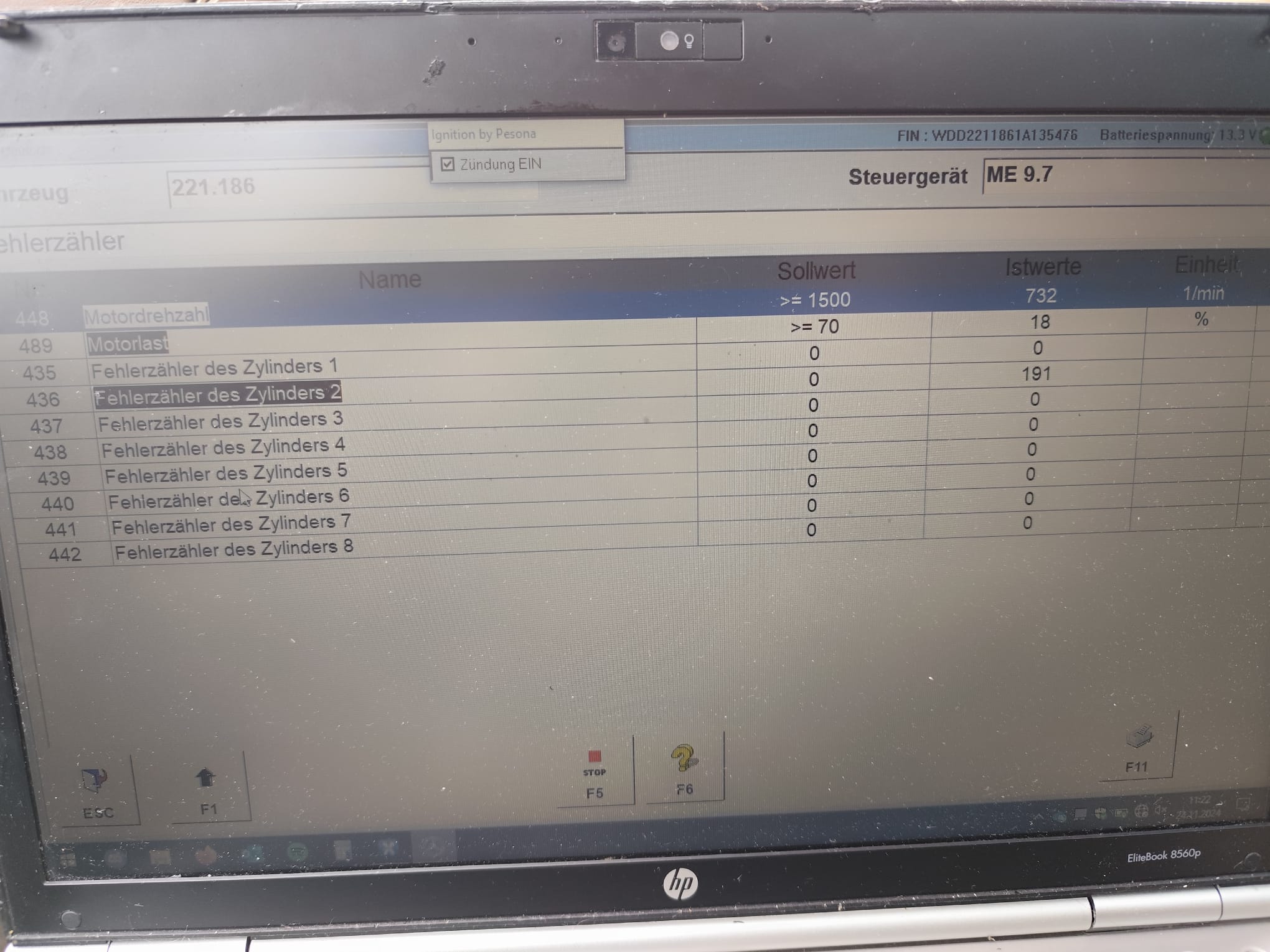

misfire count
https://i.gyazo.com/d33f41442c9742aa...69d5ccc039.jpg

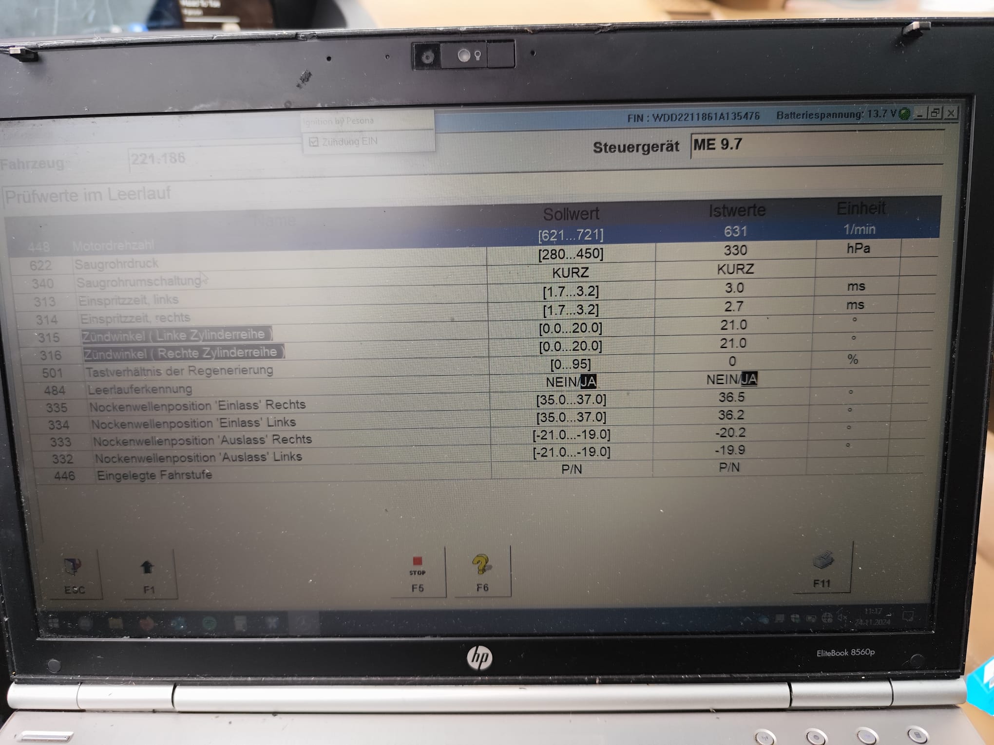

camshaft and ignition values

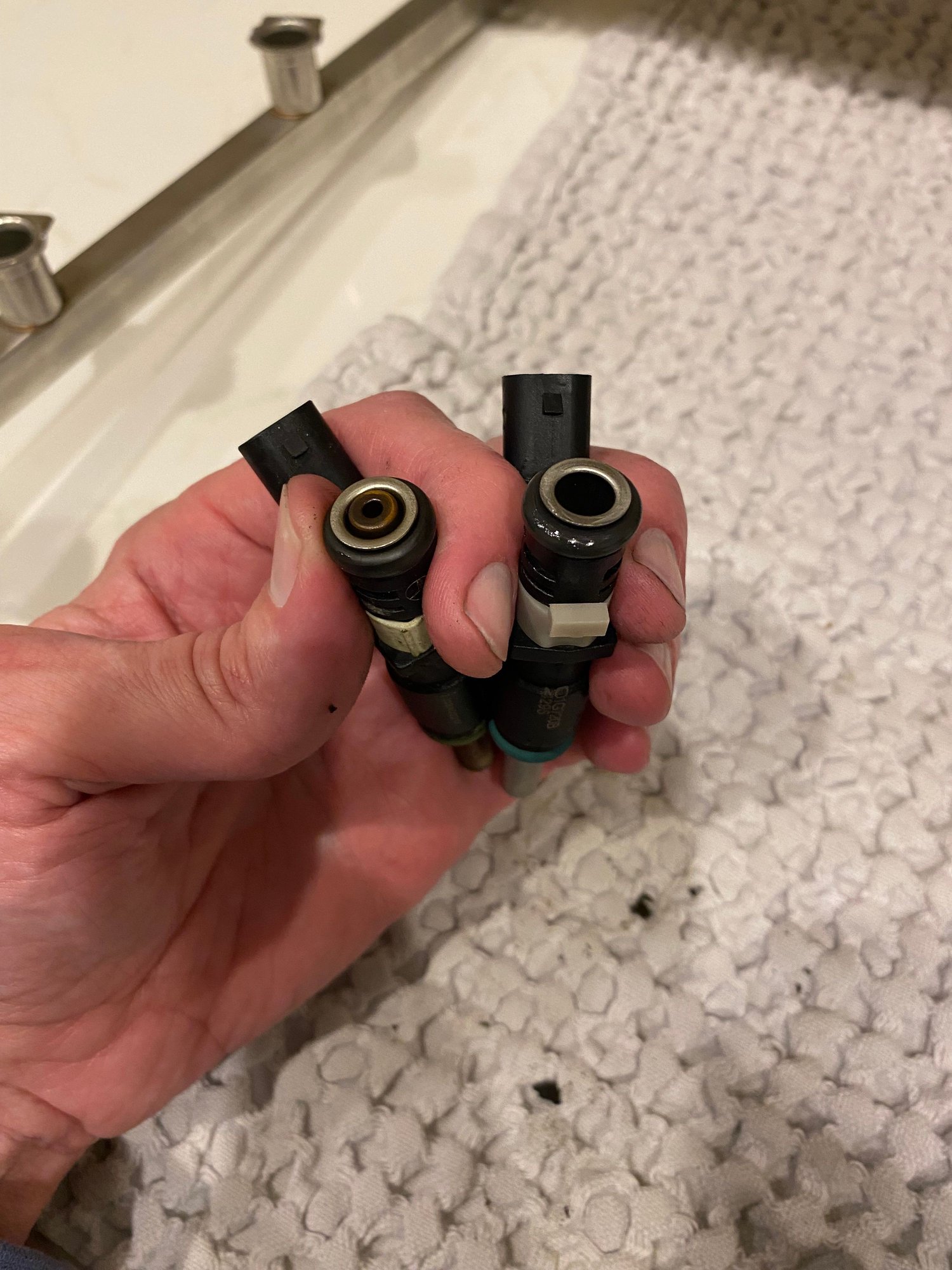

I thought I'd post this here on this adjacent topic rather than creating a new thread. I'm putting in new fuel injectors in my M273 using new Standard Motor Products injectors. Of the eight I bought, four are missing the top brass colored port. I've not done this job before, and don't know what to make of it, other than that brass port on the OEM old ones and four of the Standard new ones is probably important. I watched an FCP Euro video carefully, and it appeared their parts on a Mercedes video also did not have the port. Can anyone clarify what it is, and confirm it should be there? The Standard part numbers were all the same and otherwise identical.

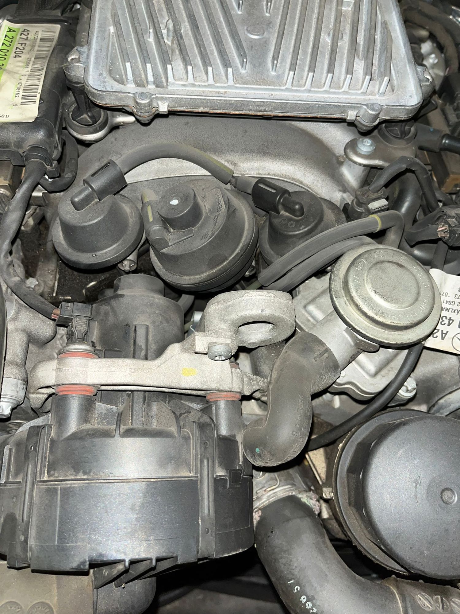

I've tried checking the intake piece but I can't see much. What I have been able to observe are oil leaks in that area.

those links to the inlet trumpet switching are so well hidden....
check the solenoid valve - left front down by the dip stick tube - you can also get a tube and suck on the three diaphragms in your picture to try and see if anything works
@nath h, what did you do with those injectors - bought normal ones ?
