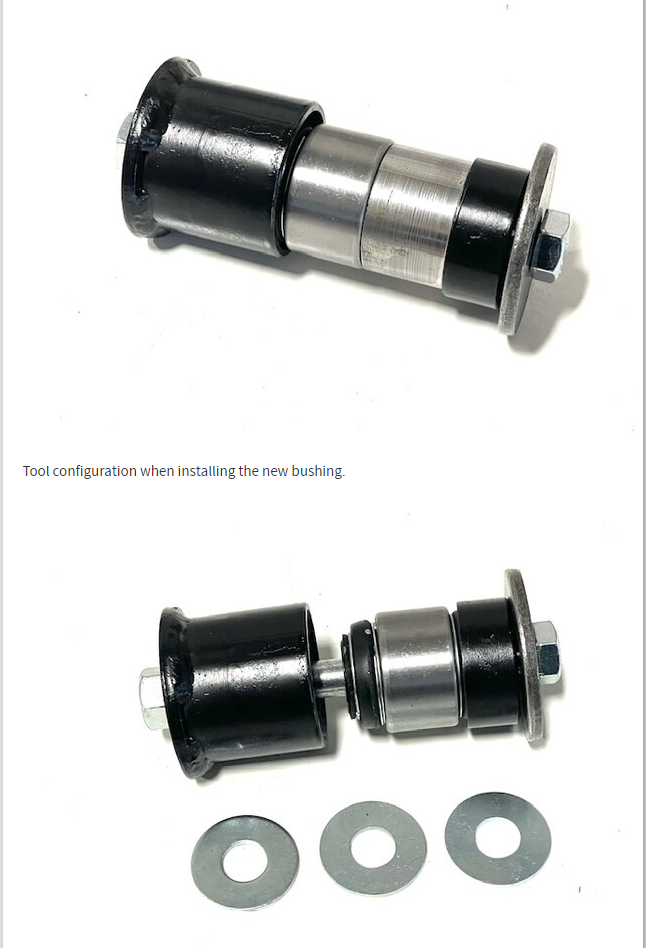

I actually thought this was normal and I've heard BOTUS complain about it quite a bit. Well Kent of Mercedes Source seems to stepping into later model stuff, including a facelift S550.
It does make sense because this bushing is probably the single highest loaded bushing in the entire rear suspension. I might tackle this in my S550. My symptoms are the typical sideways jump when hitting certain bumps. Plus a very faint clunk from the right rear over certain road conditions (though that could be the strut - we'll see). 106k on mine.
https://mercedessource.com/store/w22...eplacement-kit
Kit contains two Corteco bushings and his press tool that he refined after 3 hours of trial and error.

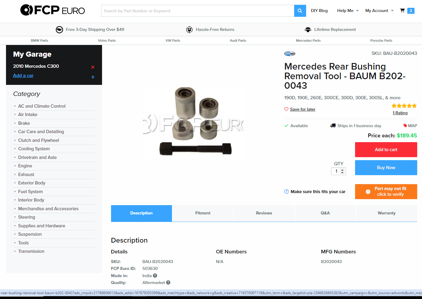

Curious to see how Kens tool ends up working. Id like to replace this bushing in my W204. I bought a set of used spring control arms to replace my current rusted ones. looks like this bushing is very common and used on many different vehicles.
I found the Mercedes tool for a little over $200 or the CTA tool for $175 which I would rather buy than taking it to the dealer. Least that way I would get a tool out of it to keep too. Those tools seem to have ball bearings which im guessing makes it much easier to use.

looks like the W221 has more room around that bushing so only one removal/install tool is required. The W204 has less space and its showing two different tools needed, one for removal then another for install.

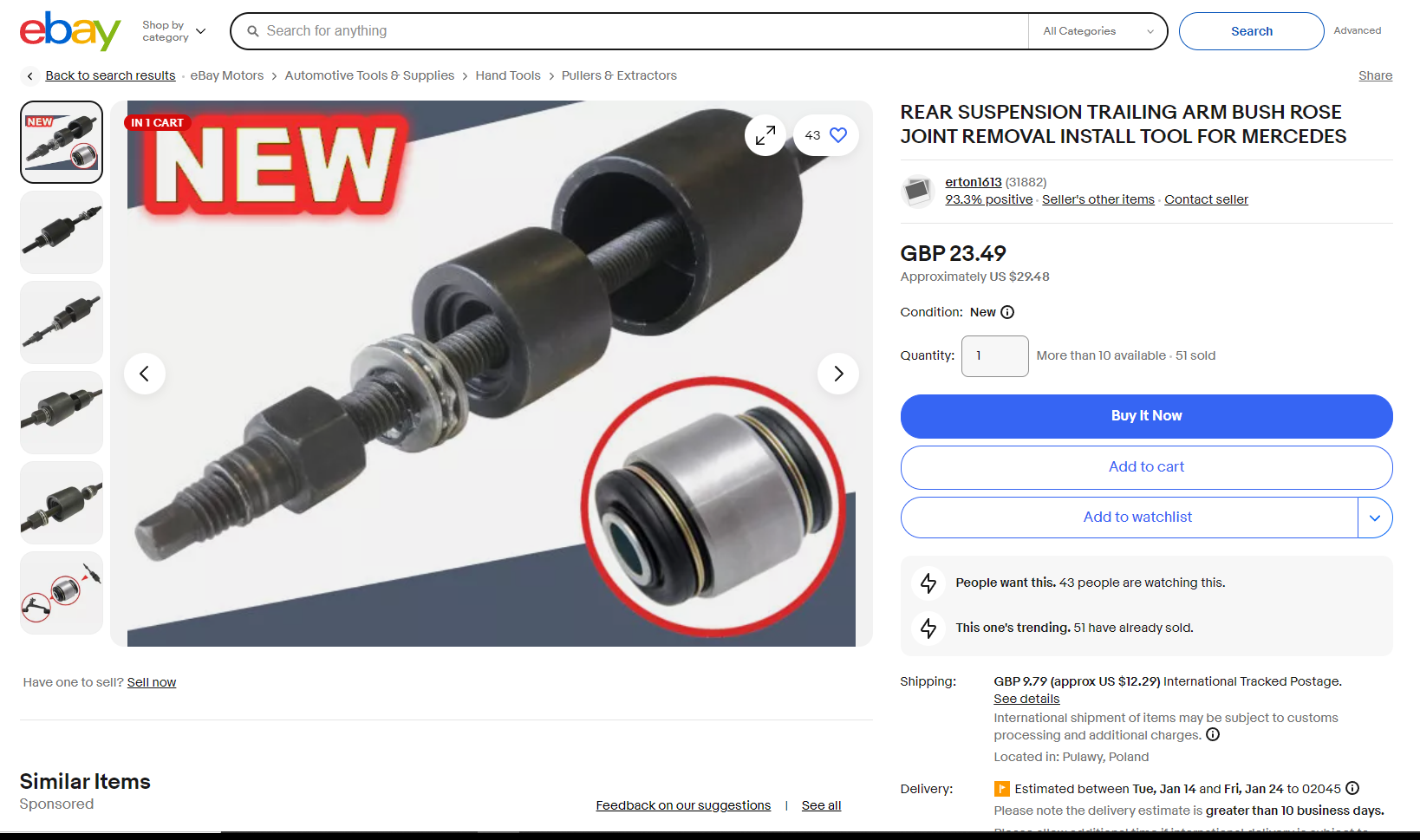

I came across a few tools that look like they may work. Some cheap on ebay then a Baum and a CTA that look more heavy duty with roller bearings. I like the Baum tool from FCP since it has the lifetime warranty if it breaks.
There is a thread showing someone using the Baum tool. https://mbworld.org/forums/c36-amg-c...43-review.html
The MB tool is showing as 202589004300.

I bought the CTA tool at Amazon resale...check there first before buying, as you can often get great deals on returns. I think people buy things like this, use it once, and send it back.

so the bushes are $15 each ! and a decent tool to press them in and out seems to be about $80 - although those bargains you found would probably get the job done with a bit of a grind on the big bit

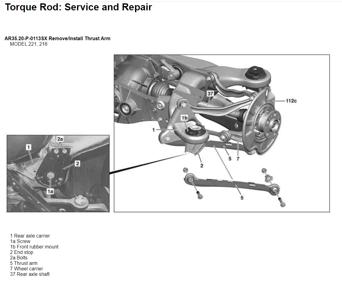

Im familiar with the W204 and the W221 should be the same or similar.
Talking about the rear suspension. The only control arm that is easily removed is the spring control arm, basically just unbolt both sides.
For the thrust arm the stop plates have to be removed to access that inner bolt. To remove the stop plates the bolt for the front axle carrier bushings needs to be removed. * When removing this bolt the manual says the threads must be recut and blown out in order to properly torque the new bolts in.
Heres the directions for the thrust arm. https://charm.li/Mercedes%20Benz/201...0and%20Repair/
For the other three control arms the front of the axle carrier has to be lowered to access all the inside bolts. Thats why im waiting to do all the control arms at once, even might as well replace the sway bar while the axle carriers lowered.

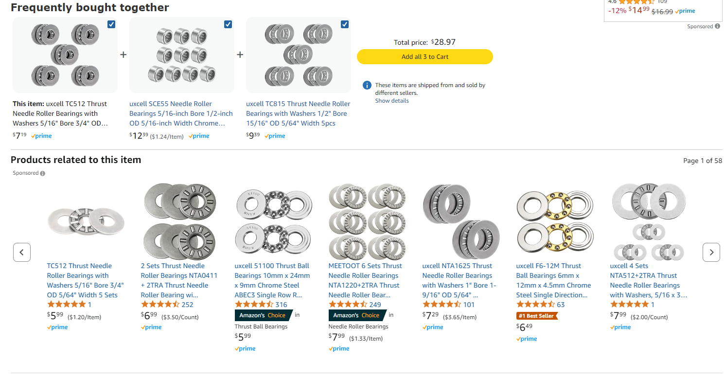

Kens tool does look home made, nothing wrong with that. Maybe Home Depot bolt and washers? I wonder if the tool would benefit from using roller bearings on them like the higher priced tools seem to have. Must be alot of friction on the bolt and nut while trying to tighten it up.
Found some as an example. No idea if they are the right size:

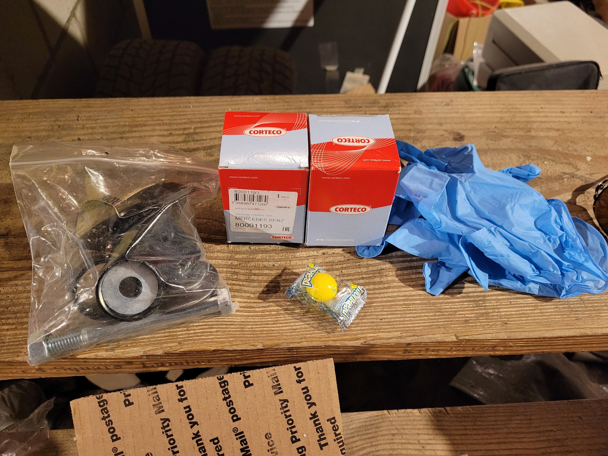

I think this guy really likes putting together kits. That's cool. Got it pretty fast.
Oh, that's a Lemonhead candy. Yes it was part of the kit.
So this is the kit with two bushings and the tool, right?
Where/how did you buy it?
