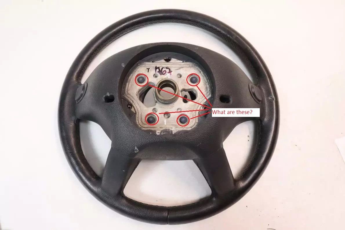

By looking at the pictures of other W221 steering wheels on Ebay, they all appear to have four metal rivets in the back that attaches to something in the front.
Most do not have leather wrapped lower spokes. Or finger grips on the back side.
The price was so low that I took a chance that I will be able to transfer over all the needed parts from my old non-wood W221 steering wheel.
Question: Does anyone know whether I will be successful, or If I bought an incomplete steering wheel that will not (easily) be able to be used?
Perhaps due to different airbag design? Need to have special rivets to attach parts. Need to drill out rivets from my old steering wheel. Etc...

Carefully studying that last link, it looks like those "rivets" are really rubber bump stops:
So, I'm quite confident my old hardware will transfer over okay.

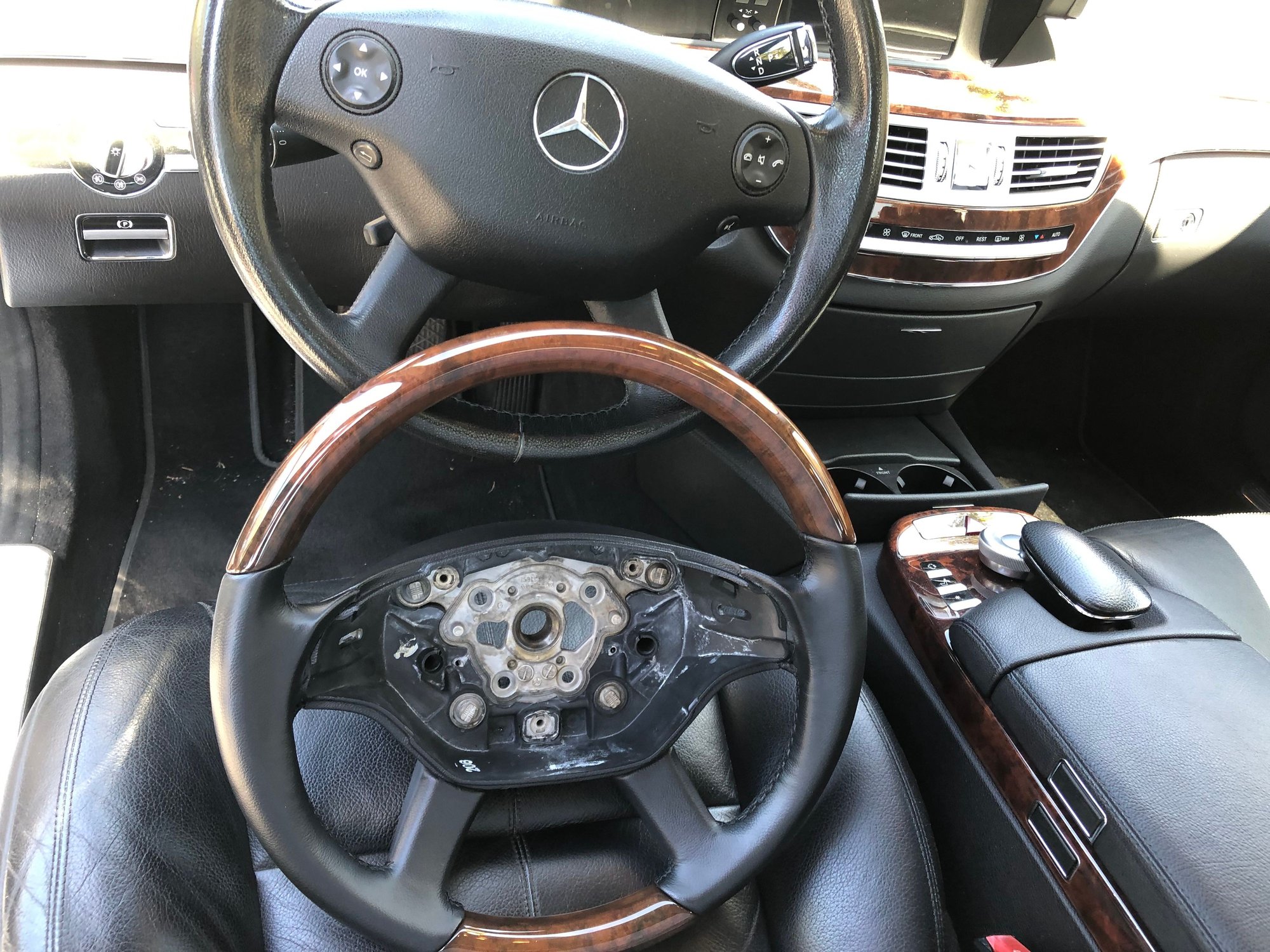

Thanks Botus. I received the steering wheel and, in fact, it is an "MP Design" after-market wheel that came in its original MP box.
I got confused about the OEM part numbers on the box and molded into the rubber.
When comparing the new wheel with the old, it is clear that the new wheel leather is much more gray than the original. Despite that it says black on the box.
I have black leather dye that I bought for the seats but I don't know if that will make a mess and smear over time when used on a steering wheel.
Does anyone have experience with dying steering wheels?

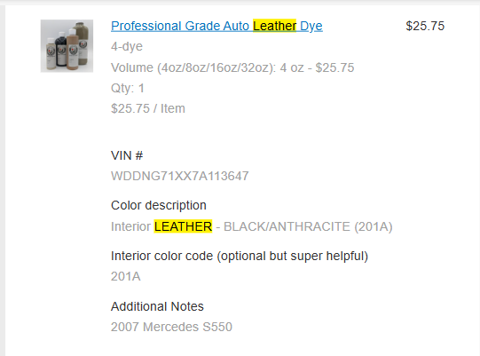

Okay, I applied about 3-4 layers of leather dye that I previously purchased for my seats. The new steering wheel leather is still a bit less black than the old steering wheel.
But, it now matches the seat and other leather color of the interior. I may dye the airbag too such that it matches the new wheel.
Edit: I looked up the original dye order and the dye I used was "Black Anthracite" dye. So that is the color of the seats and interior. But it is not fully black.
I'll may try to order some actual black dye and see if it gets me closer to the airbag color. Or, I'll just use the "Black Anthracite" dye on the airbag too as it looks quite good, actually.

give it another coat

Do not forget, your old one has picked up a lot of oil from the hands and time so it will look like it is darker 👍
