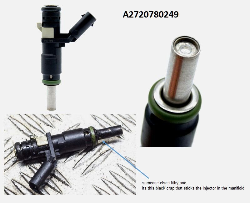

Decided from the state of the last engine Oil change, "it must be" a leaking injector - which in my mind likely fits as the left bank has a minute miss on tickover that is never picked up in diagnostics and utterly undetectable in driving or performance... But annual Roadworthiness test (MOT) has the emissions incredibly tight and bang on perfection... which is confusing.. but the Oil tells another story - after 4k miles was black as hell when normally it looks like new at 10k

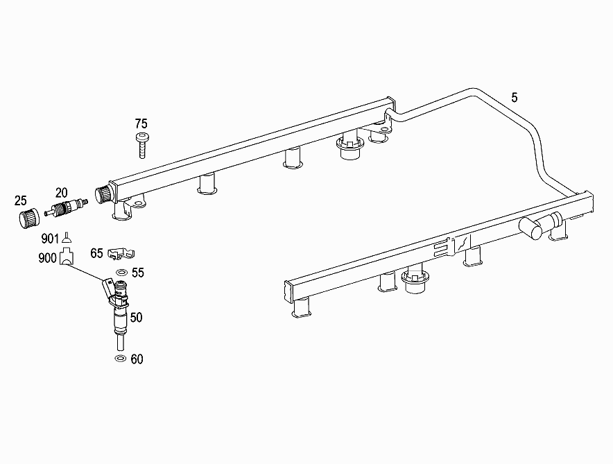

So I went to pull off the injector rail which looks like a terrible job and as you get stuck in, feels like its getting bad enough its time to give up... As you keep fighting 2hrs or unnecessary workload, the mass of wires criss crossing and tied into everywhere is an illusion - at one point I thought you're going to have to pop the wires of the alternator to peel the loom back to get the rail off... but as you keep going its becomes clear the cam sensor stuff, air pump, coils and most sensors do not need to be touched..
of course not before I tried to take off a cam sensor plug and it exploded across the engine bay.... A203 5453028 with a single Part 904 in stock at the dealership, and 4 supplied within 4hrs, its never happened before !!!!!
Weirdly no other plug self destructed, but the same one on the other side did - when I fitted them yesterday they mostly crumble in your fingers... but the pins are held in via two elements of the pin bush. It says you have 4 but I didn’t break any others and don't see where they other two hide (at the back ?)
you only need three tools to get the rail off - torx, euro socket and a pry bar - before starting I cleaned as much gunk off the engine bay / injector area as I could with brake cleaner, but there's little room for a brush to agitate or to wipe it clean - when done I sprayed ACF50 on any multiplug and all the injectors, trying to get both O-rings and the connector liberally coated for a week beforehand. I find ACF50 the best for lubricating, helping the plastic survive and to keep weather seals happy. Wiggled each injector a smidge to see they would behave, but the connectors I couldn't reach with all the crap in place... but as you peel back layers of detritus that should never have been placed in the way, you can reach it all quite easily... Pretty sure you really only have to pull these few connectors and just to inspect there's no need to remove the fuel feed 17mm headed pipe.
Wires off - engine ECU connectors tie back on a wiper arm, injectors and most of the stupidity peels back to the right side and tie out the way - then the rail will come off leaving nearly everything in place - most of the work is the multiple euro fixings bolting the wiring loom down to the manifold and cam covers, so it can withstand a force 20 hurricane ( I know Max is 12 but clearly Merc weren't told... )
More ACF50 and more wiggling of the injectors - that whilst all feel loose, the rail isn't coming off for anybody !!! Went to get a pry bar and it will fit on every injector and you can just tweak under the plastic where the electrical connector sticks out on each one and they pop out. A tiny wiggle and small force 7 popped out as if never tight and the eighth was a bit stuck but came out with far less force than I can imagine would damage it...
Then with the wires out the way and fuel line still on - you can turn it upside down an lay on the left side of the engine bay on top of the left cam cover.... leaving you to clearly check the bit of the injector that matters... I wiped the carbon gunk off the ends and sprayed brake clearer before looking at the 8 holes that let fuel out - they all looked clean
After allowing the brake cleaner to dry out I re plugged in the Engine ECU and the other connectors (bar the injectors) and re pressurised the rail with the ignition on. Then looked to see if any were dripping, weeping or getting damp - Nothing. So refitted it all. Of course would have been wonderful to check spray patterns but I don't have the kit...
Started up no issue and it continues its 20% more than it used to drinking habit... Thought about life over night and what to try next, and all I can think of is usual Merc mischief - so many software updates on later cars it would not be normal if Merc didn't try the same misbehaviour on the W221 - After all they went insane and added three times the complexity to make it as heavy, complicated, and as unreliable as they are - yet it drives about the same as, and with the tech you now get on a Romanian supermini for US$10K...

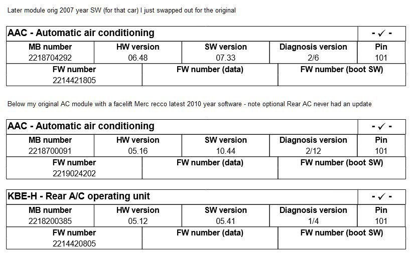

I have another HVAC module running dealer online tool SCN flashed facelift approved software that was updated in 2020. I'd replaced it with later HW running its original 2007 software chasing another anomaly - So I threw that in yesterday and found a small loose 3 wire connector under the dash on the passenger side... I'm not sure if its meant to be unplugged (unlikely) - but what’s it for... its on the passenger side close to the tunnel and a very short lead - so can ONLY be (if used) something very close - which seems like either an air flap modulator - but I can't see where it would go, there are two close by. But they already have wires and can't see a spare socket... or at a push it might just reach the HVAC module - but that had as far as I ever knew 4 distinct multiplugs and this is very different...

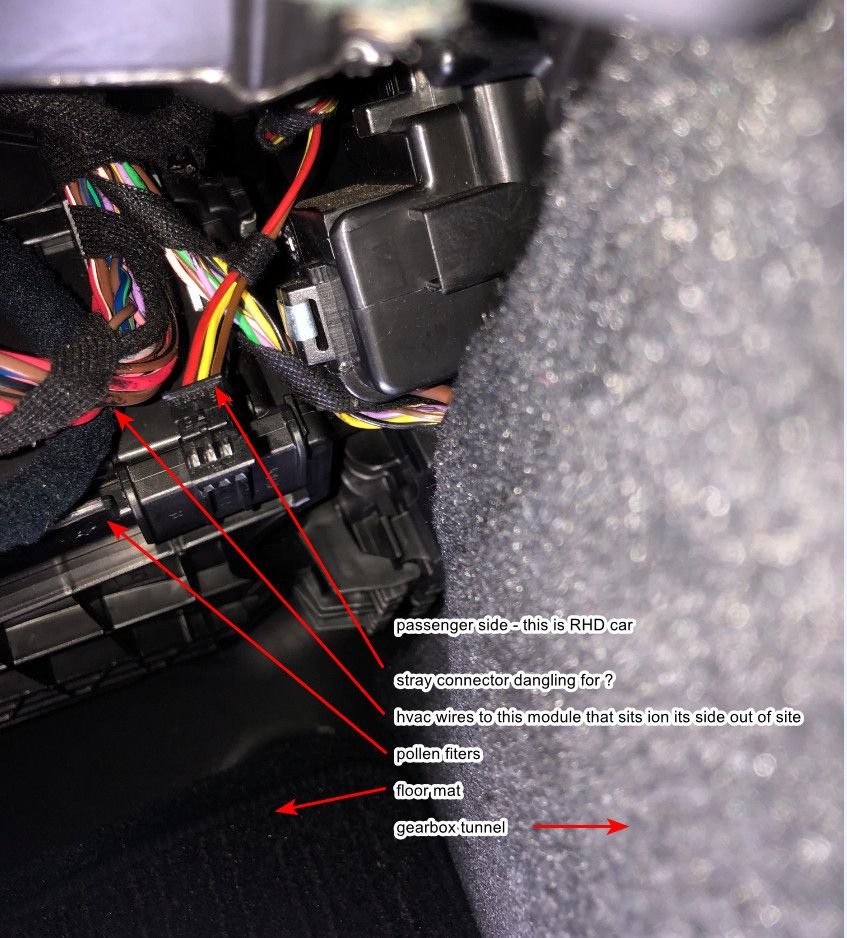

anyone have a clue where this 3 pin connector goes? this picture you are looking directly upwards from the floor
HVAC module is almost hidden behind the pollen filters in a gap that doesn't appear to exist and looking at it that connector can't go here

so there doesn't seem to be much there this plug could go on
but these would required something similar I guess - 105 is about the right area but I would have thought the wrong side of the car... as I guess the HVAC box of trick is the same - or do they have a LHD and a different RDH unit .... which surprises me, but I guess must, as mine is the other way around to this pic

well pulled the module out to get some room had a good look can't see where that stray set of 3 wires might go
here's the SW info of the AC modules in pre 2009 cars

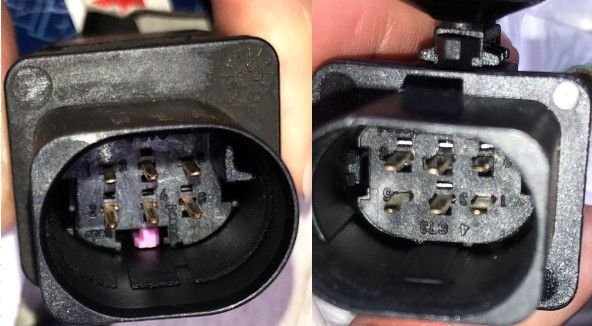

checked with a spare bosch sensor - can you believe in my senility I forgot to grab a picture of the one I refitted....
they aren't square pins but def much smaller 1.2mm vs of the pattern part's 2.0mm it can't fit - but on ebay must be 20 sellers pushing these - they look exactly like the bosch ones but with wider pins..
this is the Merc part number - MERCEDES-BENZ O2 SENSOR A0035427018
goodness know what these morons are doing using connectors that can't fit
I have a picture of what they should be - when I put both together I'll post them side by side - but in the means time the pins are meant to look like this
FYI goodness knows why any one attempts from above the connectors are clipped into metal brackets beneath the gearbox at the front of its sump

what a bunch of halfwits
OEM on the left... Can't fir on the right

Is the only difference in the pins (i can't really tell) or is the shape of the plastic different?

the plastic parts fit perfectly and start to go together but as the pins are much wider wrong 2mm vs std 1.2mm - the electrical bits can't connect together
