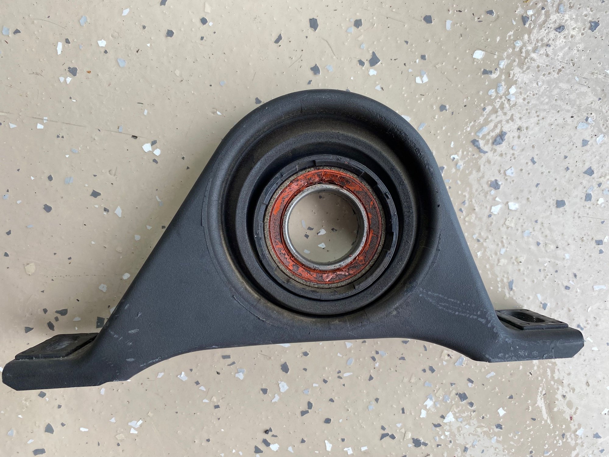

I had this problem a few years back. I did everything discussed above in this thread. The steering wheel shake was 99% corrected. For the last one percent, I think I've found the culprit...the center support mount/bearing. Look at the attached photo...the rubber has collapsed to the bottom, and the driveshaft is sitting low. I will be putting the vehicle back together this weekend, and looking forward to driving it and seeing the results. And my CL only has 68,000 miles and looks like this.

Wow this doesnt look good at all. Thanks for sharing your experience. Did your CL make also the strange vibration that would come and go ? Do you recall if it was always or sometimes? The more i know the easier it is to explain this to the workshop. Much appreciated

At first when I got the CL, it was always when I got above about 60mph. As I started to troubleshot, doing one thing after another like others have talked about in this thread, it gradually got better, and eventually almost 100% but not quite. I think multiple things were contributing to the steering wheel shaking. I would categorize the shaking as coming and going as I got slowly closer to fixing the problem. My advice is always the same--do everything, because your parts are old and worn out anyway, they aren't that expensive, and you'll know where you stand.
I took the driveshaft to the dealer to have them press on the bearing, since I don't have the MB special tool. I stopped by yesterday, and surprisingly they don't have the special tool. They were going to try to improvise something. If they can't do it, I'll have to improvise something--if anyone has advice who has done this, let me know.

Flex discs, very doable, but like my photo of the driveshaft support showed, yours is likely toast. And I bought the last one available in the US. However, yesterday I found out a few important clues about parts specific to the 2007-2008 CL--can't recall what year yours is. You can DM me if you want. Motor mounts aren't that bad in a regular CL, but can't say for sure about an AMG. While you are at it, replace all the exhaust hangers with new rubber so as to help absorb vibration. IMHO, it's all those little things that are worn that add up to a car not feeling like it did when new.

I drive a 2009 W221 S600 V-12, and experienced symptoms like yours.
When I first purchased the car with 78k miles, it vibrated throughout the throttle up like a car with a racing camshaft in it. My friend, who builds propeller planes, thought it sounded macho.
The fix was to replace the two liquid filled motor and one transmission mount.
Ran quiet and vibration free.
The next vibration issue was at 65mph up to 85mph I had a low frequency rumble in the lower body. My deaf buddy couldn’t hear it, but I sure could.
It seemed to come and go depending on conditions.
I bought new tires ‘cus the original tires were 6-7 years old, kept the factory rims and had them balanced (I’m ashamed to say how many numerous times) and road forced by a reputable place. No change in symptoms.
Found a front wheel bearing with excessive play, adjusted by shop, no change in symptoms.
Front brakes were warped. Replaced pads and rotors with MB OEM. No change in symptoms.
I followed a technical bulletin to replace the torque strut arms and bushings. No change in symptoms.
A smart old boy chimed in on the forums like my first Sargent: “Fixed struts do not cause vibrations, things that rotate do!”
I was starting to believe.
I took the car to a MB Dealership, tech drove it:
When accelerating thru 65mph, no vibration.
When decelerating >65, vibration.
When holding speed >65, vibration.
Before finishing the test drive, the tech announced: “According to my careful prosthesis, it’s the drive shaft!” He used to be a doctor, but now makes more working for MB.
I had the driveline, carrier bearing and housing (guys reported to do both), and both flex disks replaced and my car drives, well you know, sort of, perfect!
ps- I have the best balanced tires in North America.
JR
JR
I did all of what you said, went through all of what you experienced, and the solution was in fact the driveshaft & drive line. This by the way, on an S350L which has a fraction of the torque the 600 has.
I'm glad I went through that list as I renewed many other widgets that needed replacement anyway but - the 65-85 => will be driveshaft always.
Honestly I think that the reason this happened is that a lot of people just don't understand anything at all about cars, or are too ignorant to realize that something that's vibrating will create run out and thereby generate significantly more problems.
When I bought my S350 used on the test drive I knew I had to deal with the driveshaft (experience from my BMW years)
Running a car with a sub-standard carrier bearing, or worn out flex joints for a prolonged period of time creates so much vibration that it will negatively affect (in my opinion) the driveshaft's balance vis a vie U-joints etc.
It is *INCREDIBLY* difficult to keep one of these at 100.00% however it is much easier to keep it at 100%, than to let it degrade to 80% and then try to get back to 100% after. When one component degrades, it takes many others along with it.

Originally Posted by lthlc63
Unfortunately a problem like that you’ll be throwing parts at it. Start cheap
if aftermarket wheels: hub centric rings
then motor and trans mounts
anything with driveshaft I’d assume it wouldn’t come and go
The tire folks knew about the hub centric rings for aftermarket rims. It can be a major contributor to vibration especially in the steering wheel. I didn’t need to worry about it as my rims are factory and self center.
The subtle vibration of the driveshaft came and went, depending on road conditions and if I was not rested up too tired to feel it.
That subtle nature and having never seen that before, tricked me into replacing parts which were not related, like strut bushings and balancing my tires 27 times. Exaggerating, maybe 13 times.
Sitting shotgun withe MB tech, the diagnostic of the vibration seemed to be repeatable and accurate.
The driveshaft assembly was $1200, the newest part number (latest redesign and probably better materials for reliability or cheaper to make more profit?)
The two shafts arrived assembled to the carrier bearing, balanced, and brand new flex disks mounted on both ends with nuts and bolts included to mount to car.
Had it done by shop to save time.
That last repair item in the proverbial list of vibration causers hit it out of the park.
I learned by experience and from my forum pals, for this S600, V-12, mileage >50k, vibration causers on the “most likely” list are:
Number 1: Tire balancing, road force, and rim centering on hub.
Number 2: Motor/transmission mounts.
Drum roll please;
Number 3: Driveshaft assembly including both flex disks.
Ignore this list if your car is used for any type of racing or 4th of July demolition derbies.
JR
