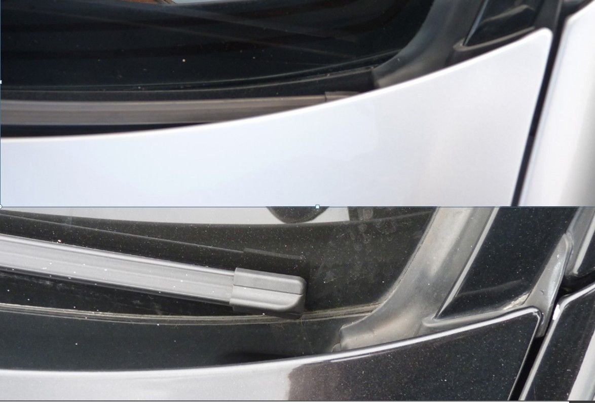

whats the current screen?
check below Top half is a Pilkington pink tinted IR aftermarket screen vs the Bottom half of the photo that shows an OEM top spec screen with the SunGate mirror tint and the pink IR coating
Merc don't even admit they used these screens and they have never been available - a guy runs indy garage with an S600 has been fighting Merc for 7 years to get one <4 years out of manufacture of the cars

I think it was aftermarket and replaced at some point by the previous owner. It even had the same name of the manufacturer as mine does (Sungate EA) but no Star on top of it.
Thank you.
everything you say about the screen you have matches my OEM 2006 screen and is what the indy with S600 has been trying to buy from Merc for 7 years - they deny it was ever on his car
he made a point of telling me my screen as fitted now isn't original then explained his story - the actual picture I gave shows how the crappy Pilkington screen isn't cut correctly on the lower corners - meaning the trim doesn't fit
yours, mine and the indy garage owner all need
Sungate EA
With the large rectangular IR passthrough in the center lower hal
A small cut out next to the driver's (lhd) sun visor and next to the rear view mirror.
It has the blueish purple tint that matches the side windows and rear screen.
And as mirror effect if you look at it from outside vs ones without this Sungate feature

no the guys is a big Merc specialist - been around since forever he's been arguing with Merc Germany for 7 years - not some local monkey dealership - buys in the region of US$ 500k Merc spares every month for last 20 years
