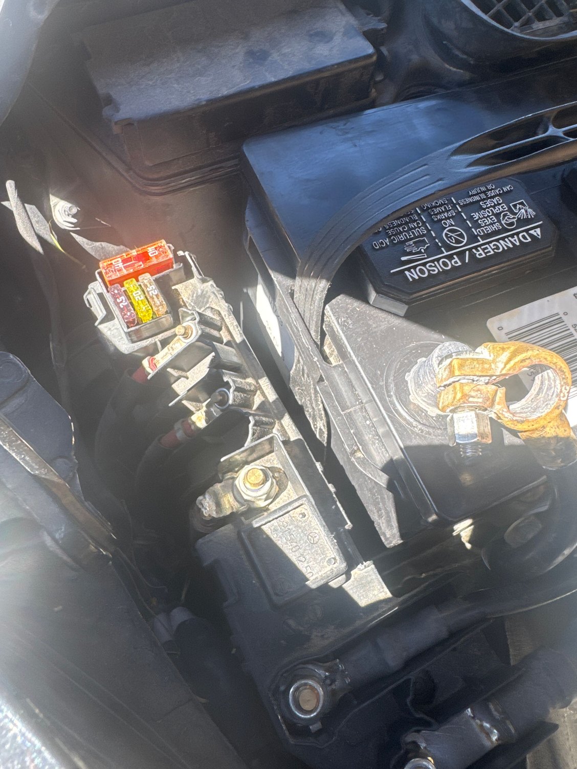

I have a 2008 s550 with about 132,000 miles on if a couple of days ago I noticed having some sluggish starts but the day it went out complete before I have to call a tow. I was running errands about 3 of them and everytime I start the car the starts got sluggish and sluggish until my last errand went into the store and came out and nothing no crank no nothing… I had my mechanic check voltage on the main fuse box under hood he said it was good 12v than he went onto the battery side and the terminal wiring read about 9volts (he dug the voltage reader past the black. he said something isn’t getting enough power. Just from anyone having experience before I get it towed to the shop what else should I be looking at? Thanks in advance I like to learn also when problem arise
this side is having low voltage

did anyone connect anything back to front
cars get pre-fuse boxes with fusible links than can pop if something nasty happened

that said where he said u have only 9v - this module beside the battery has been known to go strange

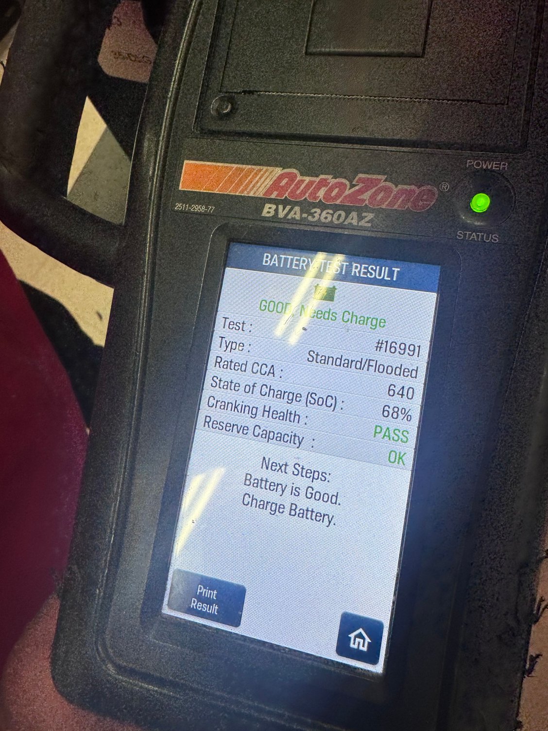

thanks for your response do you recommend a battery? I have a brand new battery but it’s way to long to fit in the battery slot and I can’t even test it because my terminals really only fit
here’s when I took it to autozone to get the one traded it had 68% but when I picked it up it read 100%
a battery that can actually fit.. terminals are to short

the cars had a cross over from two batteries, to a large battery up front - the twin battery ones have a small in the front - and a very large one hidden at the back of the trunk, accessed ONLY via the trunk after removing the trim - its behind the right rear seat)
the photo you gave in the first post would indicate you have the twin battery set up - and the front battery is a small 350cca one just to crank the engine - in the trunk is a massive one that does all the rest of the cars electrics
the idea is the back can help the front but not the other way around - as no one sees it - the rear one is often in a right mess - not that I believe it should stop the car starting if a good one is in the front - a naff rear battery certainly makes the car have a hissy fit - and as so much of the car relies on healthy volts from the one in the back - and you are getting nowhere - it might be worth fitting one at the back - it should be an AGM battery
it would be sensible to have the front disconnected and do not short out any electrical kit in the trunk - its a right faff of a job slide it on a bit of plastic - like a bag - and disconnect / reconnect the breather pipe elbow on the right side (can be done with battery in place - but not much room
