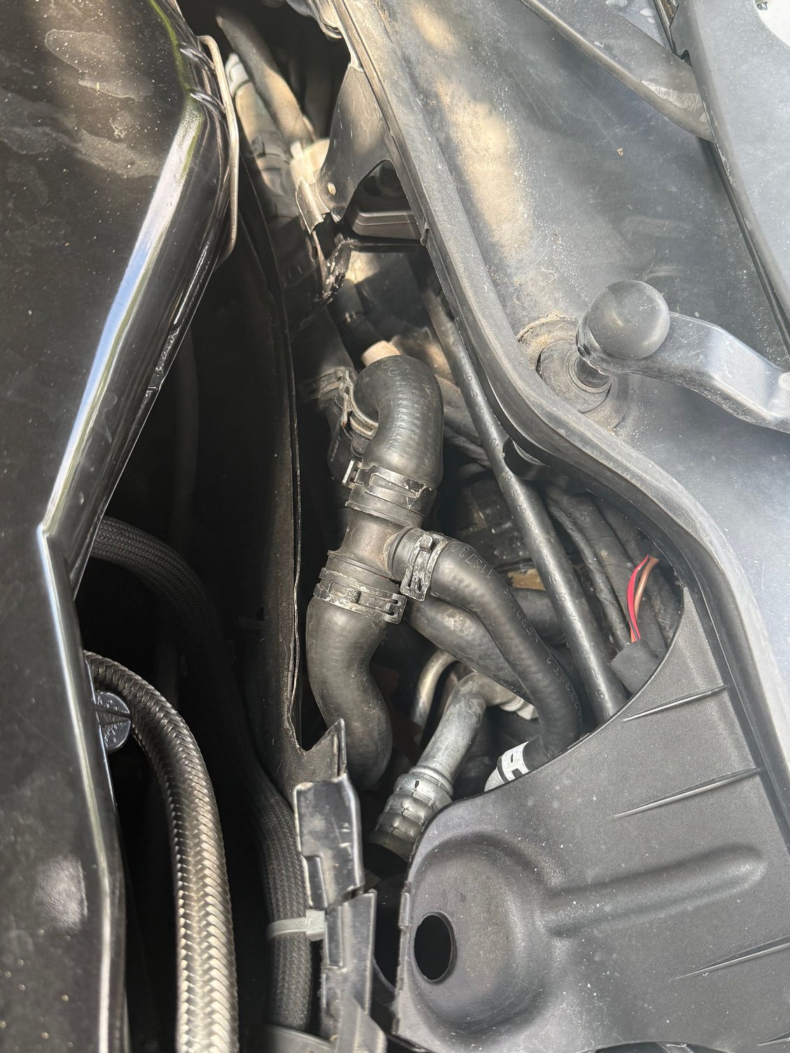

Hello everyone,
I am seeking advice on a persistent issue with no heat in the cabin, which has been ongoing for approximately two years. Despite numerous repairs, including replacement of the water pump, thermostat, changeover valve, auxiliary pump, and a heater core flush, the problem remains unresolved. As winter approaches, I am eager to find a solution. It is unusual that the hoses near the firewall, involved in the cooling system, remain cold, while the upper and lower radiator hoses and those connected to the coolant expansion tank are extremely hot. I have attached a picture of the hoses in question. The vehicle's operating temperature is normal, and I have verified the blend doors' operation. Could a stuck-open thermostat or a defective water pump be the cause of this issue, and if so, would these issues not trigger other problems, such as overheating or signs of water pump failure?

Can you remove the 3 hoses from that T-piece and test that each of those 3 is not blocked?
Even when the car is cold (and the thermostat is closed) the hoses to and from the heater core should be "open" iirc.

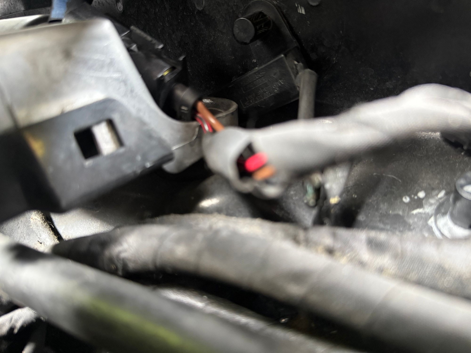

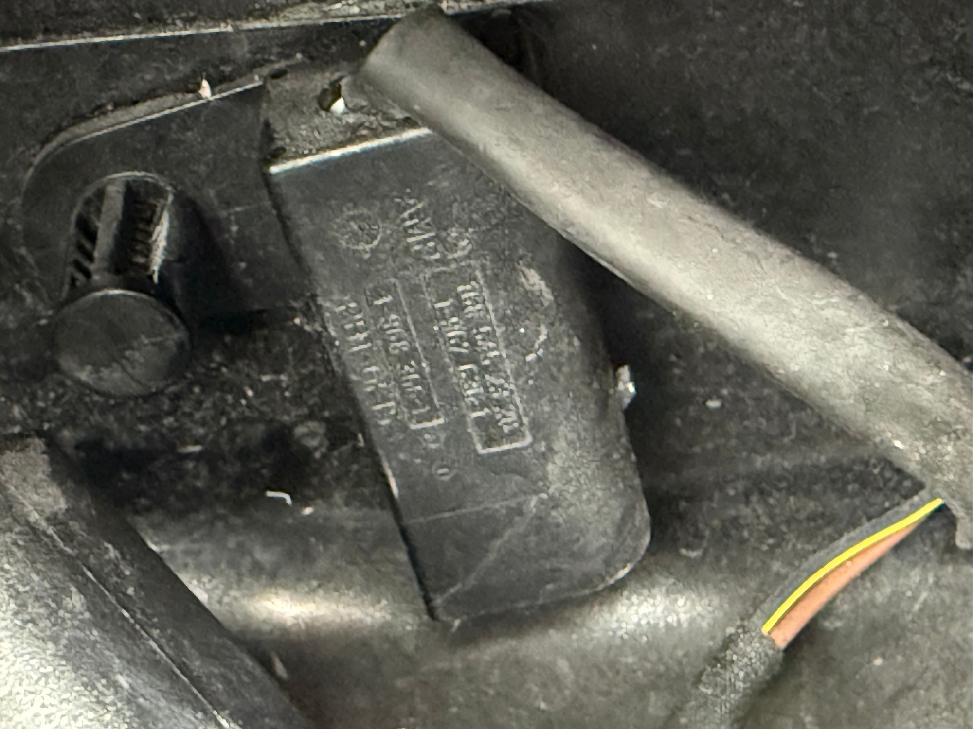

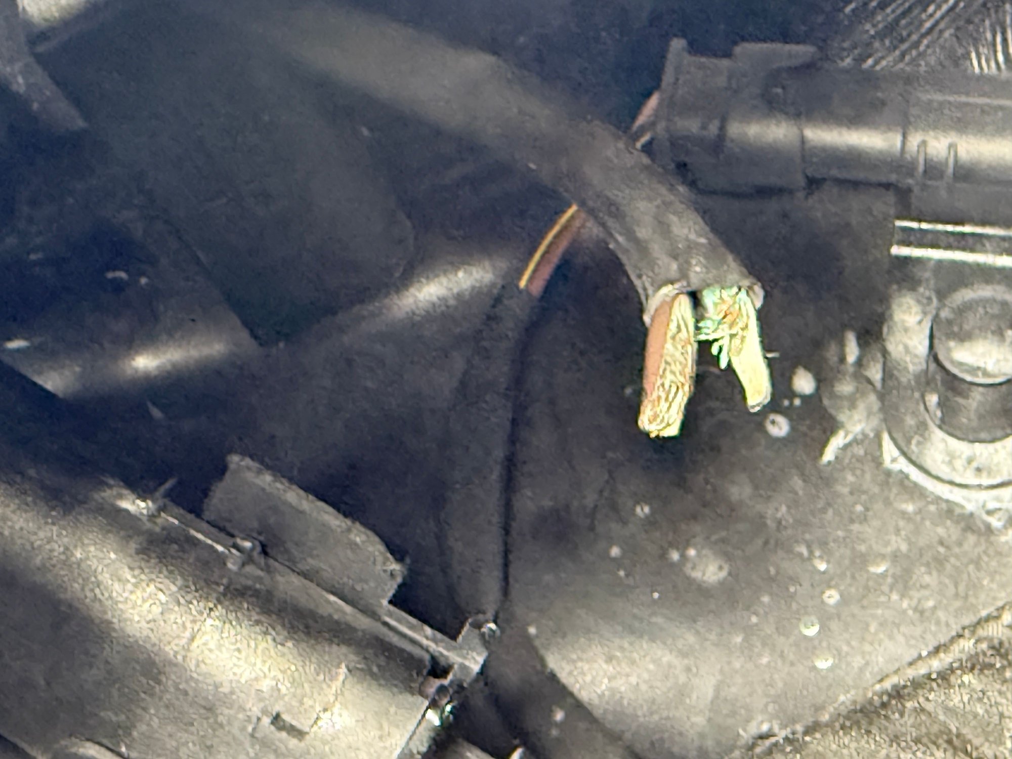

I recently ran Star and photographed a random sensor in the engine bay with two wires that are not connected. The Star computer displayed an error code of 90A2. When I utilize the climate controller and press the air circulation button while the heat is on, the air blows warm; however, turning off the circulating air button causes the air blowing from the vents to become much hotter. The error code indicates that the issue is likely due to either a faulty or clogged change-over valve, which was recently replaced, or a clogged heater core. As I type this, the Prestone cleaning solution is still circulating through the system, and I am hopeful that it will resolve the issue.

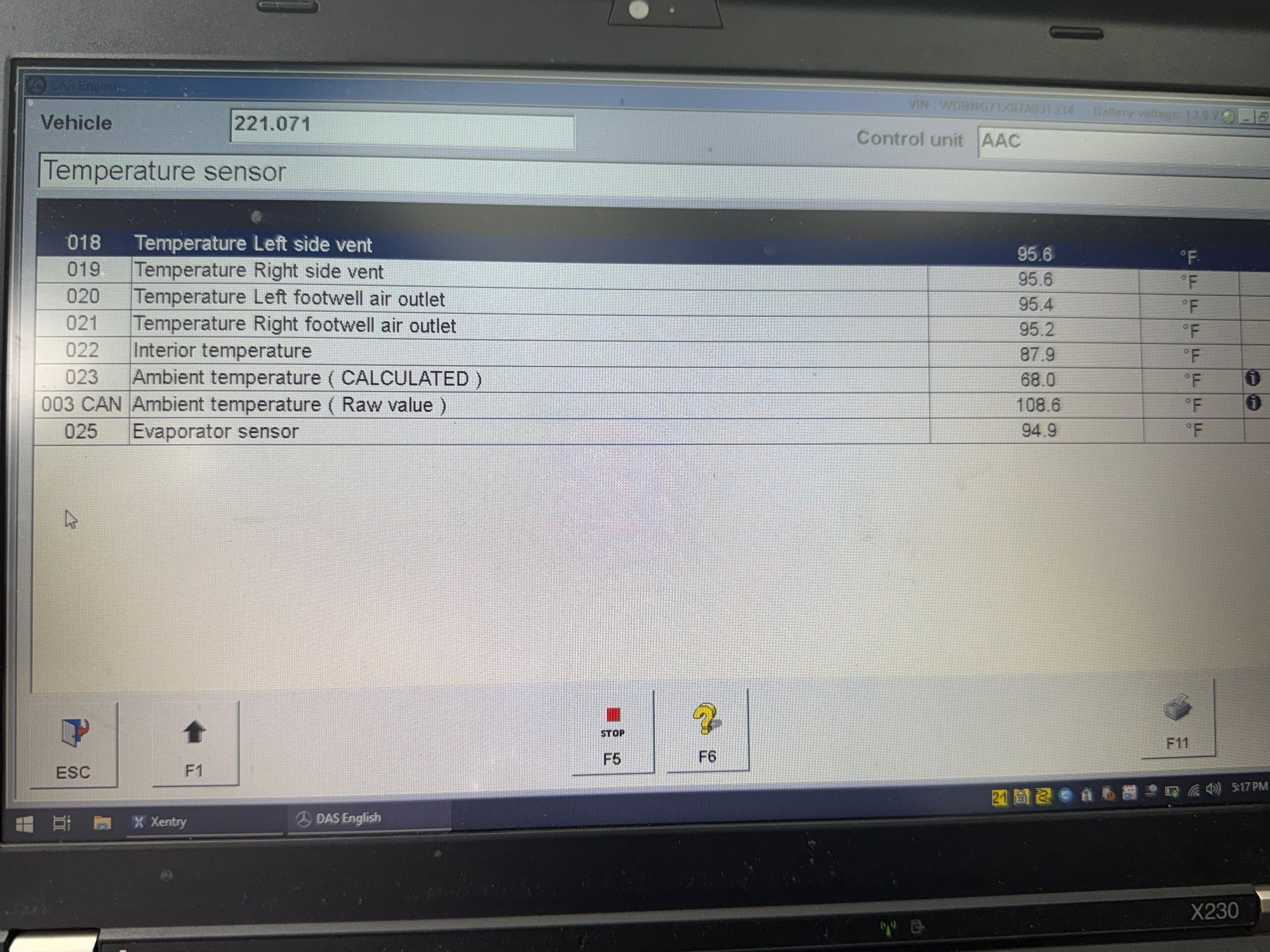

‘16 Mercedes GLE450 amg,’15 Mercedes gla, coupe,’07 Mercedes w221,’12 Audi A
As evident in the picture, the temperatures are increasing as desired, although I wish I had taken a picture before using the Prestone total flush and cleaner. The temperatures have exceeded 95 degrees and are still rising. Both heater core hoses are hot. Replacing the changeover valve is an option, but it is possible that the issue is now fixed.Can Anyone tell me the degrees they get with the heat on so I can compare.

no idea where your pictures are taken - so can't help - how about a big engine bay shot and you point us to where u r looking

He's 273, BOTUS, so he'll be looking midline rear-engine between the engine and the firewall.

More peace of mind than anything else. The picture shows what seems to be a sensor, but it is not connected to any other component. To its right is another sensor, which is correctly plugged into a harness.

What I see is a corroded, clipped wire that should probably be not corroded and connected to something. We might wish we saw that a couple years ago!
Time to break out the wiring diagram.

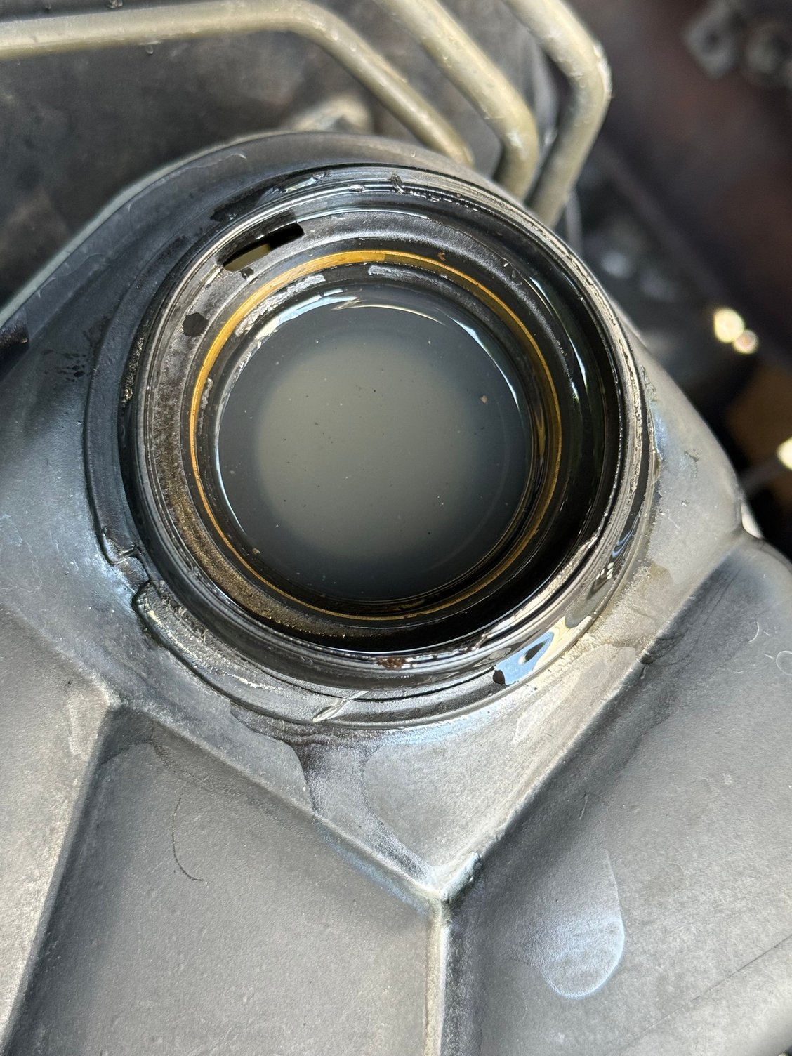

I am fairly certain that this image confirms the widespread suspicion that the heater core was clogged. Upon close inspection of the fluid, which consists of Prestone cleaning solution mixed with tap water, one can observe tiny particles that are likely debris from within the cooling system. Unfortunately, I am compelled to note that the vehicle's previous owners did not adequately maintain the car. I acquired this vehicle in September 2018 and have since endeavored to implement upgrades while rectifying issues caused by the previous owners. As evidenced by the flush, the cooling system did not receive proper servicing prior to my ownership. Hopefully, I will be able to perform multiple flushes and successfully remove the contaminants from the system.

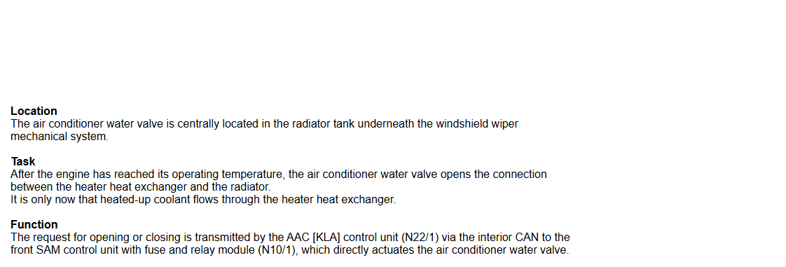

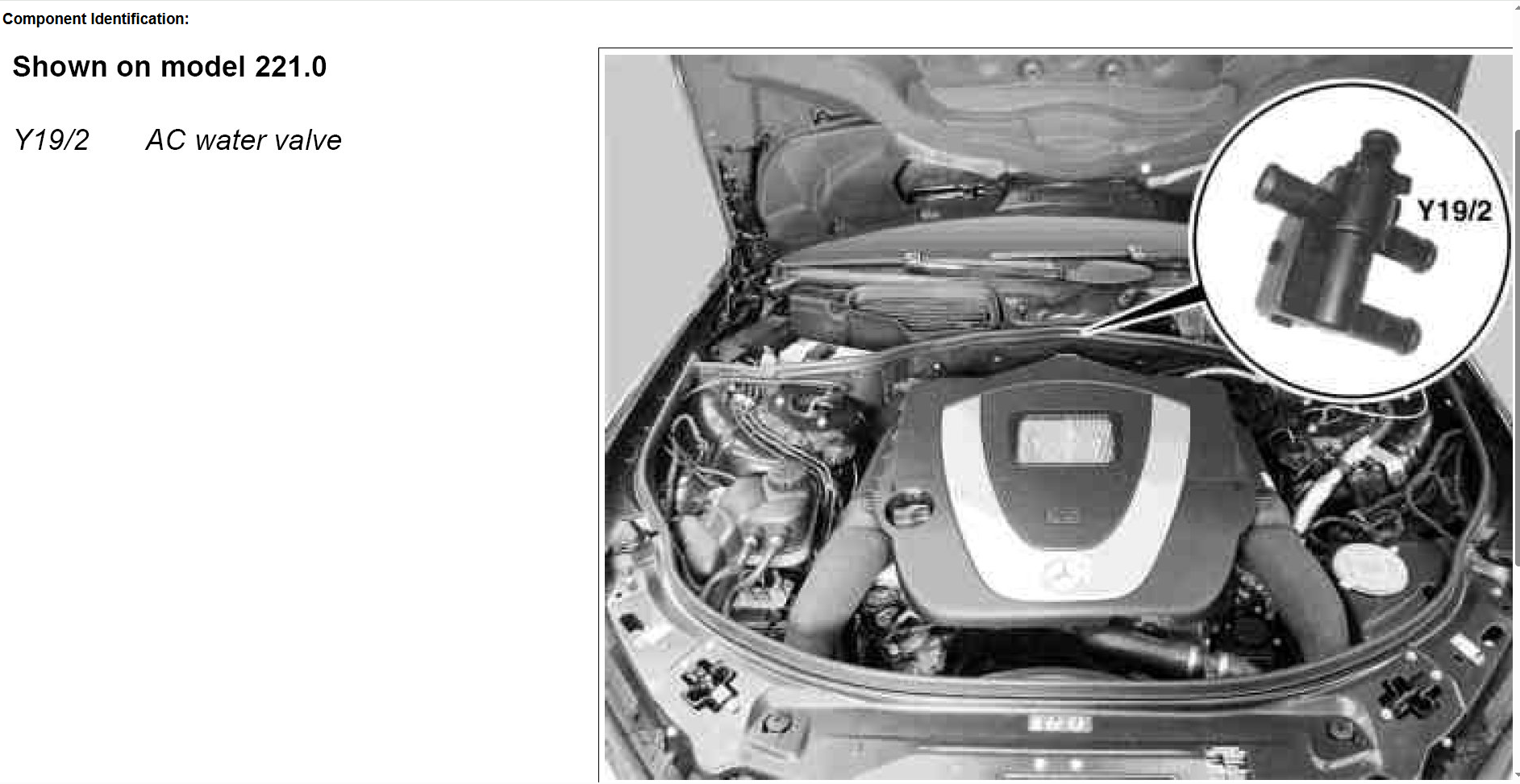

Reading thru the thread im not sure if the ac water valve was checked yet?

Flush that thing about 4 times and replace that valve.
