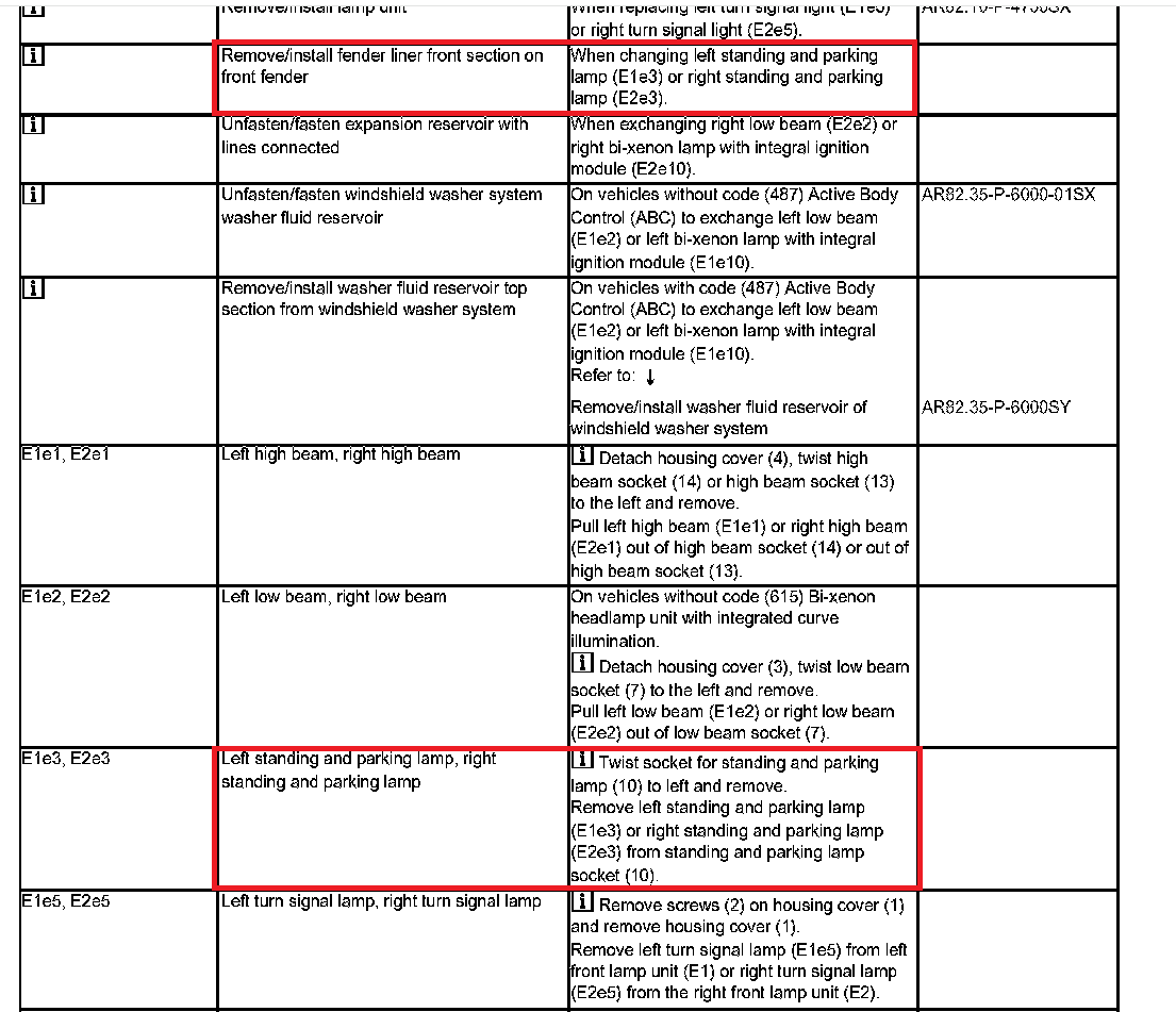

Can you reach down behind the headlight housing and reach the sockets, they twist off counter clockwise?
If not the manual seems to say to remove the front sections of the wheel well liners to reach them.

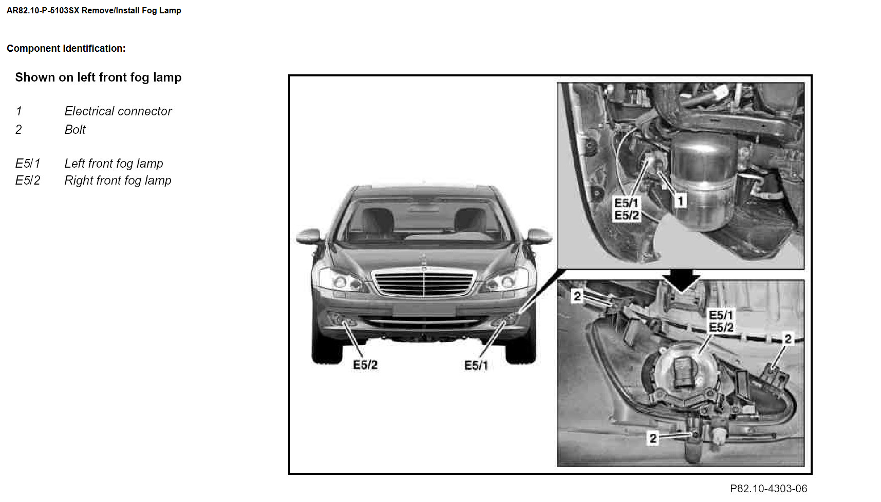

With the wheel well liner off it may be a good time to replace the fog light bulbs if they havent been replaced in awhile.
