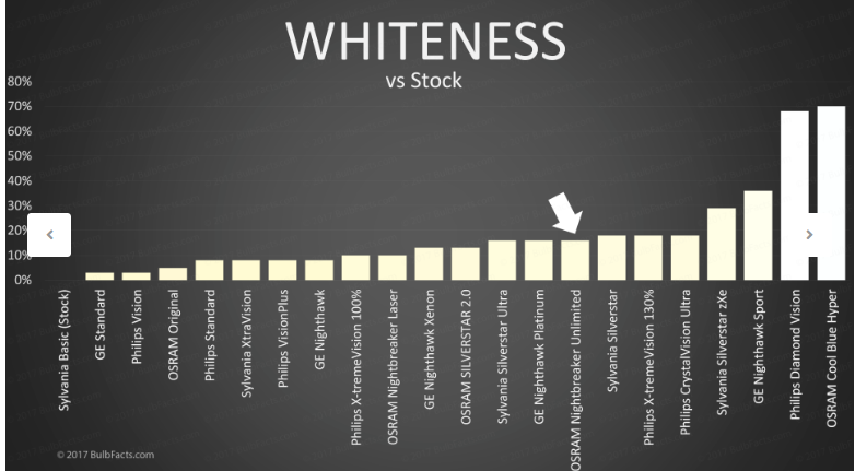

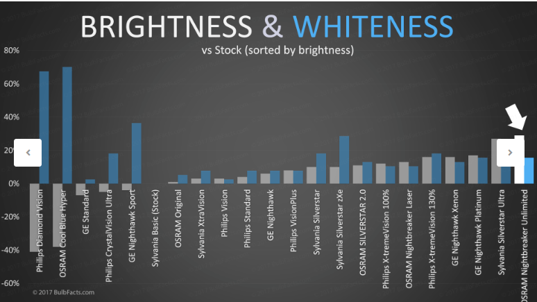

Get Philips WhiteVision or Osram Cool Blue Intense bulbs. They are a pure white that will match your outer lights perfectly. Just avoid cheap, extreme blue-tinted bulbs as they look bad and perform worse.
Thanks a Million for the info.

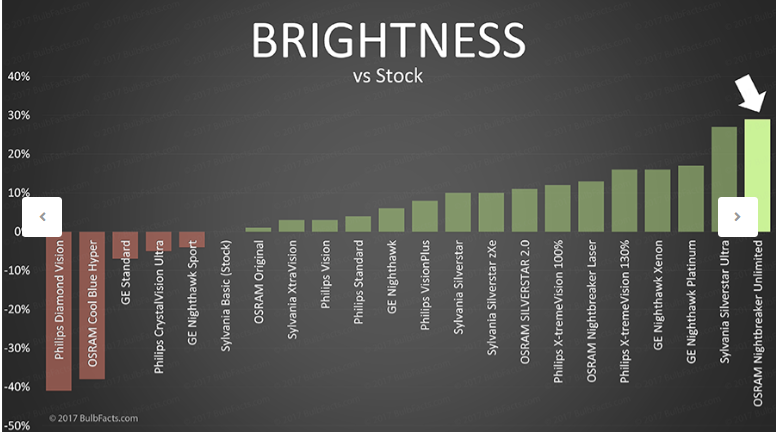

When looking for replacement halogen bulbs for fog lights I wanted the brightest while not having to replace them every year. I went with Osram Nightbreaker Unlimited which do look whiter than standard bulbs. I think since they have come out with newer versions, names. Heres some info i was looking at to choose which ones would work best for me, compares whiteness and brightness of various bulbs:

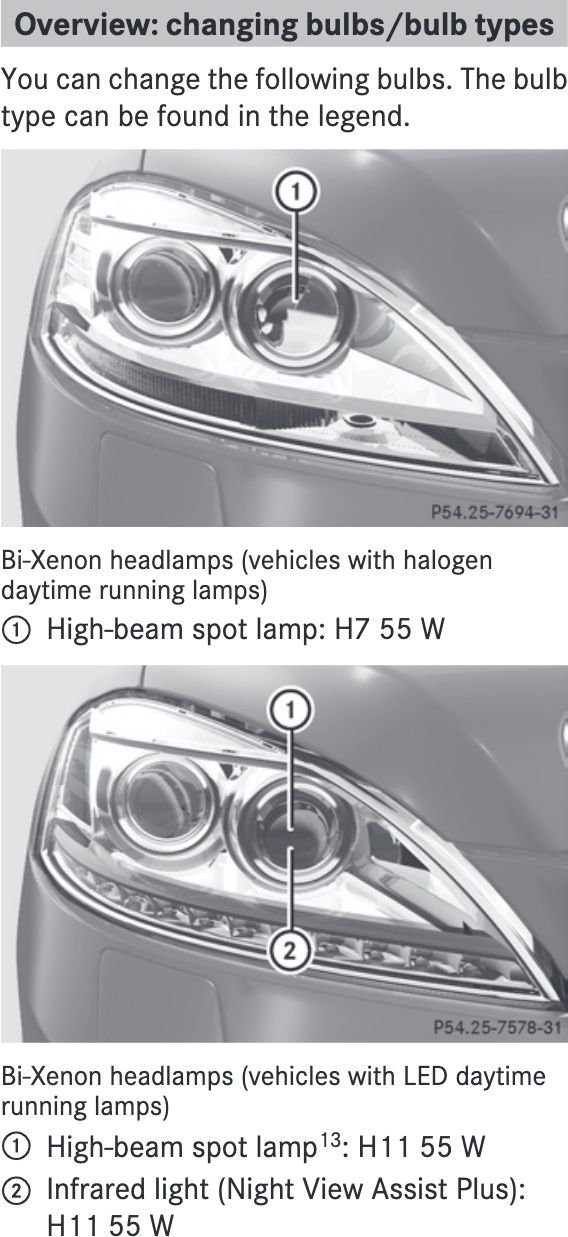

Originally Posted by TimC300
Thought the high beam is a 65w H9 bulb?
It's complicated.
This is for the 2008:
And this is for the 2012:

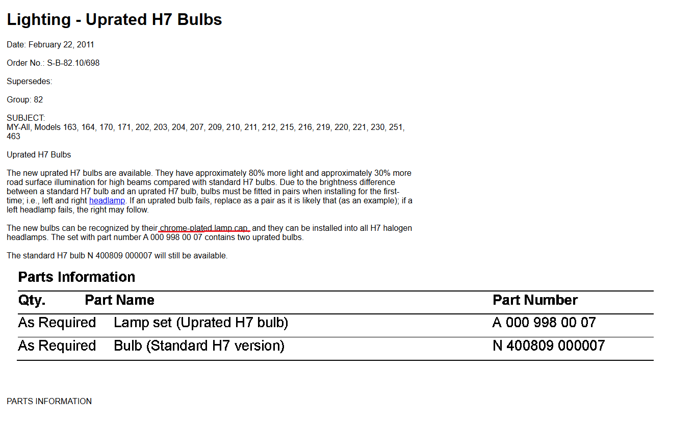

Im always coming across the tsb for the uprated H7 bulbs. From what I gather Pelican Parts seems to say they are the Philips X-treme Vision. MB has since discontinued that part# and there is a newer one out.

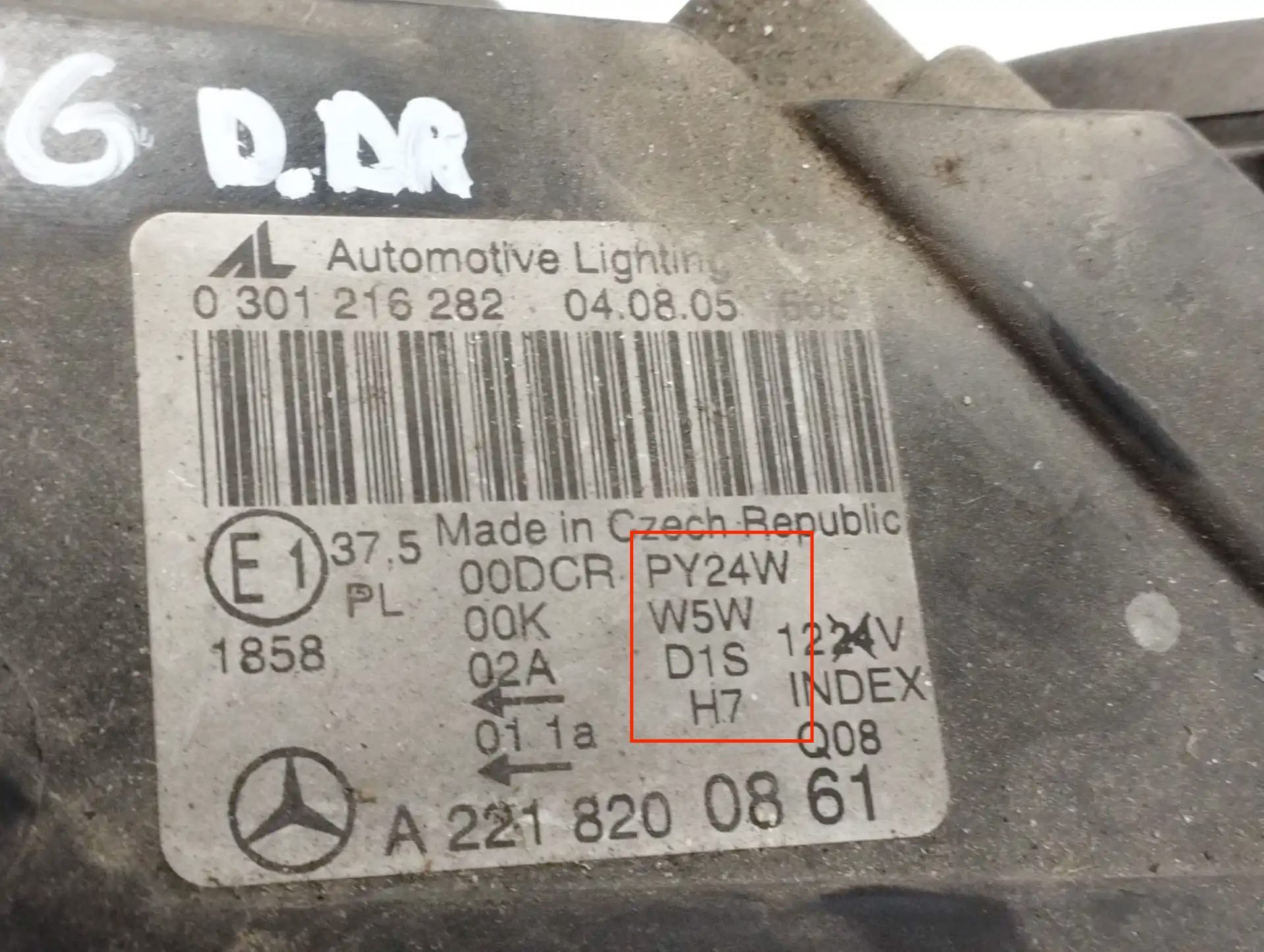

There is a sticker on the top of the headlight (nearer the center of the car) that does mention some bulb types:

Thanks for the info, but it is confusing with post #7 from Jaap. In that one there is mention, looks like in some literature, that Bi-xenon lights with halogen DRLs use H7 bulb for the Spot Hi-beam and then Bi-xenon with LED DRLs use H11 bulb for it. I have LED DRLs so what Hi-beams should I have? My car is a 2012 model though while in Jaap's post it is a 08..
Old Sep 27, 2025 | 03:12 AM
Jaap's Avatar
Joined: Mar 2018
Posts: 493
Likes: 182
2006 W221 S500L M273
The bottom picture in post #7 is for 2012
That is what I was looking at, so H11 it is.

Double-check with the bulb type in your car.
The high beam bulbs are pretty easily accessible.
Or look at the sticker as i posted.
