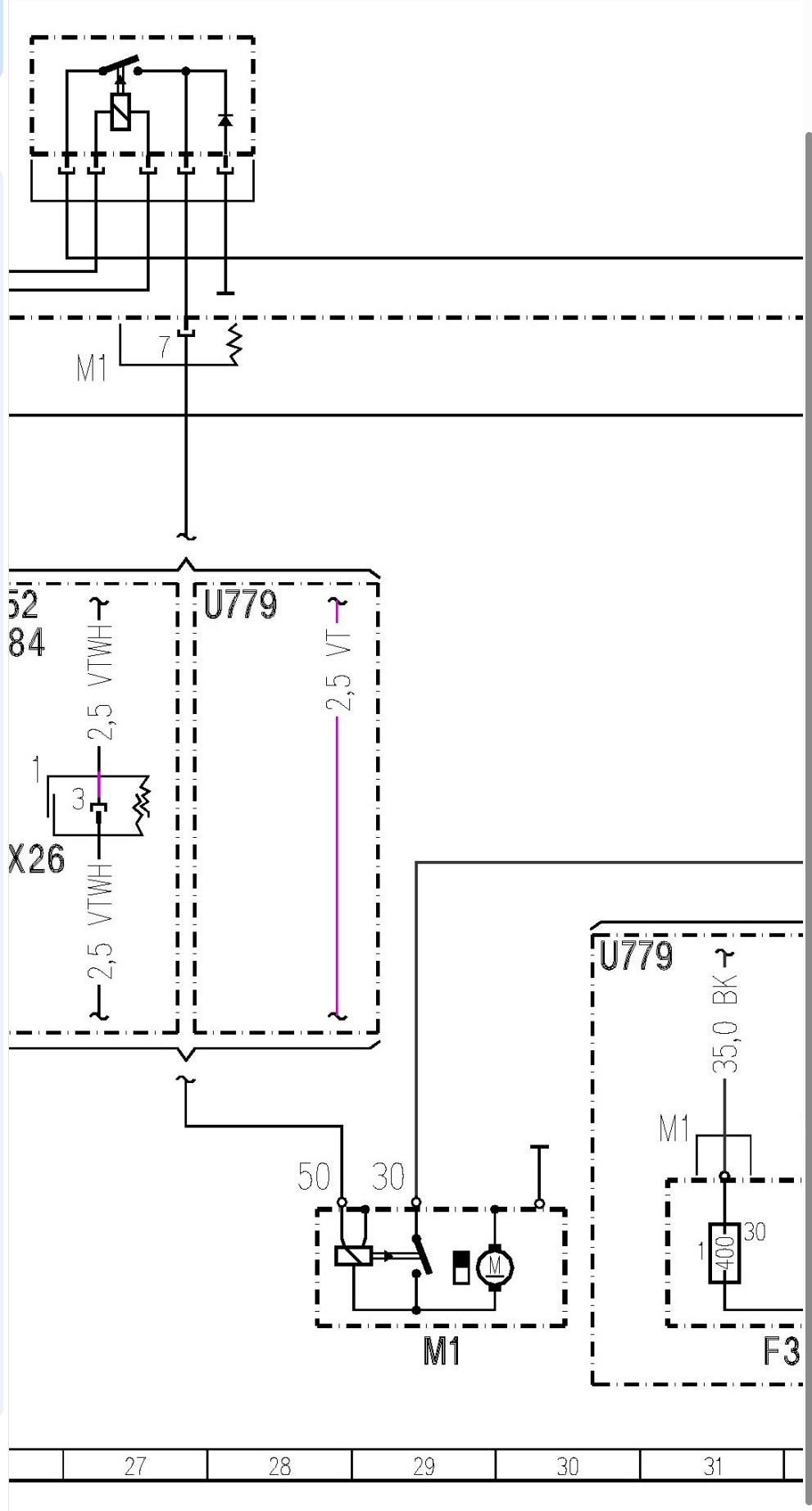

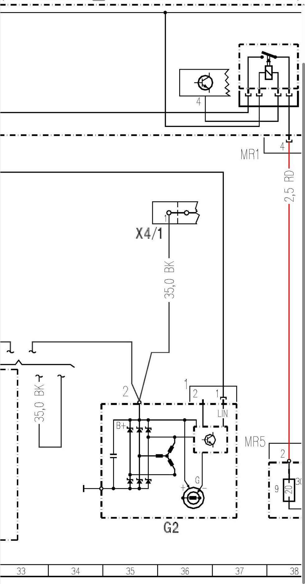

There are no additional ground wires on the starter and alternator.
By installing them they are grounded directly thru the mounting bolts.
Alternator Diagram:
Starter Diagram:

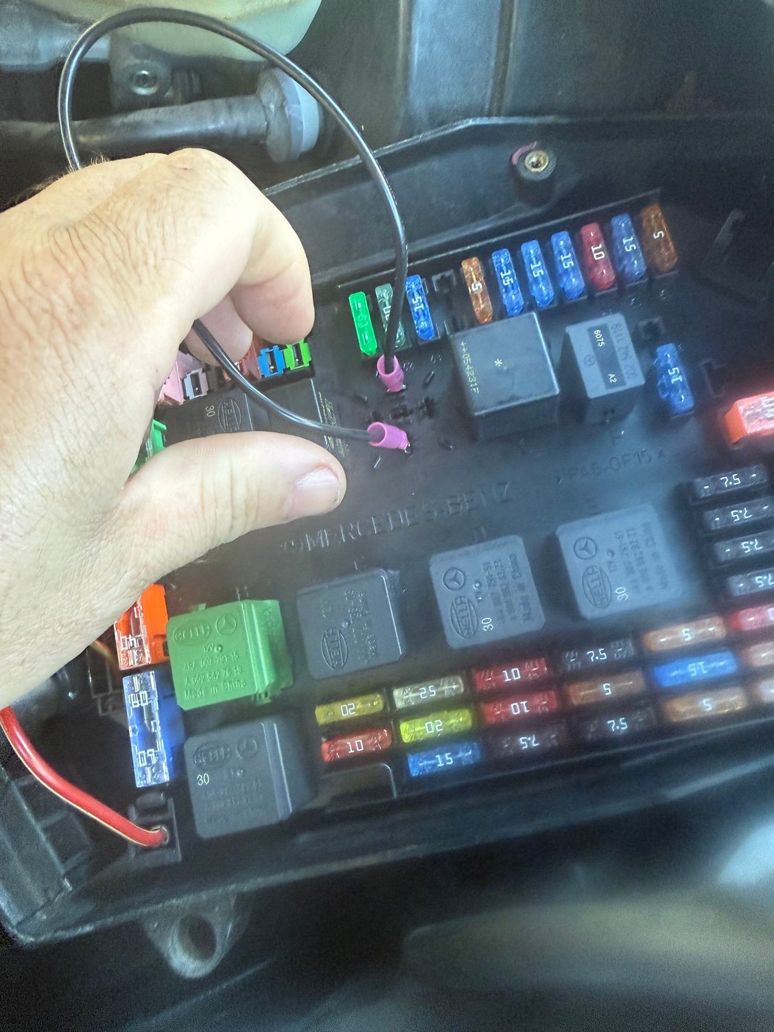

To clarify, I apologize for the confusion. The fact that the vehicle fails to crank with the key in ignition position 2, yet cranks when a jump wire is used in place of the starter relay at the front sam, suggests what?

Among other things it pretty much guarantees that the starter and solenoid are good. So that is one direction you don’t need to aim the parts cannon.
But next we need to know WHICH terminals you are connecting at relay.
That relay probably only gets a 12V+ when the DAS has gone through all checks and sees that key and EIS and TCM and ECM and whatever else are ALL the right ones.
ie, there should be a 12V+ ready to connect to solenoid and another terminal that only goes 12V+ when DAS gives OK. When it gets the 12V+ it pulls the arm down connecting the solenoid to current. There will need to be a ground for the other side of the coil that pulls the arm down.
So with your multimeter, you can check which terminals are getting what current and when.

Pins 30 & 87.. what role would a multimeter play if I were to purchase one, given my unfamiliarity with its operation? Furthermore, the parts cannon comment seems irrelevant, considering the vehicle is approaching 20 years of age.

this is what I followed to get to the one point. I didn’t do the light test.

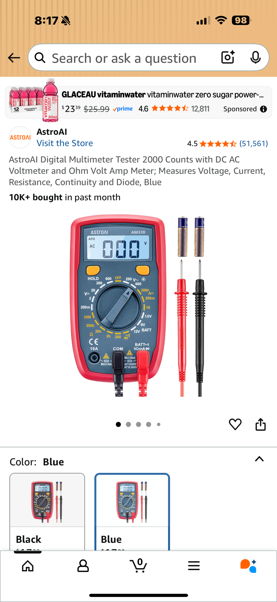

Something like this?

Yes, pictured one is good.
The setting just right of 200 at bottom is resistance with sound for continuity.
So you will get a numeric reading but beauty is you also get a “beep” sound. If you check the meter should be at 0.
So you don’t need to keep an eye on the number. First, touch probes together, you hear “beep” next you touch one to unpainted metal on car and point you want to test for ground, you should hear same beep.

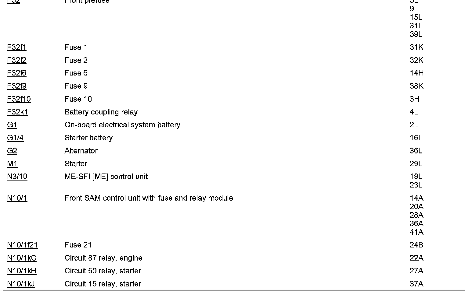

Not sure if this was mentioned but arent there two batteries in the W221? I see two in the starter wiring diagrams.
