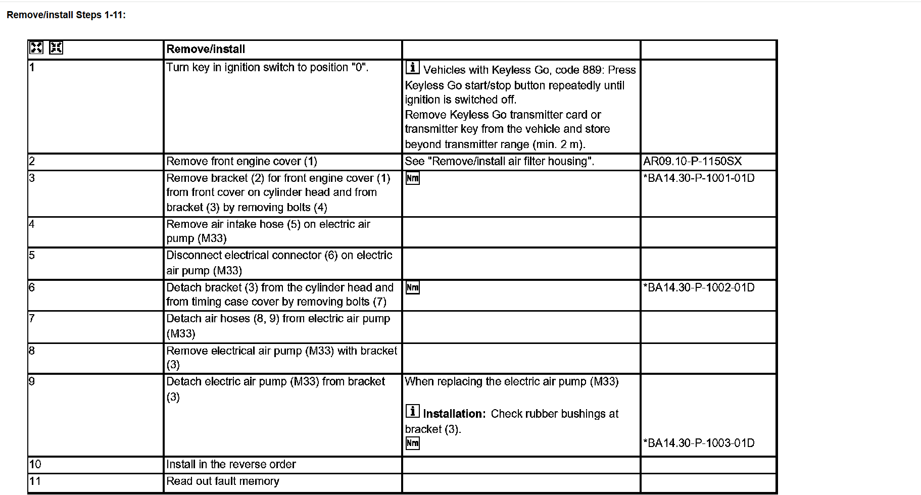

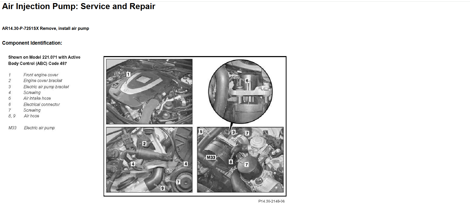

This is not hard...at all....yes, you can do it.
(YouTube Comment - The V6 (M272) shown in this video is pretty easy. If you have the V8 (M273), you're going to have to remove the top alloy radiator tube bolted to the thermostat(2 bolts, with one more just above the oil cooler), and disconnect the upper rubber radiator hose from the tube to get access to the right most air pump bolt. If you haven't been in there before, it's a good idea to replace both O rings (the thermostat/alloy tube and alloy tube/radiator hose connections, and make sure you spray the rings with silicone before reinstallation so they slide into place and fit back together easily) so they don't leak after all that work. You'll probably need close to a liter of mixed coolant or so to top the system back off.)

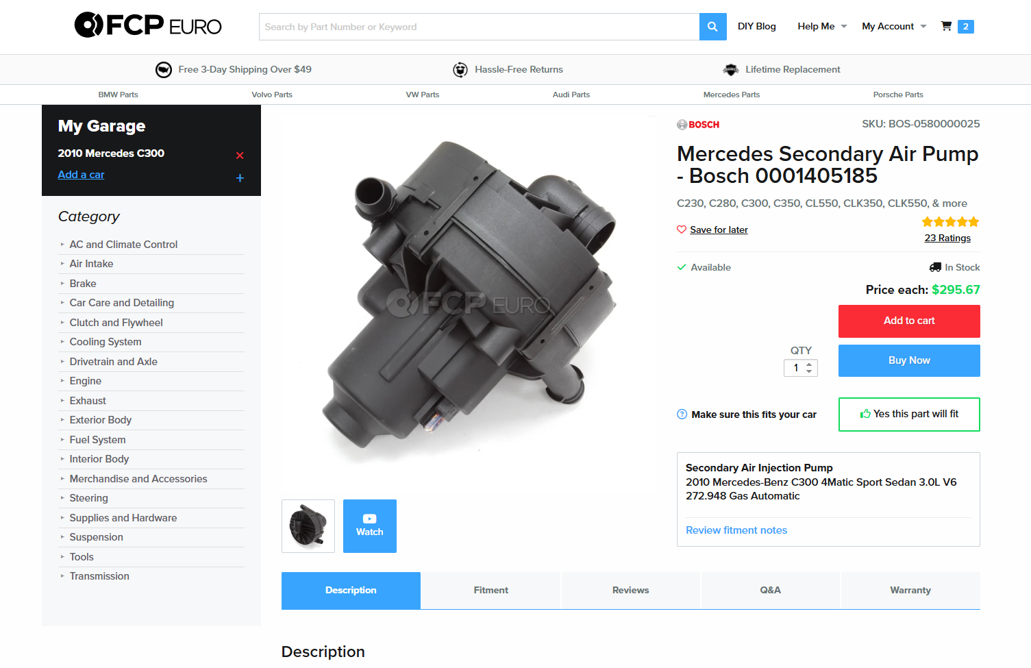

Genuine MB pump is around $800. I would get the OE Bosch pump.

Here's what is in my car. Lifetime warranty also...https://www.rockauto.com/en/moreinfo...t=4920&jsn=552
