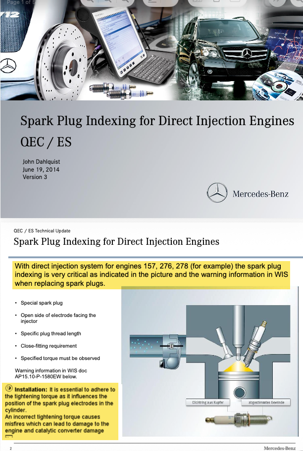

This entire discussion has been covered before. There is also a question concerning the motivation of the author to call out NGK plugs in the document. ANY improper plug may cause harm.

I think the confusion may be because there are two types of engines: those that use stratified combustion and those that use homogeneous combustion. In the US, homogeneous combustion is used and in the rest of the world, stratified combustion is used. I believe indexing is critical for stratified combustion engines and less so for homogeneous combustion engines.
Here is another document that discusses the two approaches.

2007 S550 4Matic 2013 S550 Base
Originally Posted by GTIBlack
The complete document is attached.
Does not apply to W221. The WIS document indicated, AP15.10-P-1580EW applies to models: W212, W218, W207

Mercedes SL R231
Oh, the W221 uses a different type of direct injection? I didn’t know that.

Mercedes SL R231
But document AP15.10-P-1580SX does apply to the W221 (and W216) and says the same thing. So, I’m not sure what your point is.
now that makes for interesting (and confusing) reading
the way I read ONLY the V6 gets the different engine for USA vs the Europe one - check page 8 and 9 no ref to the 278
Good point. In that case, the M278 and other V8s require indexing. Personally, I index my plugs regardless since the WIS says to torque to 23Nm, which is supposed to get the plug in the correct orientation to the fuel injector. Remember, correct orientation is within +/- 45°.
AP15.10-P-1580SX and AP15.10-P-1580SX do not say the same thing and are for different models.
The key points are the same. The engines are the same, regardless of a specific model. But, I still don’t get your point? Are you saying your W221 doesn’t need to be indexed?

Originally Posted by OldManAndHisCar
Does anyone have anything more than antidoteal evidence this is a real issue????
Assuming you plug is seated (with or without a torque wrench)?
All we have is the Mercedes document I posted above about indexing direct injection engines, though some people believe it doesn’t apply to their M278 or M157 because their car model wasn’t listed.
Honestly, whether it’s a real issue or not, I find no harm in complying with the warning to index. 23Nm gets me within that 90° window. Of course, my 6 cylinders are probably easier to work on. I do mark the extension and socket to see how close I am to 0° when hitting 23Nm.
