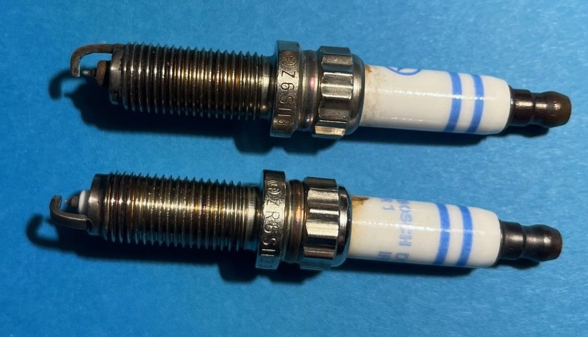

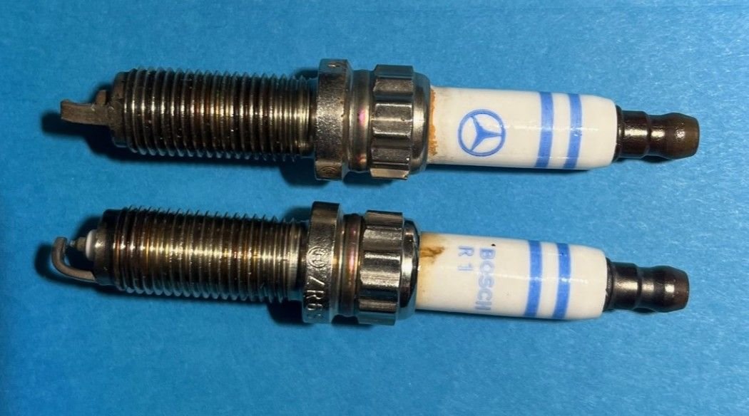

So, continuing this "debate" and I think I found out, as I already guessed, the thread on the spark plug ends/starts in 90 degrees different position between plugs with MB logo and not.
The first picture below shows how the thread ends/starts right behind the electrode on the original BM plug while on the regular plug it ends/starts 90 degrees from behind the electrode. This gives exactly the result what happened with the plugs I bought from FCPeuro, i.e., the electrode opening stopped 90 degrees short from the TDC where the injector is.
The fix for this is to get plugs that are made correctly and I doubt you can buy those other than let MB dealer shop to do the plug change.
The second plug shows the plugs type is not the same. The original plug type starts "Z6S113..." while the type in plug from FCPeuro starts "ZR6S113...".
The plugs that FCPeuro and I know O'Reilly sells (and probably everybody else too) are indexed wrong. I bought 5 Bosch plugs from O'Reilly after I realized the plugs got damaged when trying to pre-crush the washers. I was actually doing stretching on the plugs that allowed for the correct indexing. I then used two very hard material washers and an all thread and flattened the washers and after that sanded them smooth both sides.
Just for anybody doing the plug change: If you buy the Bosch plugs that are sold to fit in the M278 engine (and they don't), get washers sanded down to 1.20mm - 1.25mm thickness so the plugs index correctly. If I do this job again, I'll get NGK plugs that were said to index correctly so installation is easy. Or get the MB-Logo plugs if they are available from the dealer.

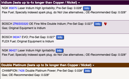

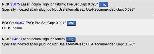

More confusion is that it appears turbo cars (at least for the M276.8XX engine) use one style of plug (6 point socket) and the non-turbo M276.9XX engine uses a different style (12 point socket). Plus, on the NA engines, you have FLEX and non-FLEX Fuel engines.
On the RockAuto.com website, here are the options for the M276 turbo and non-turbo engines:
For M276.8XX 3.0LTurbo Engine
For M276.9XX 3.5L NA Engine

In my post #53 is two pictures of the MB and general plugs. The upper one shows how the thread in MB plug ends right behind the electrode while on the general plug it ends 90 degrees short. This is why indexing goes wrong with general plugs.
The other picture shows the difference “R” in the part number stamped on the plug. Other than this the part numbers are the same.
