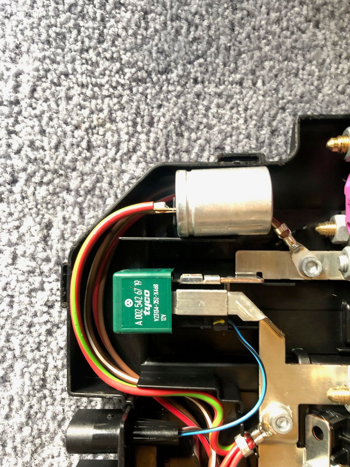

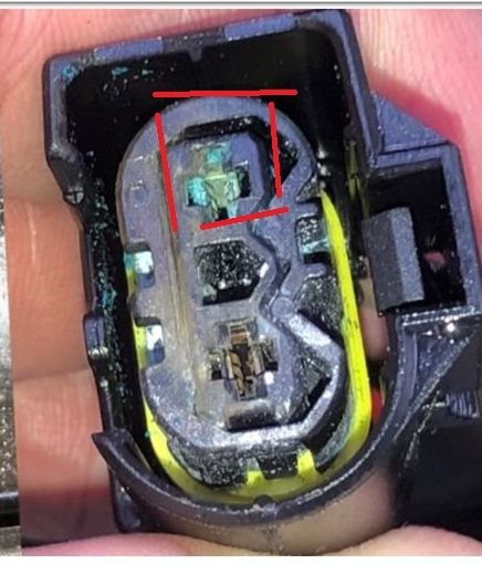

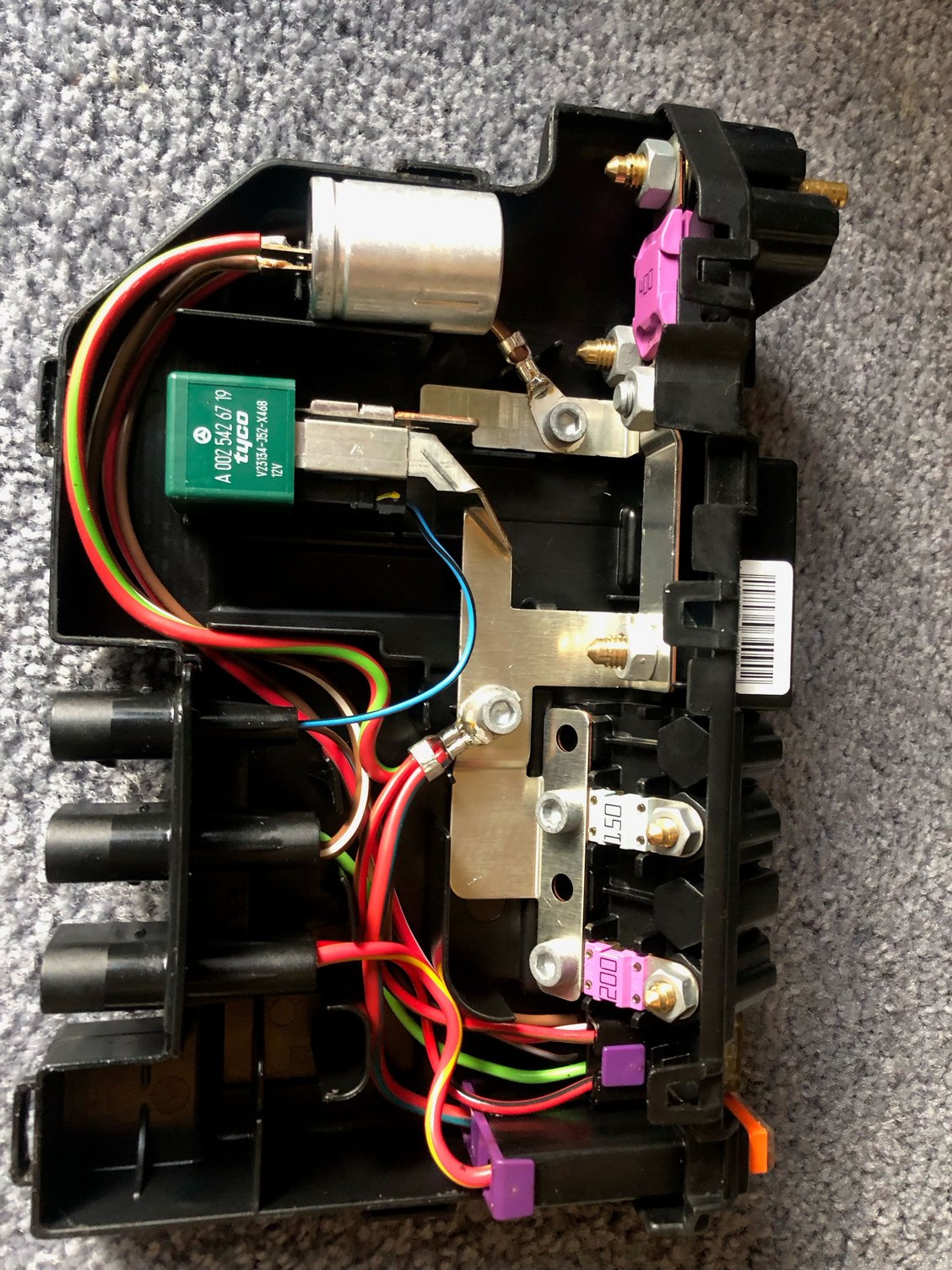

So that was a waste of money - its just a box of air and a few hidden fuses
The 9022 Coupling Relay fault is likely the gunk from the appalling design - that allows water ingress to collect in the three bottom connectors and corrode the wiring / sockets unseen
The box does not split taking off the top as it appears - you split it in half the other way see pics
The Relay is replaceable

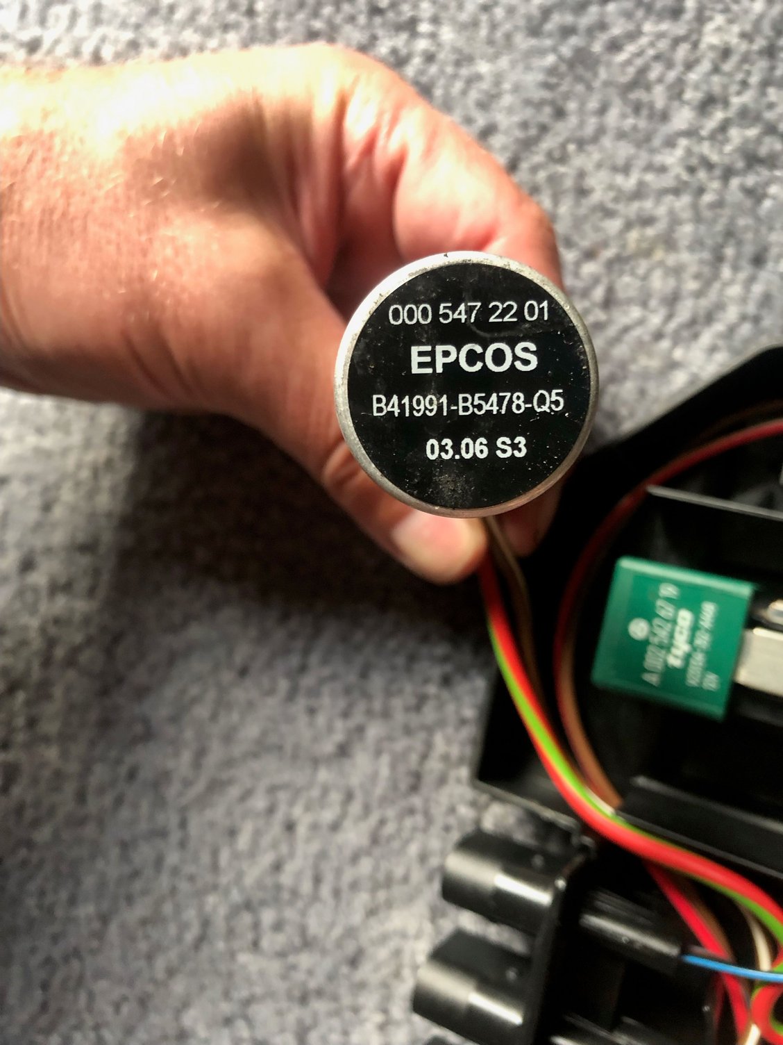

What I presume is a Capacitor is soldered on, but if you can get this would be easy to swap
The new pre fuse box was made in 2024 so its 18 years newer

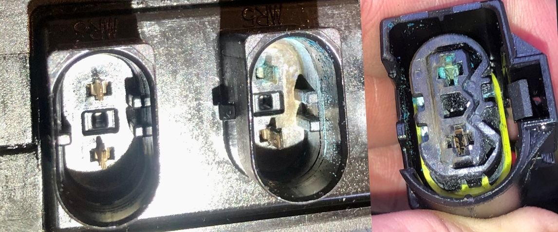

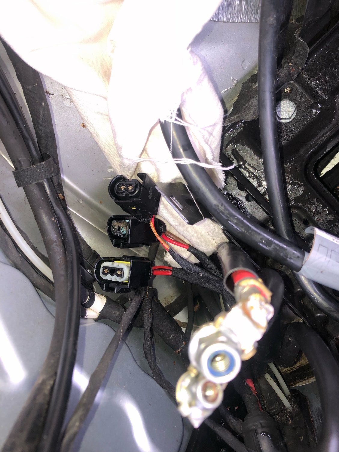

I suggest any of you that want less aggro - pop these bottom connectors off ASAP and check, clean add ACF50 to these stupid plugs and sockets - note whenever you open the bonnet rain spills directly on this box - I guess ending up by design, right where the corrosion is
ALL these Pics are from my 20 year old box

I see they even fitted the Relay upside down - so it can fill with water and never drains
Note the case is not even close to being anything like water tight....
CROOKS !!!

The greened or oxidized pin inside the connector may have the electrical crimped wires " eaten " inside the PVC insulation, so it may look good after cleaning but without a good conductivity.

I don't think it was bad - car seems OK at present (famous last words and all that),
I had some better pics I just reviewed and enlarged - looks like I got it just in time - the point was to remind all others with the early ones to pop them off and fill sockets with ACF50 - that stuff is like magic - designed to stop corrosion on aircraft skins and works great on electrics
