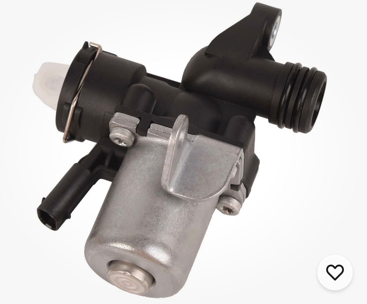

I mean the below heater valve, this heater valve is mount on left side of engine and my car is not equipped wiyh 3 pipes heater valve located behine firewall, however I think both of them perform the same function: 12V supply from ECU then valve close, without power valve stay at open state and let a hot water go to heater core.
Issue of my car is related to control signal from ECU (12v) to this valve, valve only close when I using scan tool to close the valve otherwise valve stay open state even the temperature dial already set to low and heater request is 0%.
is there any other factors to keep this valve open?

I don’t recognise the valve shown in post #4
cars with rear AC have a very similar layout to normal cars - with the electric pump and heater valve as per post 3 - but down inside rear of the front wing (on my car right hand side), is another silly valve and three pipes - as used on the w220 that controls individual rear seat heater flow - they go wrong leaving the trim to melt as it get stupidly hot when the pintle valves leak by - I think that electric pump is the rear seat REST setup
aka this
for $15 you can fix the issue

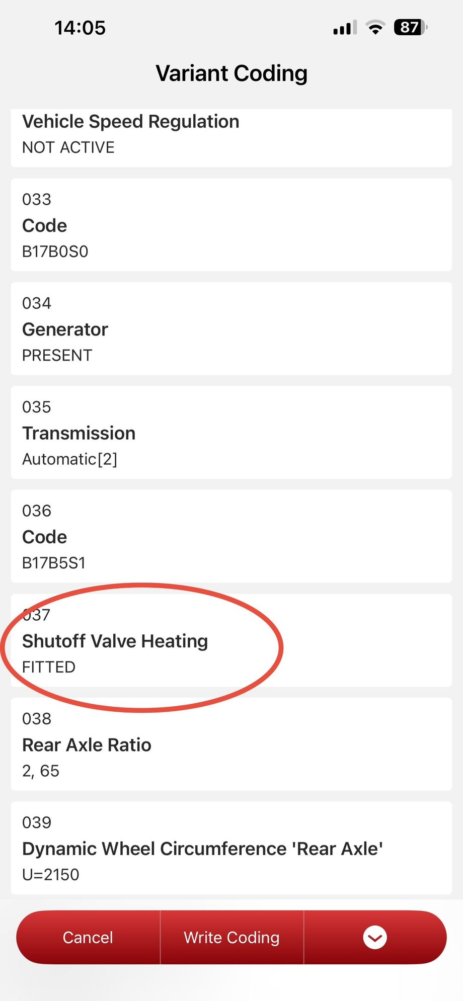

file has two sheets one the engine parameters and the other the HVAC module beside the blower motor

35th line of coding in my file - Row 45 in Microsoft world
I need to check if I have that valve - mine with rear AC is set off too

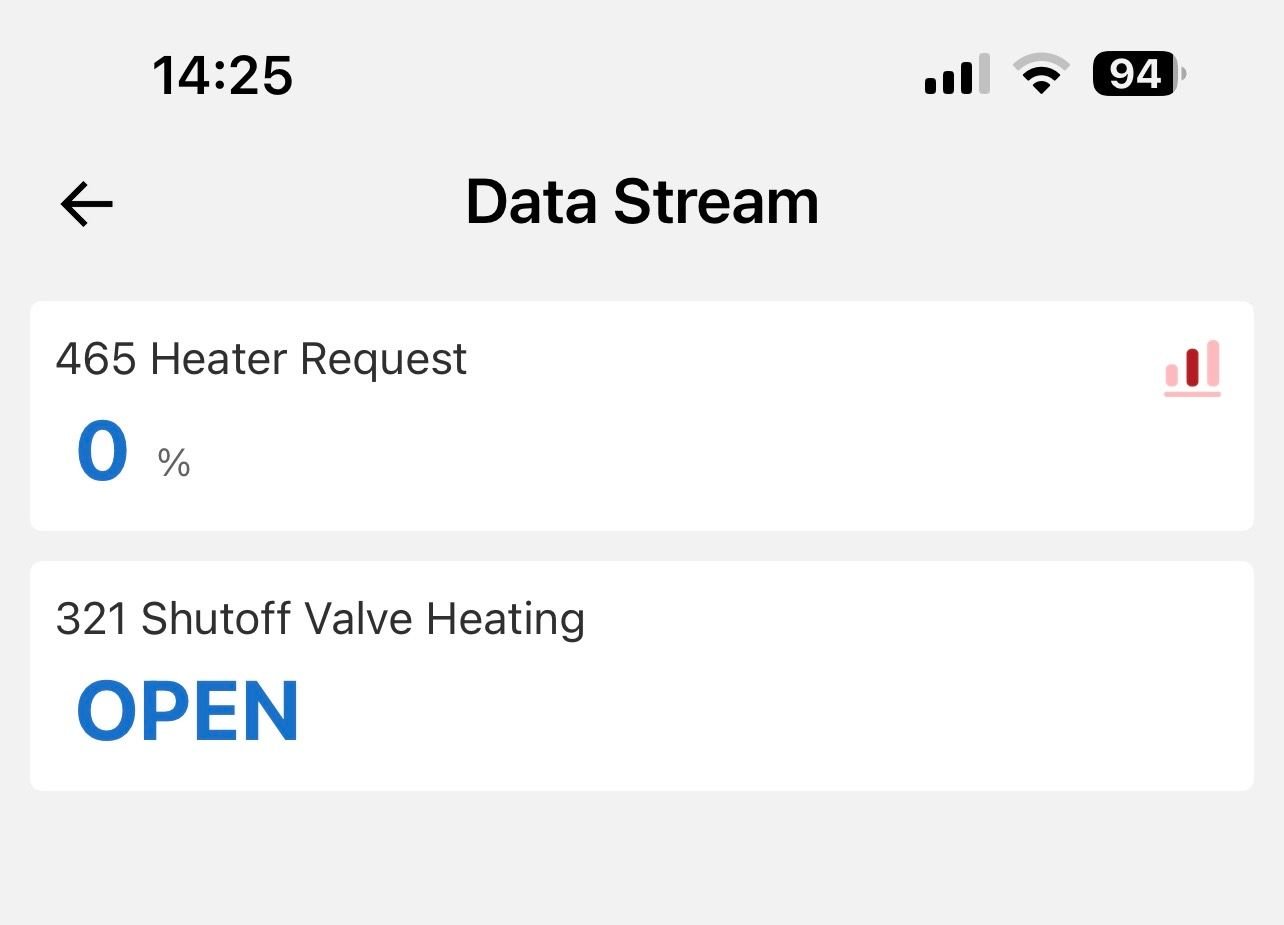

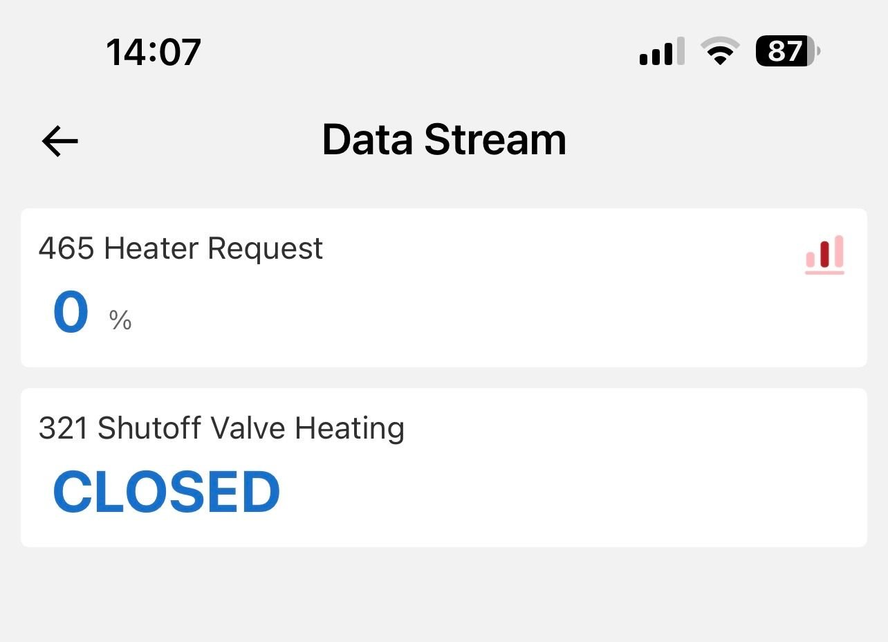

How does it behave from a cold start?
It's not permanently closed regardless of valve position. There is a bypass in it which feeds from the HVAC plumbing.

my car states in EPC it has the solenoid version of the valve as per pic 4, and the heater valve, and the duo valve for rear AC

The valve opens only when there is a heating request (i.e., when the interior temperature setting is higher than the ambient temperature).
Therefore, during a cold start:
  • If no heating is requested, the valve remains closed.
  • If heating is requested, the valve will open.
