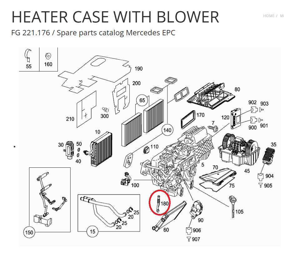

Has anyone dealt with this specific stubborn issue on the W221? Where exactly are the AC condensate drain tubes located on the V12, and how do you clear them? Could this be the windshield cowl drains pooling water near the fresh air intake?

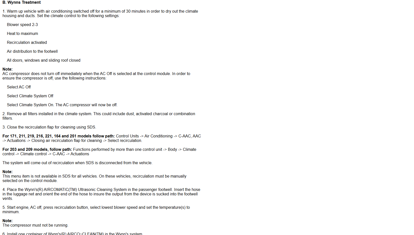

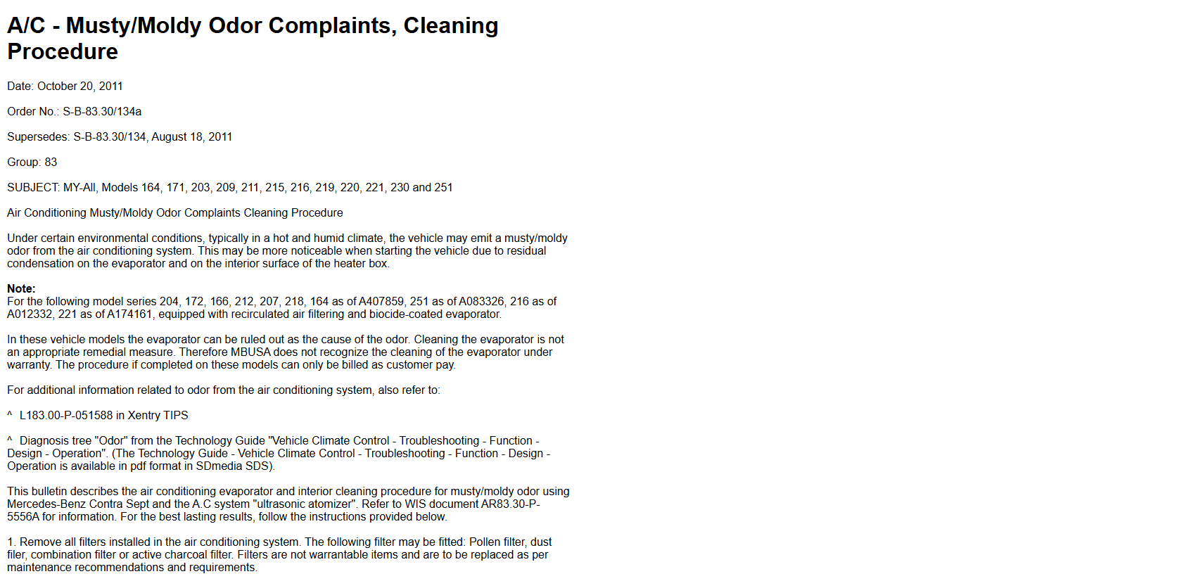

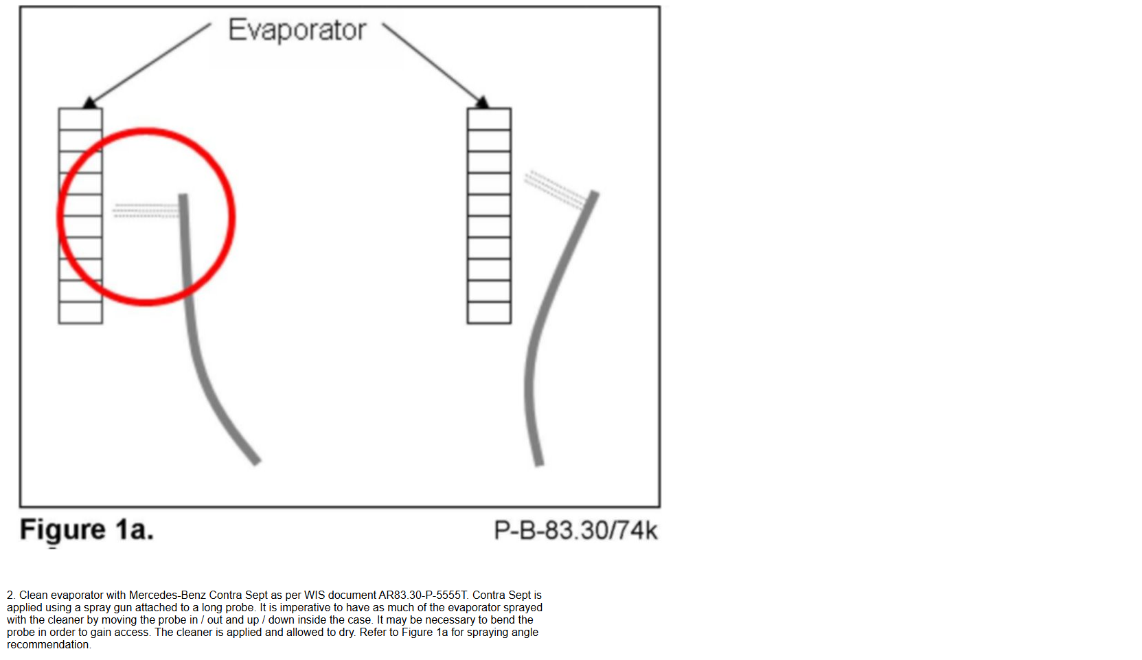

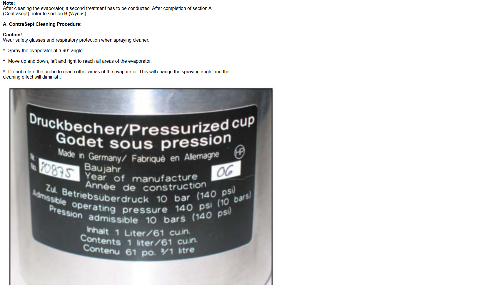

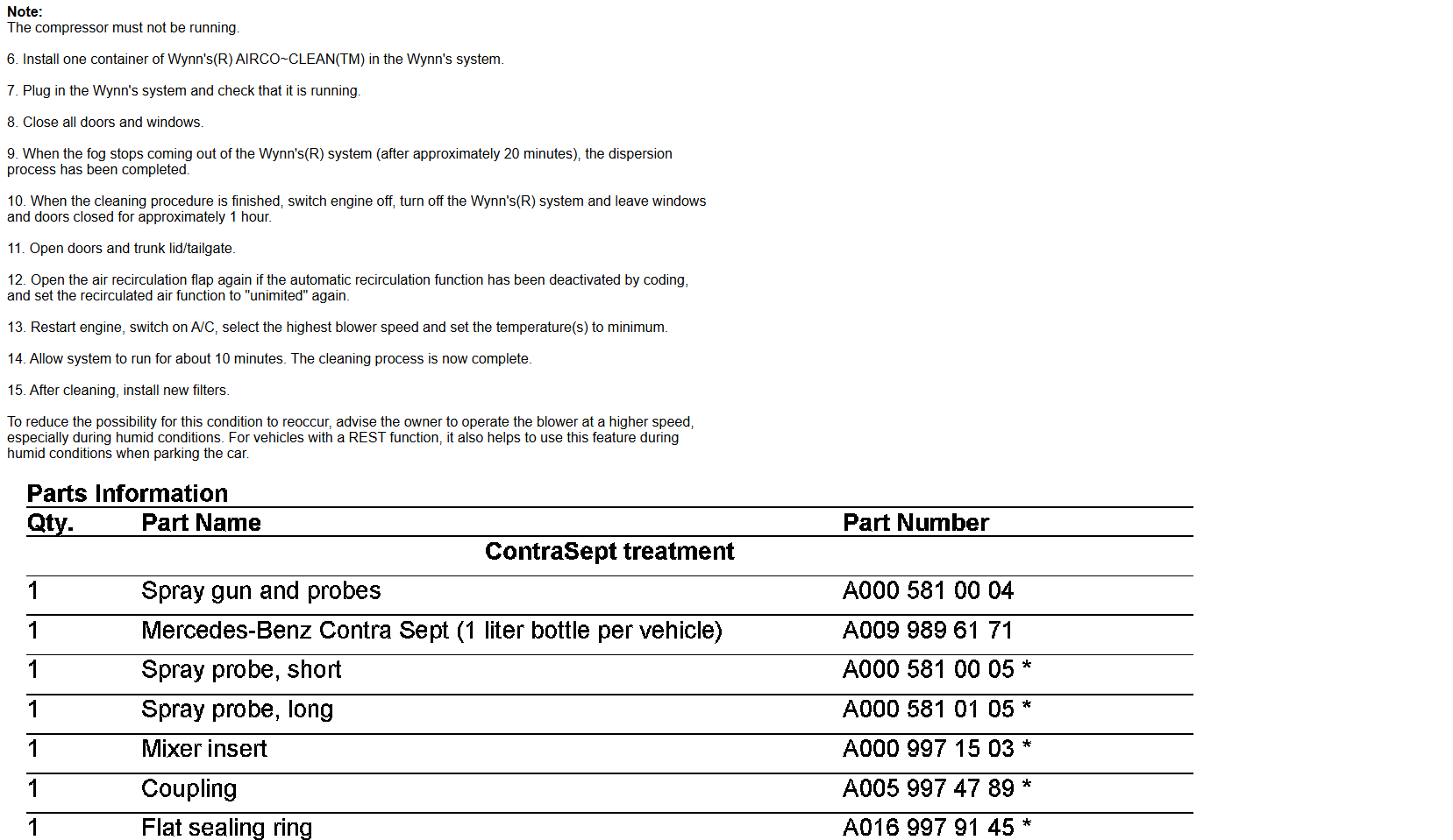

Since you say the smell went away after your cleaning process but came back after a few days i would say you are on the right track. Maybe it wasnt cleaned enough. How did you inject the cleaning product, it shows using an old cabin air filter and making a hole in the cover.
There is info on odors in the hvac. Mentions following strict procedures. It goes on to recommend some type of ozone cleaning.
The drain lines are easy to locate, should be behind the carpet/trim in the foot wells.

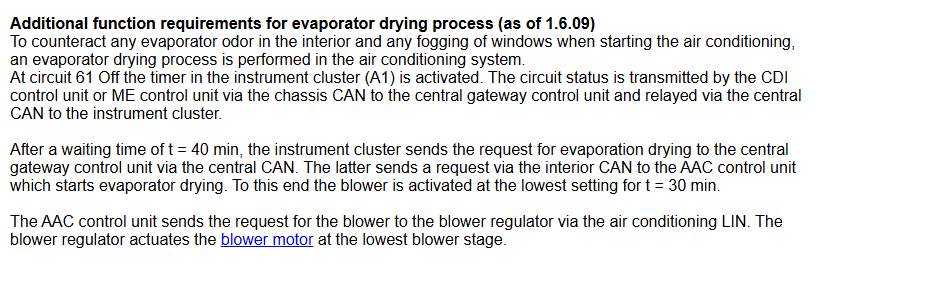

Have you confirmed your car is performing the evap drying on its own after shutting the car off?
