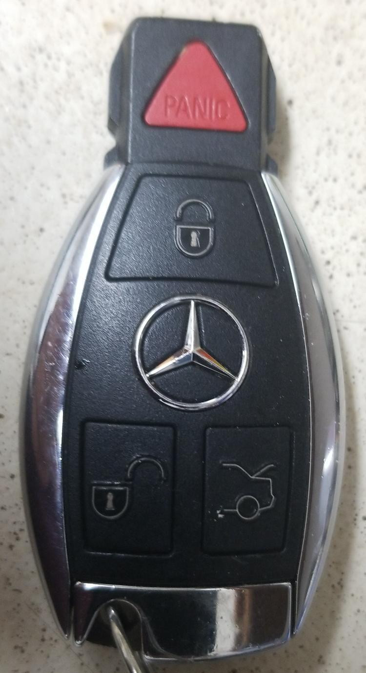

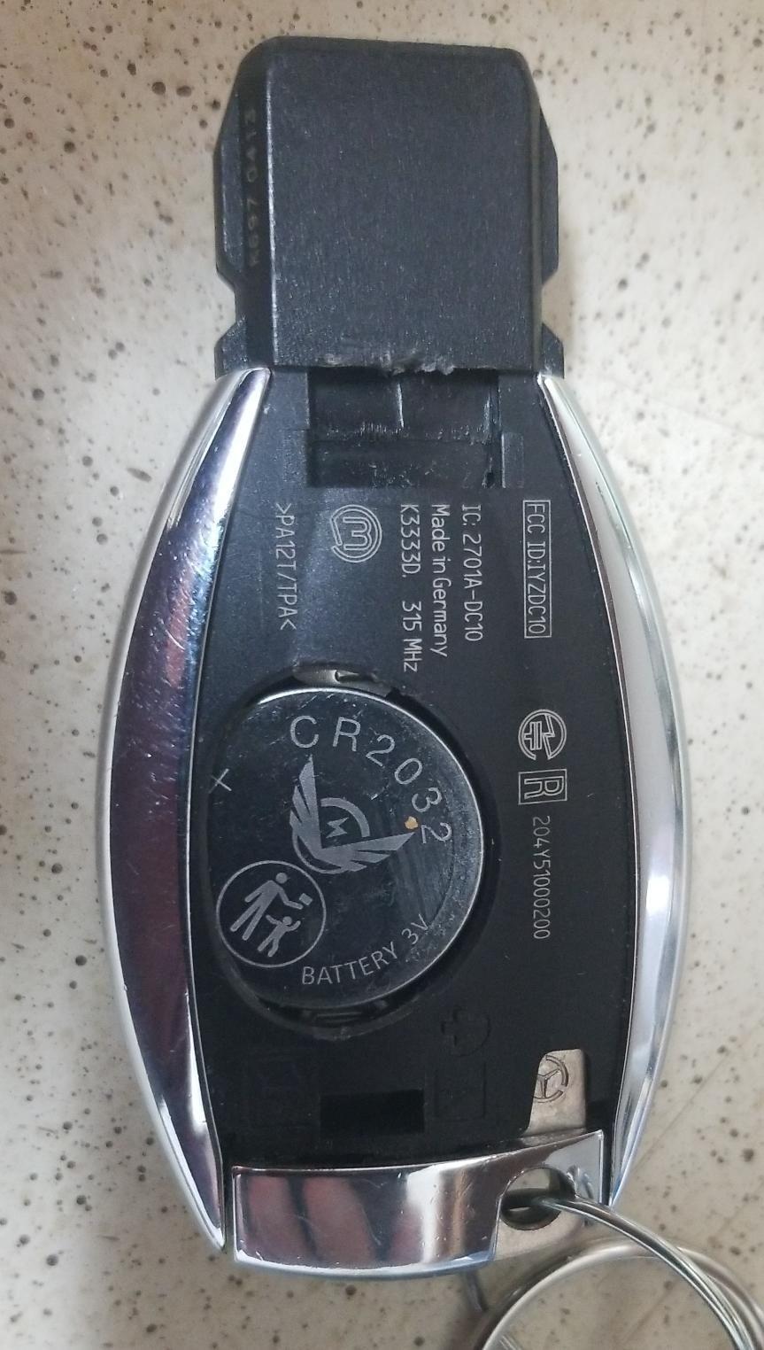

• FCC ID: IYZDC10
• Full passive entry operational
• Door handle unlock worked
• Push-button start worked without key insertion
(Photos of the original key are attached for reference.)

Technical Questions:
  1. Is there a confirmed hardware difference between FCC ID IYZDC10 and IYZDC11 affecting passive entry functionality?
  2. Has anyone with a late W221 successfully restored full factory KEYLESS-GO after losing the original key?
  3. Are there reputable independent specialists capable of supplying/programming a genuine KEYLESS-GO capable key without replacing control modules?
  4. Could this realistically be a coding issue rather than hardware?

Photos of the original key, which I lost, are attached for reference:
