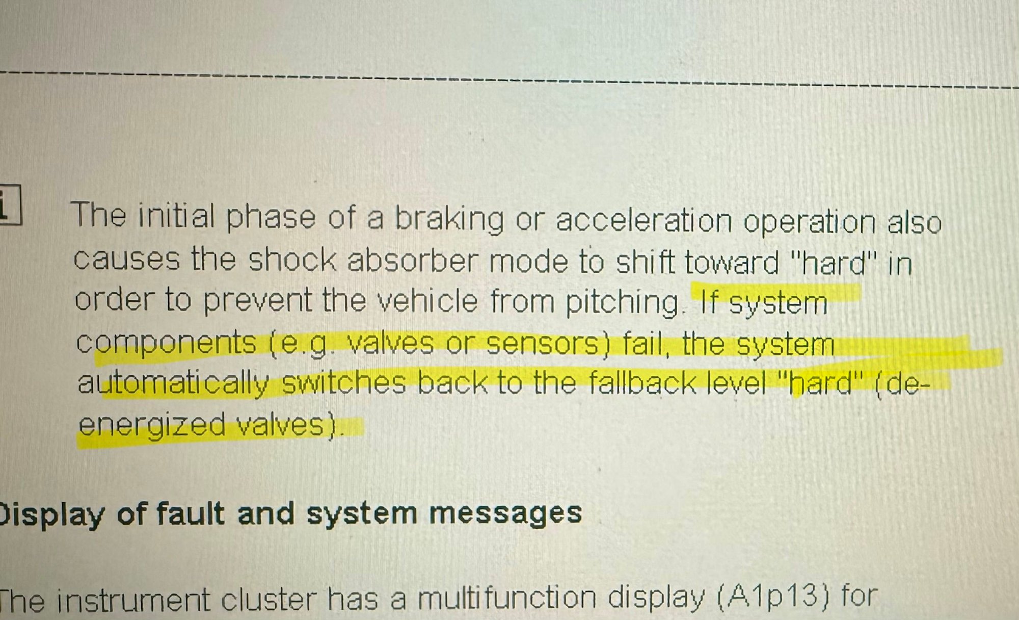

The next thing to make sure you’re doing is the C mode (assuming you’ve got a pre- facelift), S and M engage sports suspension by default.
Also like others mentioned, make sure there are no stored/current faults through OBD, as these could put the suspension in its hardest setting.

Based on my 6k km driving the w221 elevated, I can’t say I agree with the statement that the suspension response is stiffer. If anything it’s a notch more wobbly and only on uneven surfaces.
The only time it felt stiff and uncomfortably so was when there was an airmatic error due to dirt in the front LH strut connector, cruising at 80kph on the highway felt like bouncing a baskball underneath, but that got cleared after cleaning the connector with Liqui Moly Pro-Line Elecronic Spray (which I highly recommend).

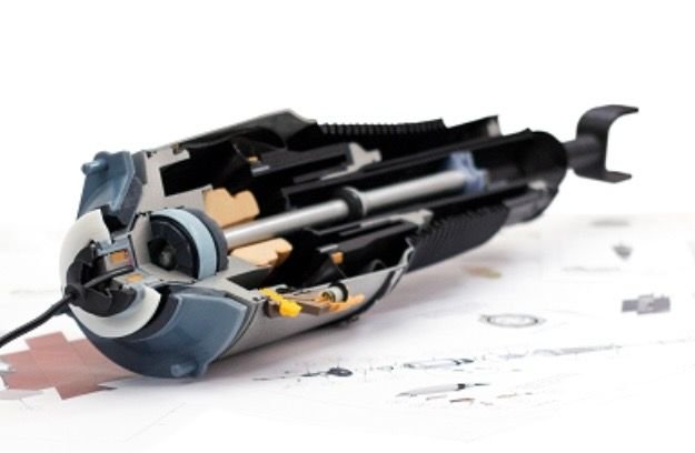

Originally Posted by Arrie
Does anybody in the forum have a cross section drawing of the front strut that shows how the air spring is built? I have not been able to find one.
Found this picture from Arnott site. It is a bit difficult to see, but the rubber bladder is mounted between the two small yellow points wrinkled and folded above the big yellow bump stop. This is called, I think, a “rolled sleeve” design where the air bag changes length rolling over itself. This is used especially for not over stressing the air spring rubber material.
The cross section area of the spring does not change between lengths so the pressure inside the spring stays the same with all lengths (=car level). Adding air just makes the spring longer and pressure comes from the weight of the car on the spring.
And yes, PV = nRT

I'm running 36 psi on all 4 tires, as that's what is stated on the tire. Mercedes says I should be at 33psi, I guess I'll lower it to 33 psi and see if there is much of a difference.
do you have any stored or current codes?
If so, you need to clear them because that will actually put the suspension in the default hard setting. Other folks have said so and I wasn’t so sure about it but as it turns out, it is correct.: any failure of any sensor or valve will de-energize the solenoids and the adaptive damping system shock and you will have the hardest setting rebound and hardest setting damping.
(The deenergized valves referenced here are the solenoid valves on the shock, not the valves on the air Matic air spring.)
There are a few videos on YT regarding the repair of these valves. They're pretty much the only component that can be worked on without removing/destroying the strut.
