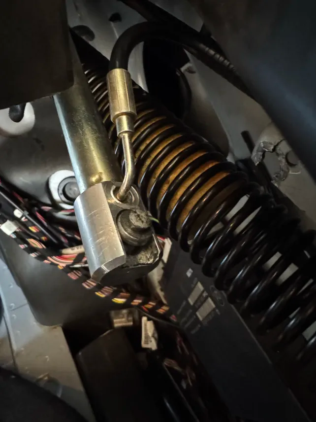

I have a 2006 Mercedes S500 (W221). This part is located in the trunk and is responsible for the automatic trunk closing.

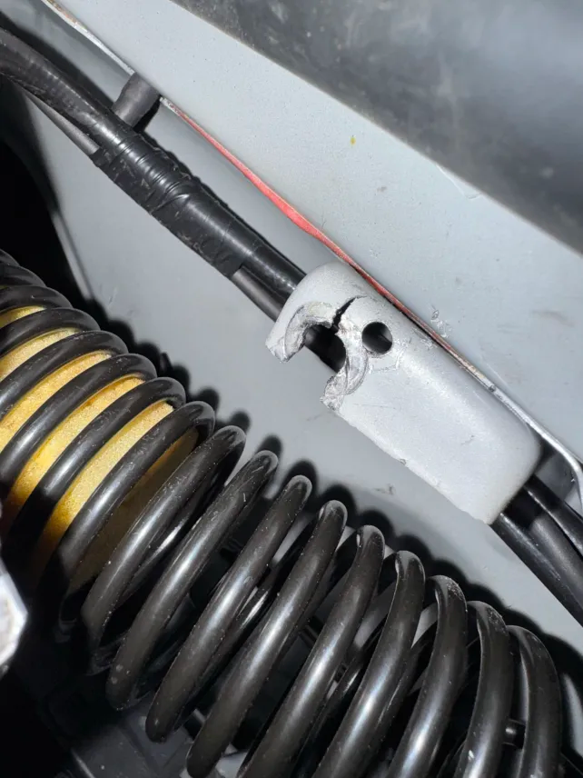

Does anyone know if this part is repairable? Has anyone had a similar issue before? Do you think it’s possible to weld or fix the broken bracket, or does the whole unit need to be replaced?
Thanks in advance!
Second question: Is the part itself (the piston) is intact and not broken, nothing is missing from it, right? Like a circlip, for example?

Yeah that's going to need welding and reinforcemennt, maybe with an extra plate if room permits.
I'd say take it to a body shop

Anything is repairable bro. eBay if your resources for said repair are lacking.

Thank you for your response! In your opinion, the part itself (the piston) is intact and not broken, right? Only the bracket needs to be welded.

All repairs range from anything from JB Weld to actual hot work.
What you can do is metal bond two washers to either side of this cracked flange after you force the crack shut. Then screw the ram back on and it should hold.
this is what JB weld/araldite is for

Probably not worth the time or effort when a new bracket can be pulled from a yard or off eBay for probably next to nothing.

Is there a repair piece or replacement bracket plate?
Be in rear end structure on the EPC.
