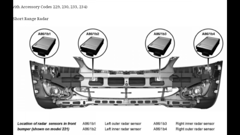

Xentry leads me to one sensor on the left side behind the bumper, and this car also has Distronic and speed limiter options

according to this the component you mention is an inner left SGR radar - for cars with Distronic Plus - has someone tried to upgrade the car ?
