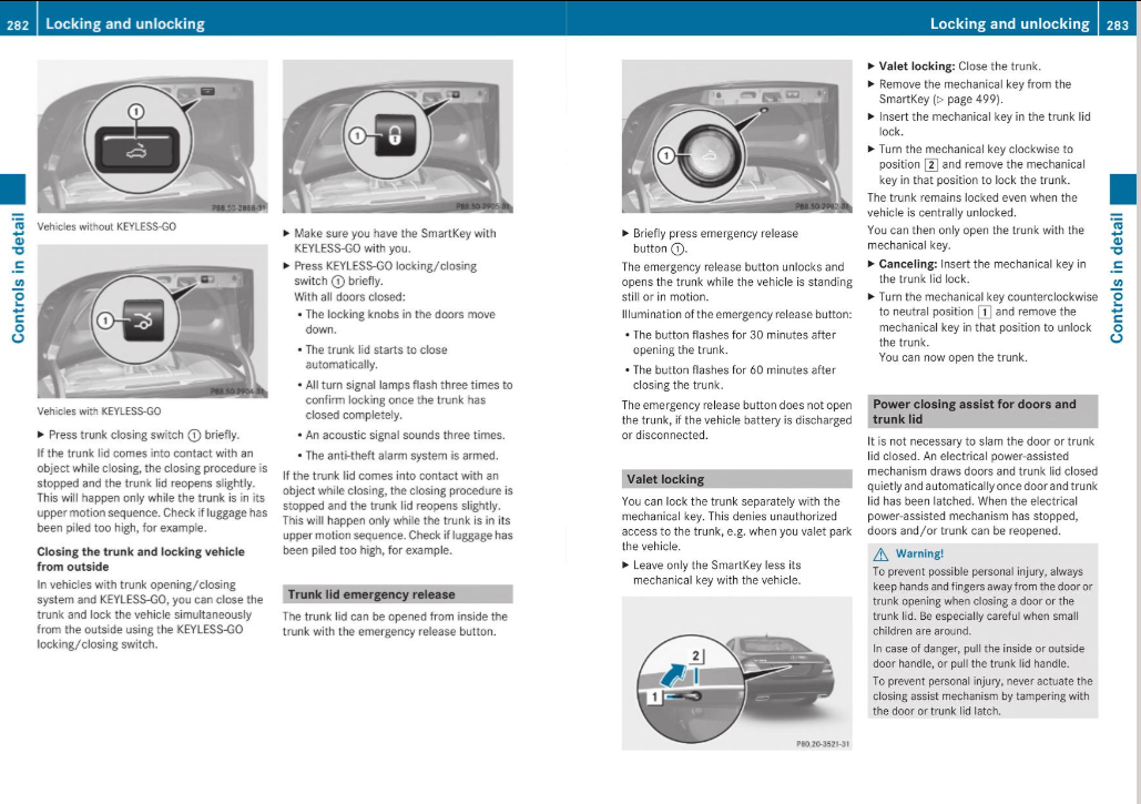

When you press the trunk open button on the key fob do you hear any noises like the lock trying to move?
Is there a trunk open button along with the window buttons on the drivers door?
You say the trunk lid handle is stuck in the open position, it doesnt move?
Have you tried pushing down on the trunk to see if it reengages the lock.
have you tried scanning the car for any trunk related fault codes.
Do you have folding rear seats or a pass thru arm rest, can reach in the trunk and hit the emergency release to see if that works.

Its almost like its in valet mode, except the mechanical key doesnt work.
As noted above spray a little penetrating oil on the mechanical key and see if that frees up the lock.
