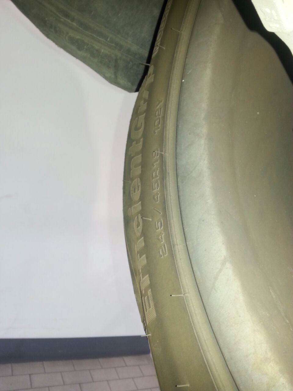

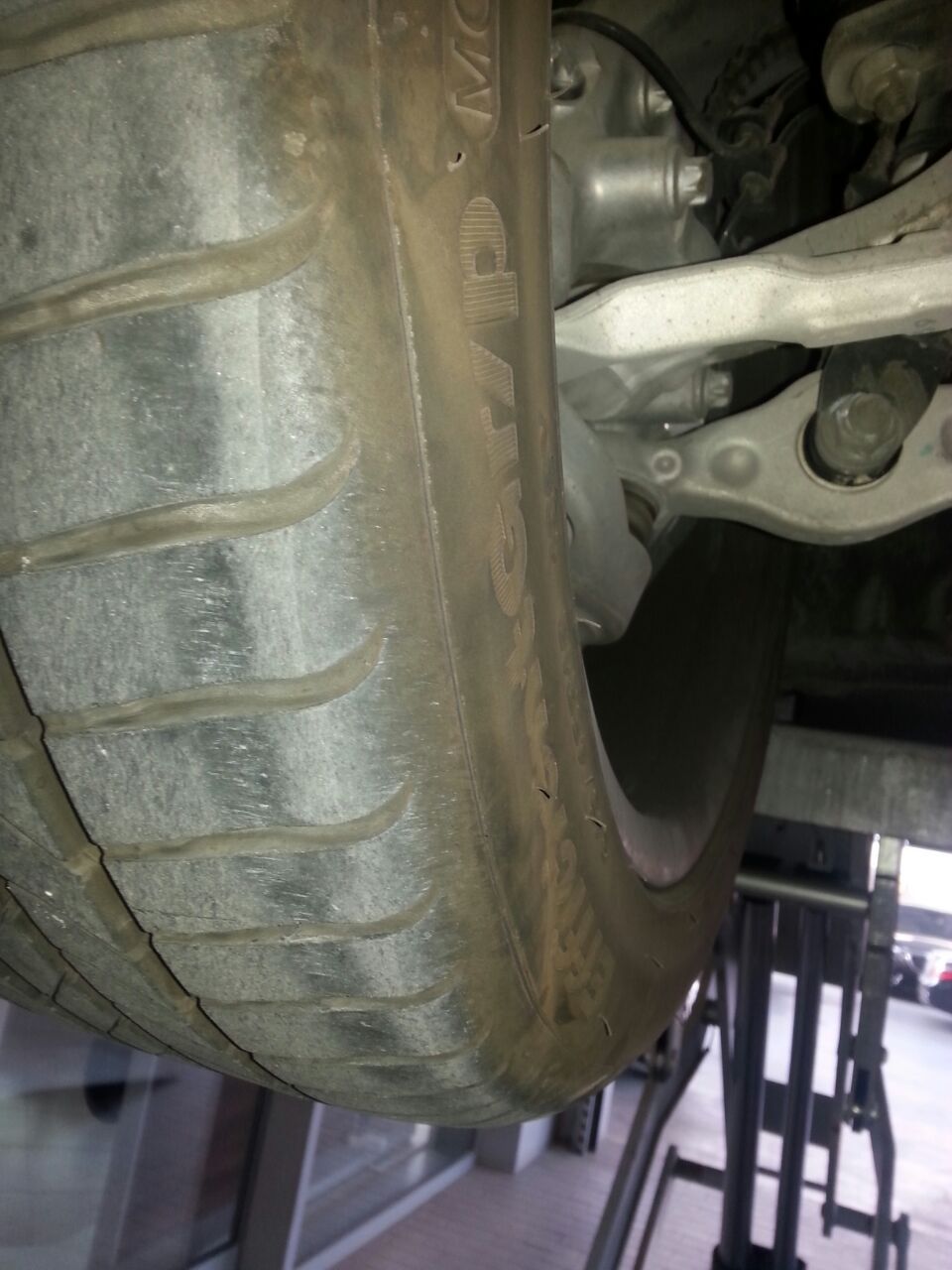

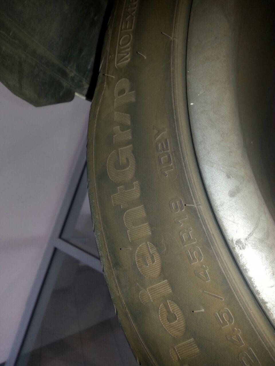

Hi all,
In my dad's W222, the inner front tires (both) are worn out and the service center is trying to blame it on him, saying he hit something when he did not. They want him to replace both tires at 30k kilometers. What could be the cause of this? I briefly saw online negative camber. Could this be the problem and the service center doesn't want to admit and pay for their mistake? I am going to visit them in 12 hours to negotiate this.
Pictures attached. I know they're not very clear.

it almost look like it was low on air and it was sitting in one place for some time with low air or no air at all.
could be a defective tire/tires.

From the pictures you're posting it really does look like the tires are damaged. How that damage happened isn't clear, obviously, but it happened a while ago or else the wear wouldn't be there.

That damage is representative of an impact injury to the tire carcass.
No amount of camber could produce such a failure.

Thanks for your feedback. That is a reasonable impact for such damage when I come to think about it, which the service advisor should have known.
