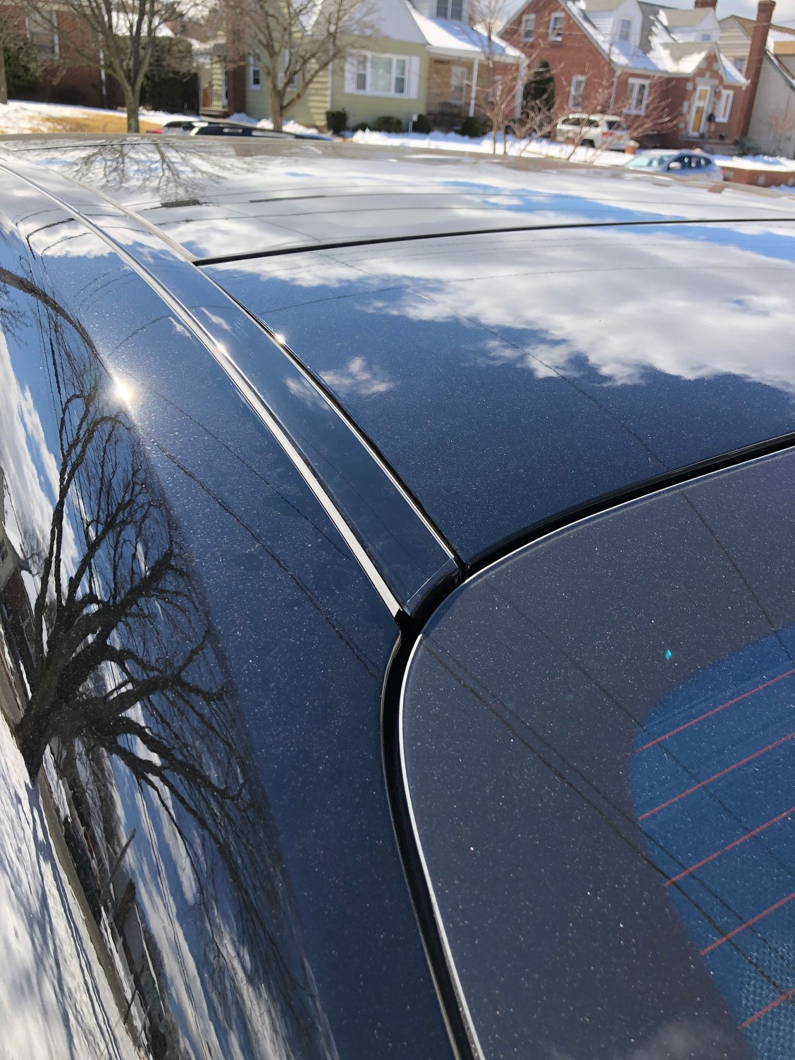

In roof photo, the piece on the left side between the body and sunroof is pretty loose and the right side is tight. I’m hoping this is the cause for the win noise. For some reason the door also looks alittle bit misaligned to me.
There's an easy way to test if this is the culprit. Take a roll of duct tape, tape up all of those gaps, then go for a drive. If the issue goes away or is mitigated, then that's the problem.

I’m gojng to try that and I’ll reply back if it helped at all. Hoping it does. I absolutely love the car and I can tel it’s very quite but wind and loud outside tire noise drives me crazy with a car this price. Also when these tires run out, im gojng switch is to the Michelin 4s. They currently gave me the Michelin 3s.
