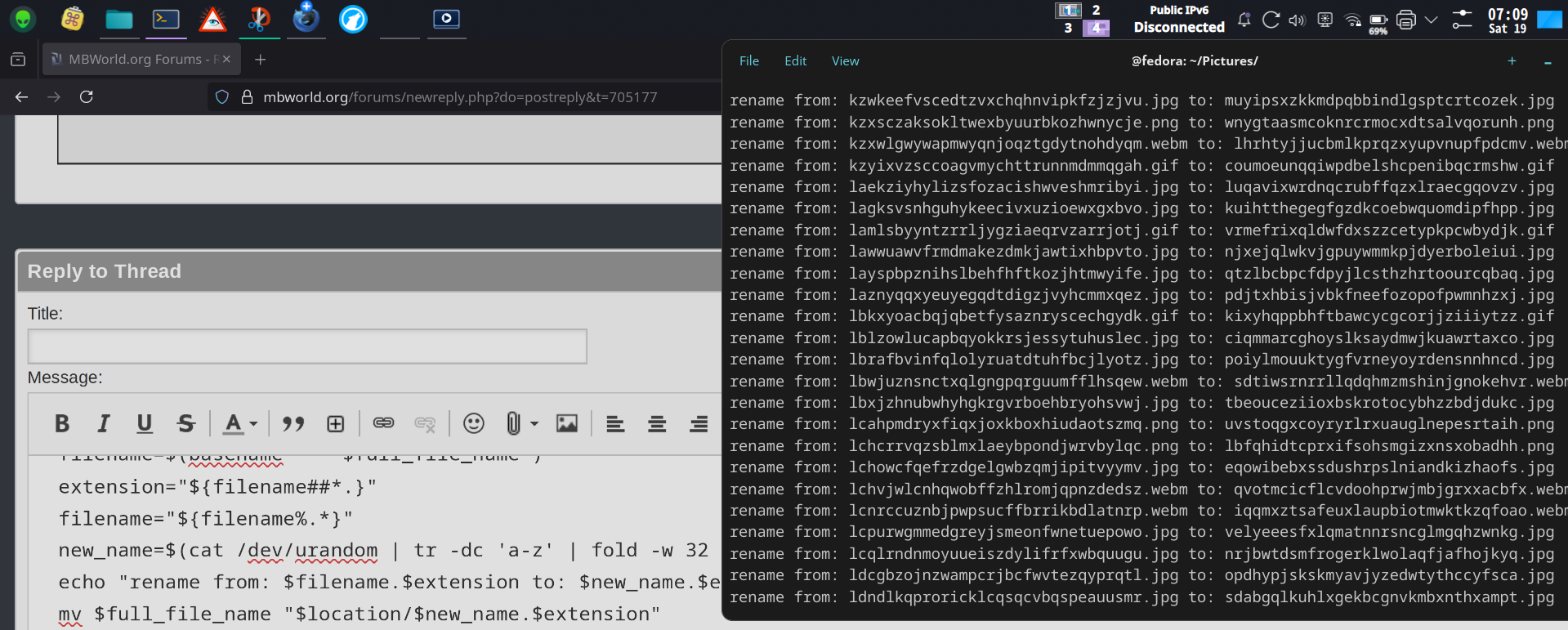

RTFM. Page 217. If that doesn't work, here is a simple bash script. This will randomize the files in your folder or folders.
Code:
Code:
location=$1
echo "before"
find $location
for full_file_name in $location/*.*
do
filename=$(basename -- "$full_file_name")
extension="${filename##*.}"
filename="${filename%.*}"
new_name=$(cat /dev/urandom | tr -dc 'a-z' | fold -w 32 | head -n 1)
echo "rename from: $filename.$extension to: $new_name.$extension"
mv $full_file_name "$location/$new_name.$extension"
done
echo "after"
find $location
I'd have done a neat screen recording for you, but the forum software is stuck in the early 2000's and doesn't do modern, space saving video formats like .webm.

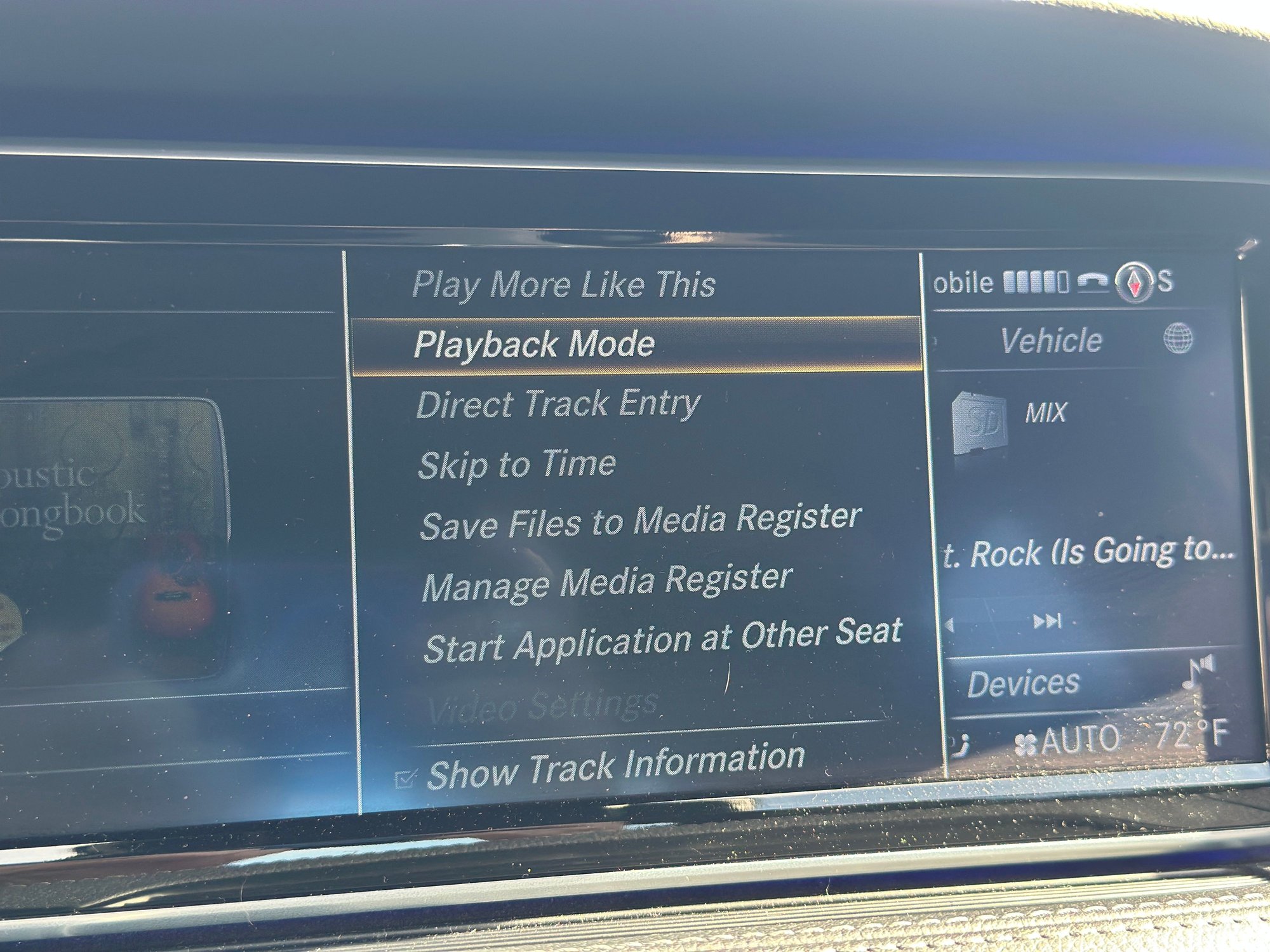

Third update...figured out the "shuffle" option. Apparently the word SHUFFLE would have been too easy or low brow for mercedes to use, so they chose to list it as "RANDOM MEDIUM".
To find it, you need to be in the MEDIA section (press the MEDIA button). Next, pull down on the control wheel to expose the menu bar at the bottom...click on Options. Then click Playback Mode and finally, select the bottom option "Random Medium".
This will randomly select music files throughout all the folders in your MUSIC folder on your SD.
Hope this helps.
Select
Select "Options"
Then select
Then select "Playback Mode"
and finally, select
and finally, select "Random Medium".
