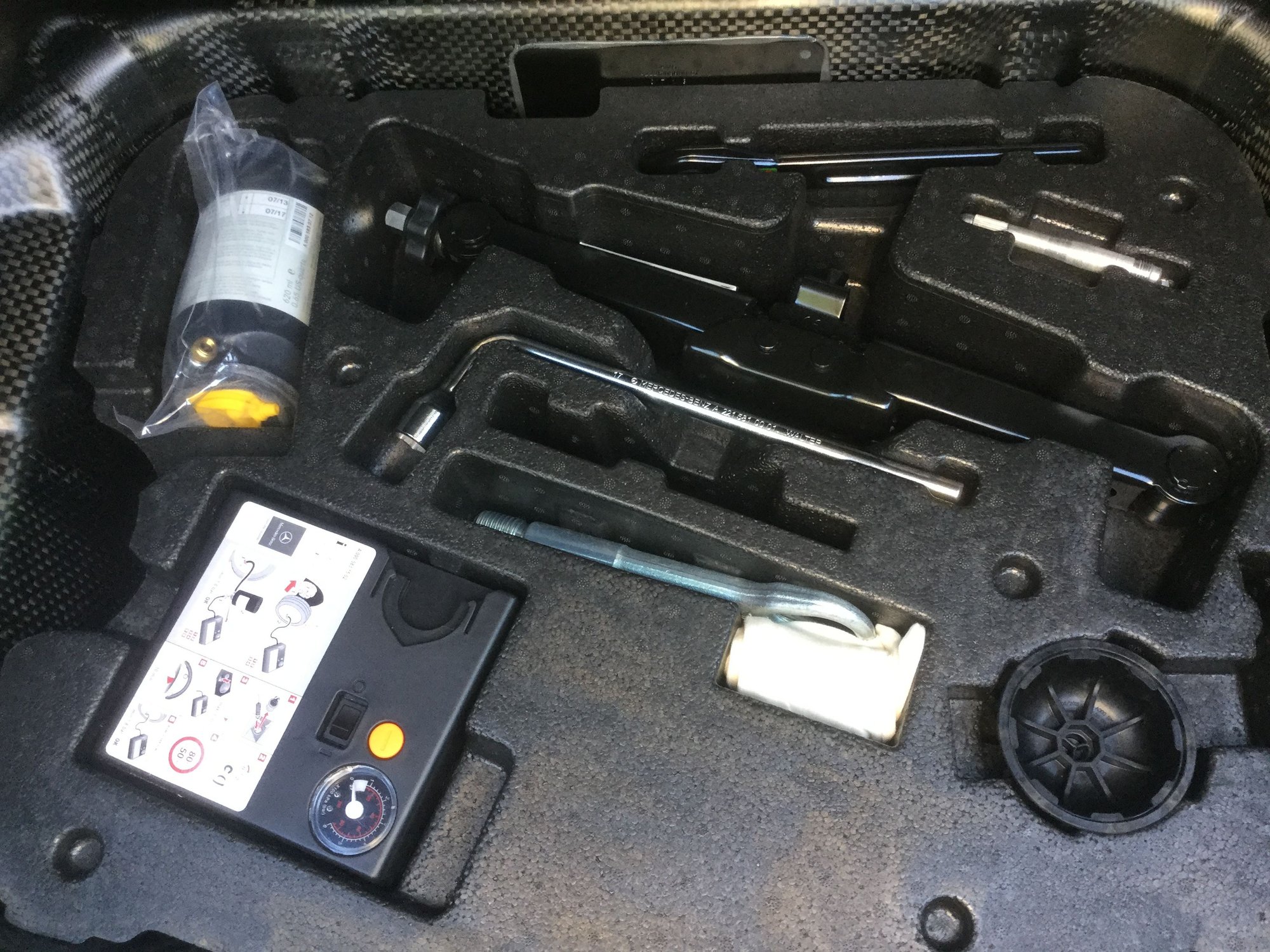

This came up in the AMG S63 forum the other day , seems different years got different things. MY2014. had summer tires ,not run flats and this is what was OEM in that year

Great, thanks for the pic. So a fix-a-flat type can, tire iron, air compressor and a couple other bits it looks like. My equipment holder isn't that big, so it looks like I'm just missing the fix-a-flat and air compressor. He did leave the metal bar with the thread at one end and the loop at the other, any idea on what that is?

The metal bar with the thread at one end and the loop at the other is a towing recovery eye. Remove the square, rectangular or round/oval cover in the front or rear bumper, attach the recovery eye and tighten. Used for towing and recovery. Common in many, mostly German, vehicles. Generally plated and not painted.
Another threaded bar, tapered at one end, is a centering device for a mini-spare. Generally plated and unpainted.
Another metal object, not a threaded bar but generally the same size as the others, is the ratcheting jack handle. Generally painted.

Thanks chassis, makes sense. I guess mine just came with that, the air compressor and the "TIREFIT" tire sealant bottle.
