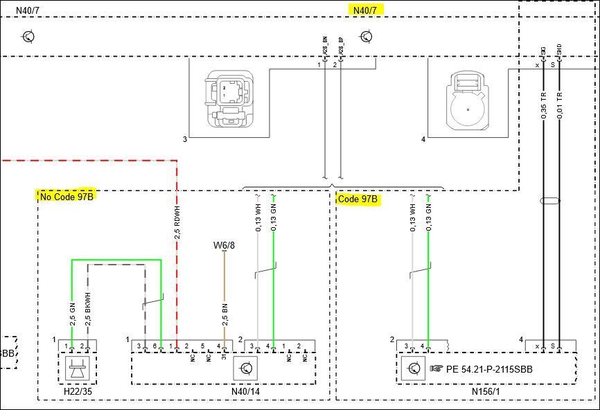

Does anyone know more about this feature:
97B ENGINE NOISE REDUCTION VIA SPEAKER (EOC)
It seems like my car has a failure saved in relation to this feature and now I'm wondering if this is the problem. I just did a test drive with a technician at Mercedes and he said what I describe is not a wind noise issue. He was not sure whether the insulation of my cabin was somewhat out of the ordinary. He said they don't get that many S-Classes and usually don't test drive them so he can't compare.
Old Oct 19, 2021 | 10:24 AM
konigstiger's Avatar
Posts: 15,901
Likes: 4,630
From: North Scottsdale, AZ
'71 Pinto
Feature built into audio system, amplifier reduces unwanted engine noise using counter-phased sound waves.

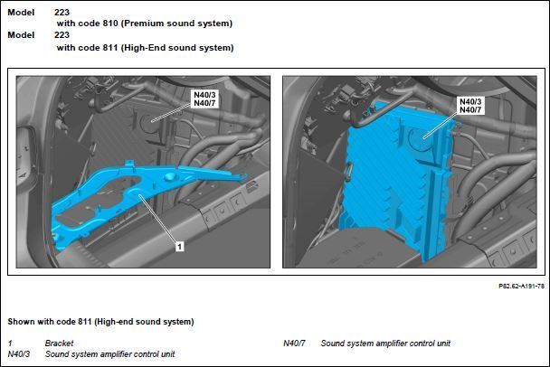

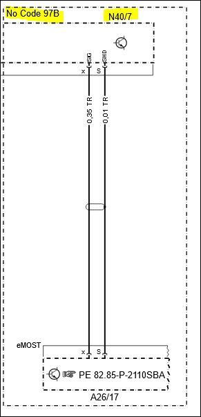

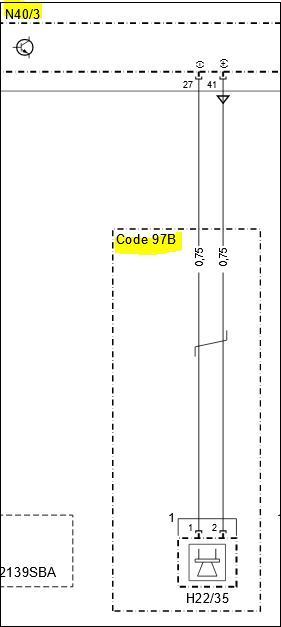

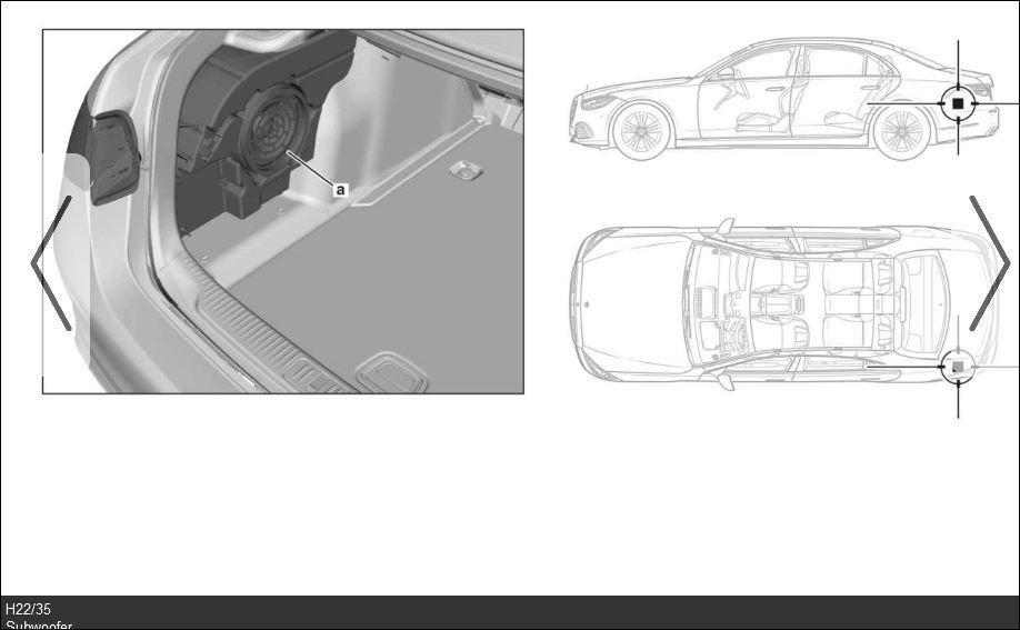

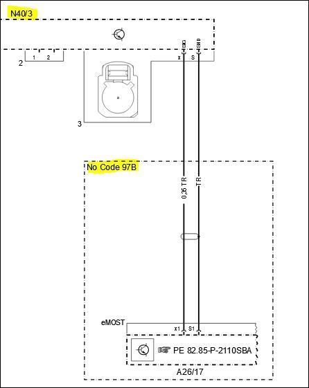

223 shown
N40/3 = 810 Premium sound system
N40/7 = 811 High end sound system
